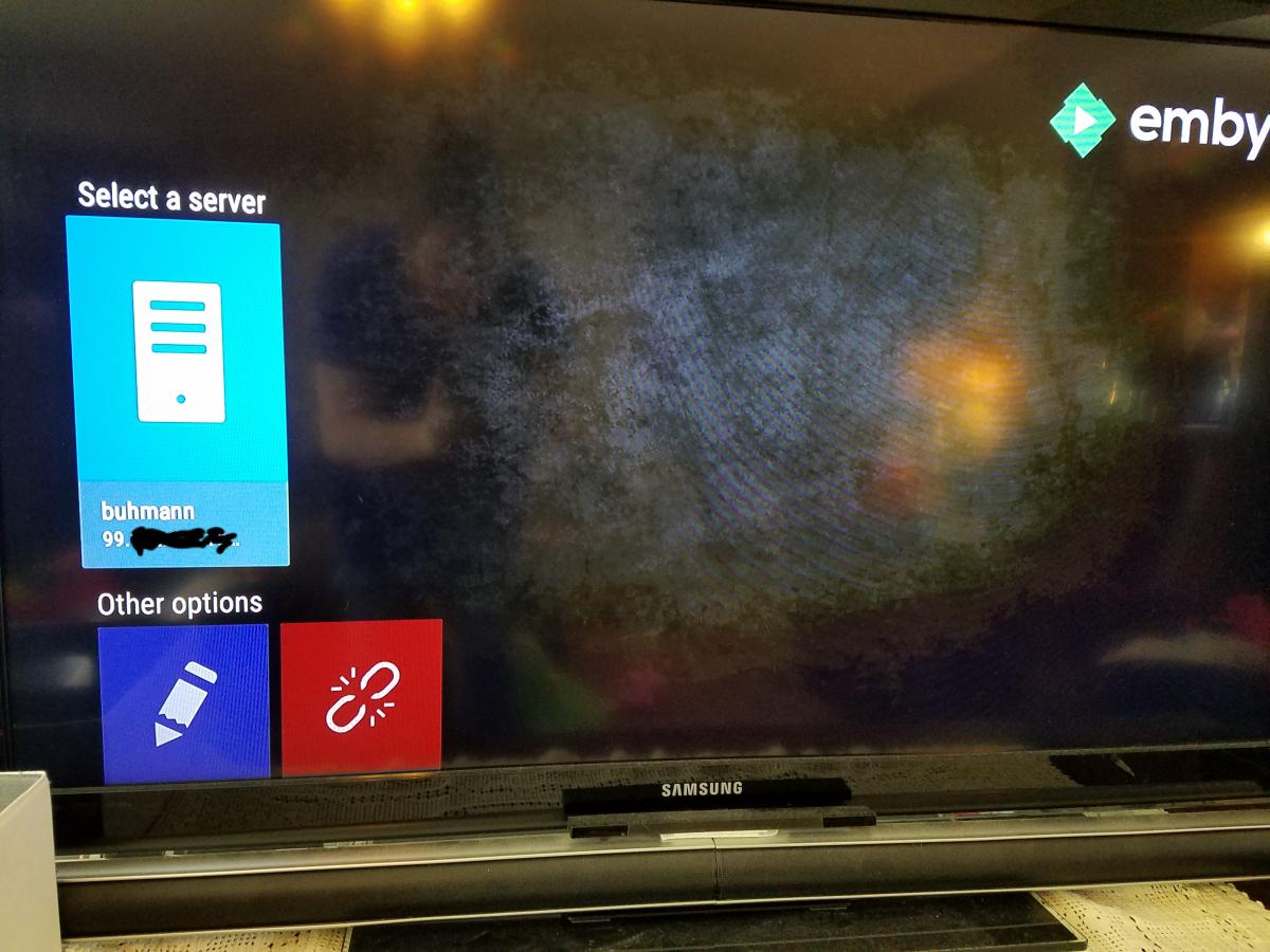

mckenzie78 1 Posted April 15, 2017 Author Posted April 15, 2017 (edited) Update: I just tried emby on the fire tv and it opened right up, but I'm getting a message about being in trial? I thought the trial was for when you are out of your network or am I misunderstanding? So, just after typing out the above I backed out of the movie and received a volley error and I can't get back in. This is on my fire tv. I have not yet made a successful connection on my Samsung s7. I feel like this is an operator error (me). lol. I'm attaching a picture of what the fire tv screen looks like. It is the same on my phone. Edited April 15, 2017 by mckenzie78

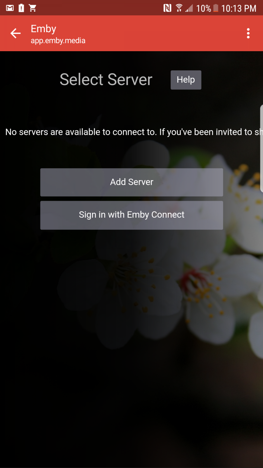

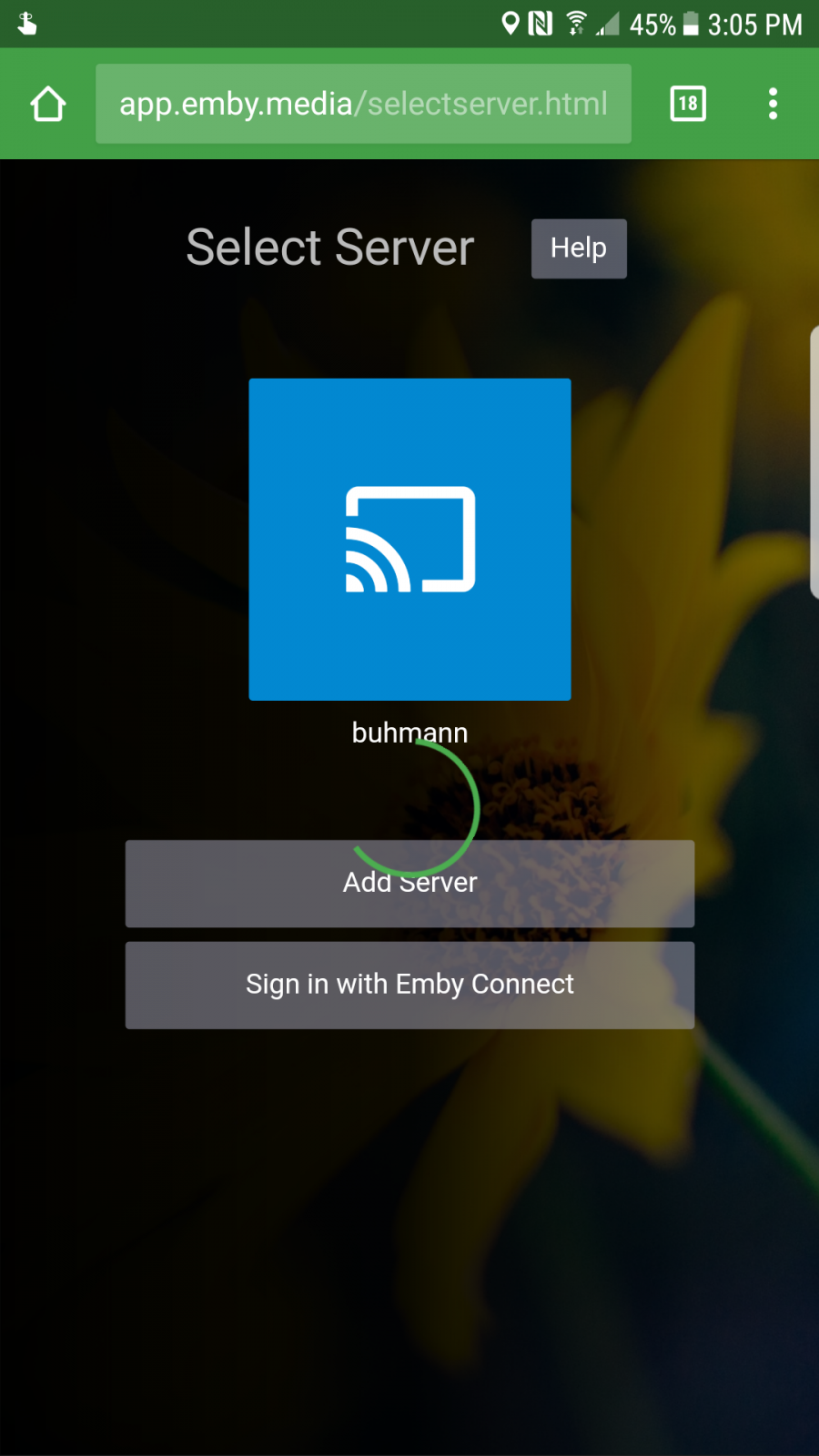

mckenzie78 1 Posted April 16, 2017 Author Posted April 16, 2017 (edited) Yes. That is what I used. I just tried again and this time it logs me in and says no servers are available to connect to which is odd because I'm looking at it on my pc right now. The picture with the blue square was taken when I first tried through the web app and the other is from just now. I did click forget server this afternoon on the fire tv and then restarted the server. The ss with the blue square was done before that. Edited April 16, 2017 by mckenzie78
Luke 42243 Posted April 17, 2017 Posted April 17, 2017 What if you enter your server address into the browser url bar, as mentioned in our Connectivity Troubleshooter. Bottom line is that looks like something is just blocking the traffic.
mckenzie78 1 Posted April 17, 2017 Author Posted April 17, 2017 (edited) Before I posted here I went through the entirety of the Connectivity Troubleshooter. I opened TCP Port 8096 on both my Windows firewall and AT&T Arris NVG589 router and even the other one listed on my dashboard, 8920. I ran an antivirus (Windows Defender) scan and malware (Malware Bytes) scan and they came up clean. The address for LAN and WAN are the same on my dashboard and when I type those in to any browser (other than the pc emby server is located on), it takes to long to load. Canyouseeme.org can see both ports. The odd thing to me is that I've noticed after the last two days that sometimes Emby works on fire tv, but then has a volley.android error when I back out of whatever I'm watching. After that I get server unavailable. I've never made a connection while on wifi with my phone. Only while using data. I am also having the same issue with Plex, but I want to move to Emby because of the live tv viewing. Because I'm having the same trouble with Plex, I know it has to be on my end. I'm just not that technologically inclined to be able to figure it out. Thank you for taking the time to try to help me. I appreciate it very much. Edited April 17, 2017 by mckenzie78
