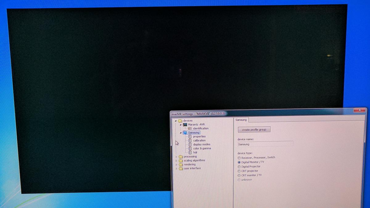

DrJekle 4 Posted April 14, 2017 Author Posted April 14, 2017 So I took some pictures of this occuring and something I have never seen before during playback is the xvsubfilter icon. Particular I have noticed this on mpeg2 playback (we have a lot of recordings for my toddler). madVR is not switching my display on me. I have never messed with the xy or lav filters/options before so odd that all of a sudden it has sprung up.
Guest asrequested Posted April 15, 2017 Posted April 15, 2017 Ah! Then it might be an issue with the subtitles. Try disabling subs in the ET general settings and see what happens.

DrJekle 4 Posted April 15, 2017 Author Posted April 15, 2017 Still no luck. I deleted the madVR folder than extracted directly in. I made sure edge filters were set and still no video image. I did take a picture of the xysubfilter that pops up and the menu options that are there. Is this normal that it should be showing up?
