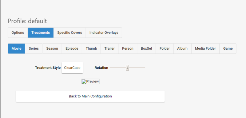

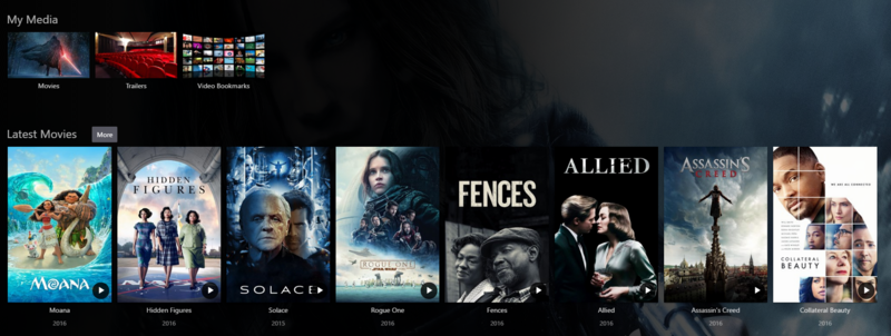

Chipsta040365 4 Posted April 14, 2017 Author Posted April 14, 2017 (edited) Homescreen Images look Fine, no overlay(dvd cover, bluray, etc) CoverArt Settings Screen in the settings, it is not recognizing the images for the overlay (broken image icon) Edited April 14, 2017 by Chipsta040365
Luke 42200 Posted April 14, 2017 Posted April 14, 2017 In that config screen, what overlay are you expecting to be there?
Chipsta040365 4 Posted April 14, 2017 Author Posted April 14, 2017 all overlays that come with the plugin are missing dvd case cd case etc
