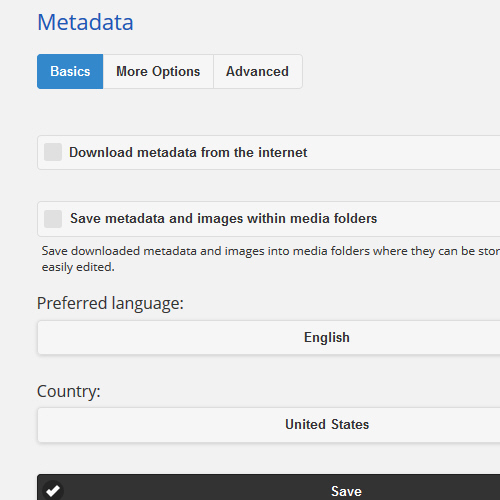

PBzeer 6 Posted February 10, 2014 Author Posted February 10, 2014 Well, it certainly happened to me. Here's the steps I took ... Download and install server. Configured everything except the media folders, before adding media.(Especially being sure to disable internet providers, which I knew from MB2) After letting the server scan all my media, I then downloaded and installed MBC. Configured MBC, then opened. Despite <SortTitle> in my XML file for each movie (which worked fine in MB2), the movies did not display in the order of my sort tags. Went to the metadata editor in the library and manually assigned sort titles. (At this point, I have to admit I didn't scroll down far enough to see the metadata option at the bottom.) Movies still out of order, so back to the editor, and see my new titles gone. Looked deeper, which was when I saw metadata option at the bottom of the page. Disabled internet providers in Movies and now a lock icon apppears and my titles stay as I changed and saved them. This is my metadata page before I added any media:

Luke 42289 Posted February 11, 2014 Posted February 11, 2014 The option on the page is an override of the default setting. So changing the global setting will produce the same result.

Luke 42289 Posted February 14, 2014 Posted February 14, 2014 i wouldn't worry about the library explorer and just go by what you see in the web client. individual item settings override the global server settings in the metadata section.
