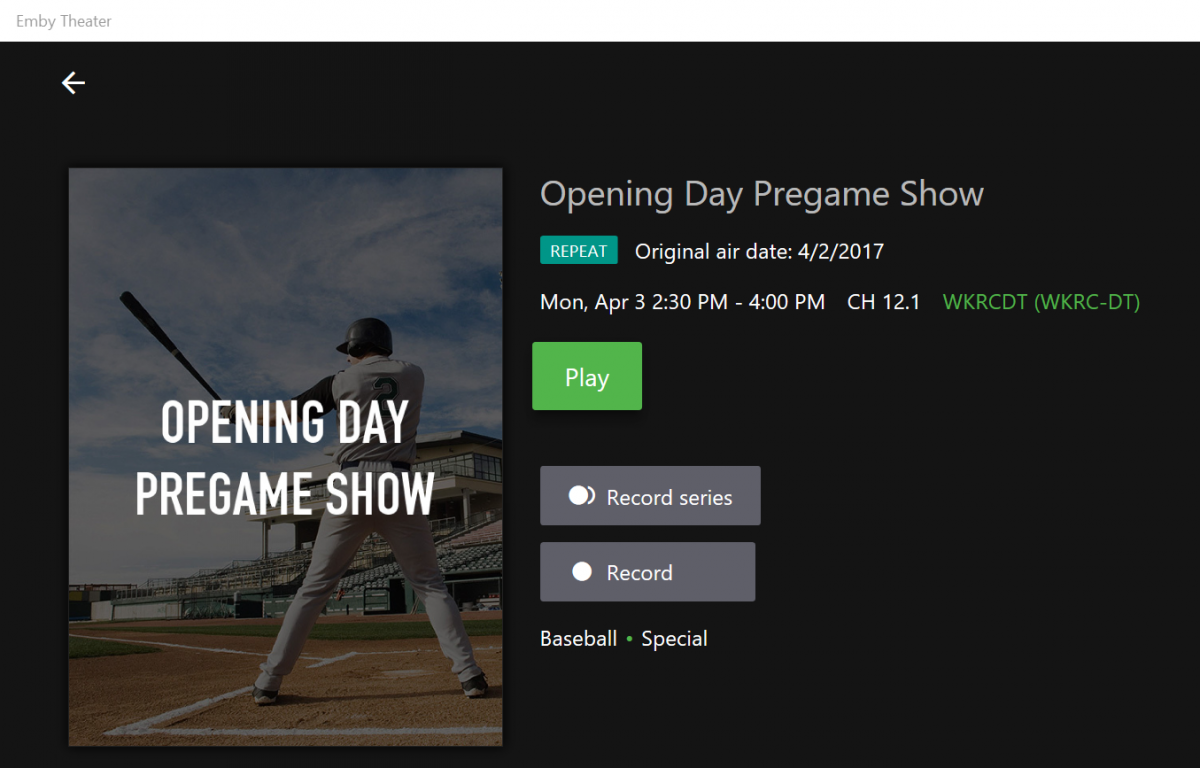

When I play a channel (I only watch HD channels) via Emby Live TV after 45-60 minutes the channels drop and Emby returns to the play screen for that channel - see attached screenshot. I even notice that the HD channels I watch are not so clear even though my Signal Strength and Signal Quality are both in the green. As a result, even when I record a TV show from one of my HD channels, I notice the playback of the recordings are fuzzy - which I guess isn't surprising if the original HD channel I'm watching is fuzzy.
