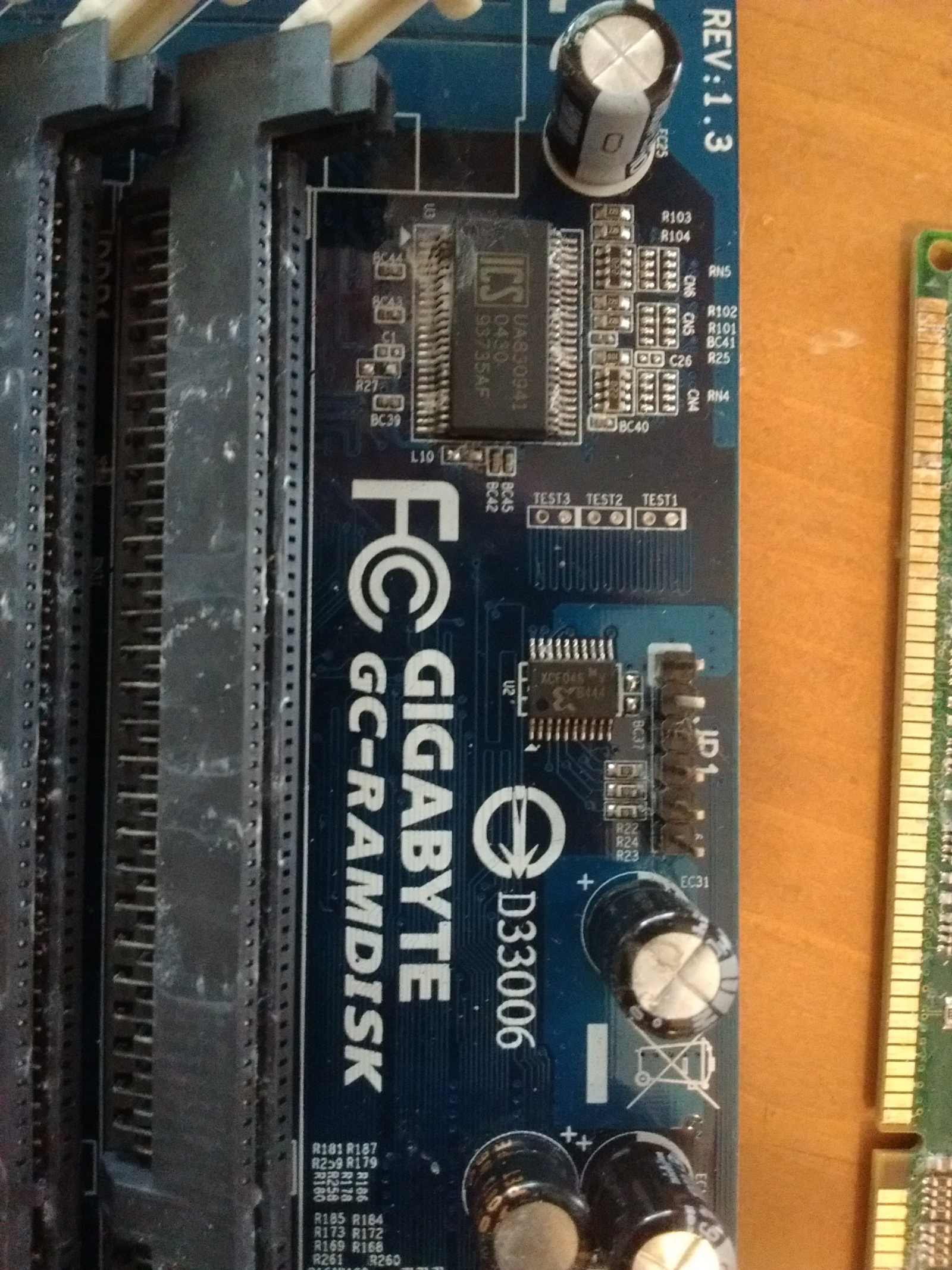

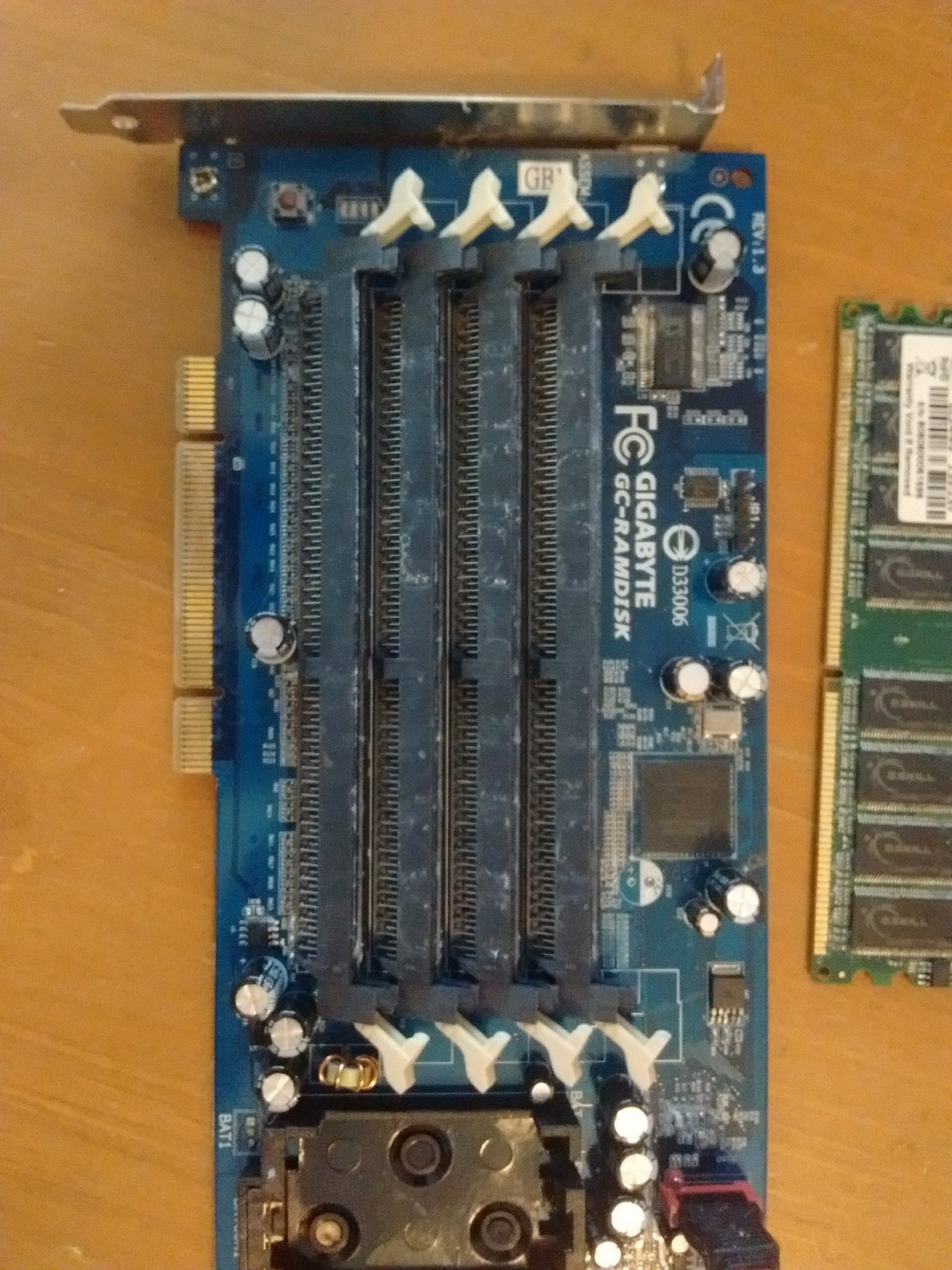

earthtorob 5 Posted April 2, 2017 Posted April 2, 2017 Emby uses cache drives for different things. I was thinking about dusting off my 2 iRam drives for Embys cache. But I don't know if it's worth the trouble, Will I get much speed advantage? The drives have 150Mb/s throughput with practically zero latency. Its great for when a system needs to swap around a lot of small temp files. Would pointing Emby's cache at them speed Emby up for me?

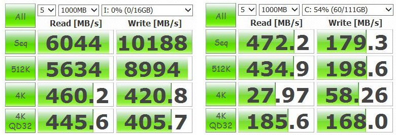

pir8radio 1313 Posted April 3, 2017 Posted April 3, 2017 (edited) Thats what I'm thinking this is all about. Specify a custom location for server cache files, such as images. Leave blank to use the server default. That is correct. Also what I do... run a ramdisk. Works well as long as your ramdisk supports saving data at shut down, otherwise you have to rebuild all of that info after a reboot. I have a 10 gig ramdisk, and have only ever seen 2 gigs of "stuff" on it. I have 500 or so movies, 13,000 music videos, and 140,000 mp3's. So you can probably get away with a smaller ram disk. EDIT, i just googled what you were talking about, looks like a piece of hardware (PCI?) my ram disks use actual system ram http://memory.dataram.com/products-and-services/software/ramdisk Using ramdisk software you can get some pretty good ramdisk speeds even when put up against decent SSD's (below). Edited April 3, 2017 by pir8radio

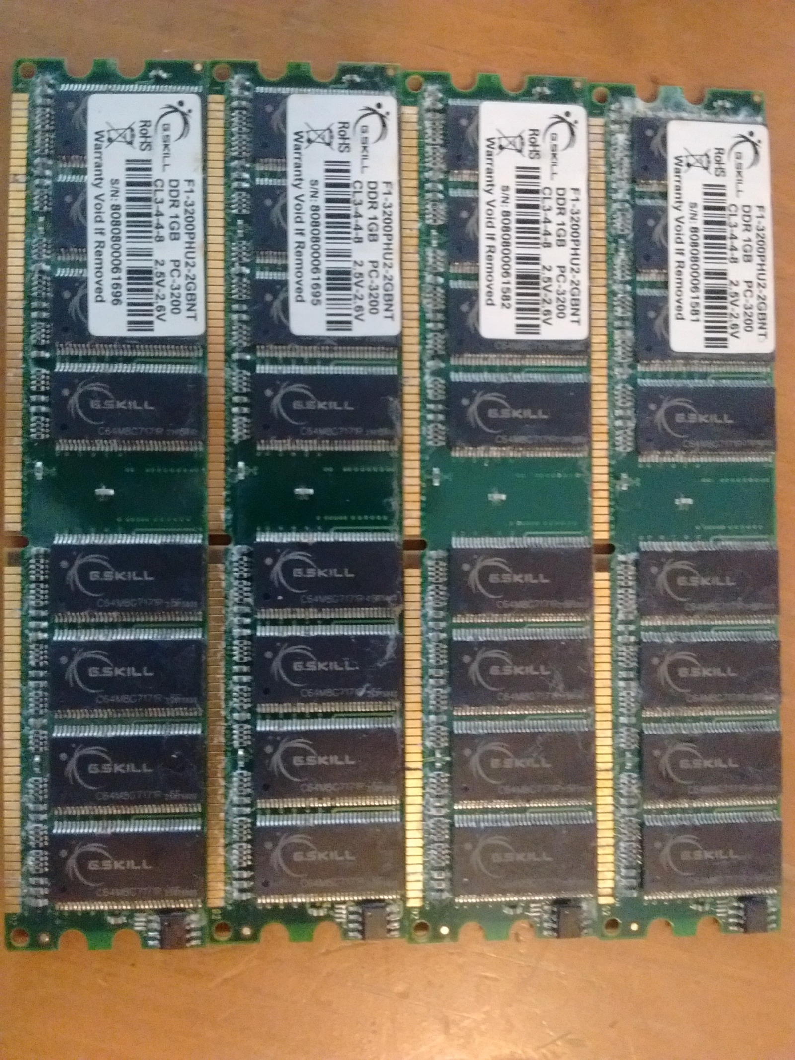

earthtorob 5 Posted April 3, 2017 Author Posted April 3, 2017 That is correct. Also what I do... run a ramdisk. Works well as long as your ramdisk supports saving data at shut down, otherwise you have to rebuild all of that info after a reboot. I have a 10 gig ramdisk, and have only ever seen 2 gigs of "stuff" on it. I have 500 or so movies, 13,000 music videos, and 140,000 mp3's. So you can probably get away with a smaller ram disk. EDIT, i just googled what you were talking about, looks like a piece of hardware (PCI?) my ram disks use actual system ram http://memory.dataram.com/products-and-services/software/ramdisk Using ramdisk software you can get some pretty good ramdisk speeds even when put up against decent SSD's (below). Oh yeah, a ram disk would work great.....but....I have 2 gig of ram on my system. And I'm not interested in building a new one. You are correct that the iRam plugs into the PCI bus. But it doesn't transmit data through that bus. It uses SATA. So I get 150MB/s through each. And it uses DDR. So unlike SSD I don't have to worry about all those writes and Trim support. Or maybe just buy a cheap SSD and just use it for cache until it starts to slow down and then replace it. Either way, if that will get my page loads up faster then I'll go that route. Thanks for the info.

earthtorob 5 Posted April 7, 2017 Author Posted April 7, 2017 For those who might have had a passing interest, my iRam is dead. At least I assume so. I dare not plug the thing in. Corrosion has had it's way with my beloved old hardware. I guess I'll pick up a cheap SSD and use that. Although I still think the low latency of my iRam would have worked great.
