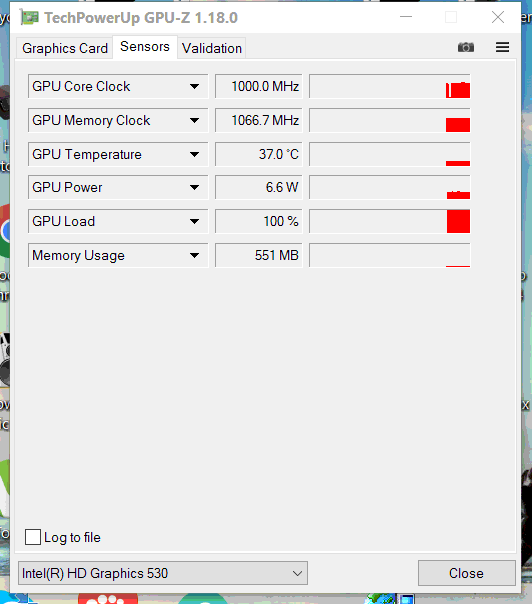

Guest asrequested Posted April 4, 2017 Posted April 4, 2017 (edited) Out of curiosity, I wanted to see what the GPU HW acceleration usage would be when playing that file using LAV with Windows Media Player, using these settings Here is the result. Notice a similar amount of memory and bandwidth to kodi are used. Although, in this case, HW acceleration appears to bite off chunks, rather than a continuous stream. I wanted to rule out that the issue was with LAV. I also tested using DXVA2copyback. The result was the same. So somehow we need to get Theater to utilize all of the available HW acceleration. I think then this issue will be mostly, if not fully resolved. UPDATE: I was playing it with a small window. Increasing the window size causes a steady HW decoding stream 1050MHz, instead of the intermediate decode seen in the GIF. Edited April 4, 2017 by Doofus
Guest asrequested Posted April 4, 2017 Posted April 4, 2017 (edited) Problem solved (I think). I added HEVC to hardware codecs <HwaEnabledCodecs> <string>H264</string> <string>VC1</string> <string>MPEG2</string> <string>HEVC</string> </HwaEnabledCodecs> And now look at the result Edited April 4, 2017 by Doofus

pir8radio 1313 Posted April 5, 2017 Author Posted April 5, 2017 (edited) Problem solved (I think). I added HEVC to hardware codecs <HwaEnabledCodecs> <string>H264</string> <string>VC1</string> <string>MPEG2</string> <string>HEVC</string> </HwaEnabledCodecs> what xml are these settings in? My ET Config has no HwaEnabledCodecs section. EDIT: nvrm found it. Edited April 5, 2017 by pir8radio
pir8radio 1313 Posted April 5, 2017 Author Posted April 5, 2017 no improvement for me... But my issue might be CPU....
