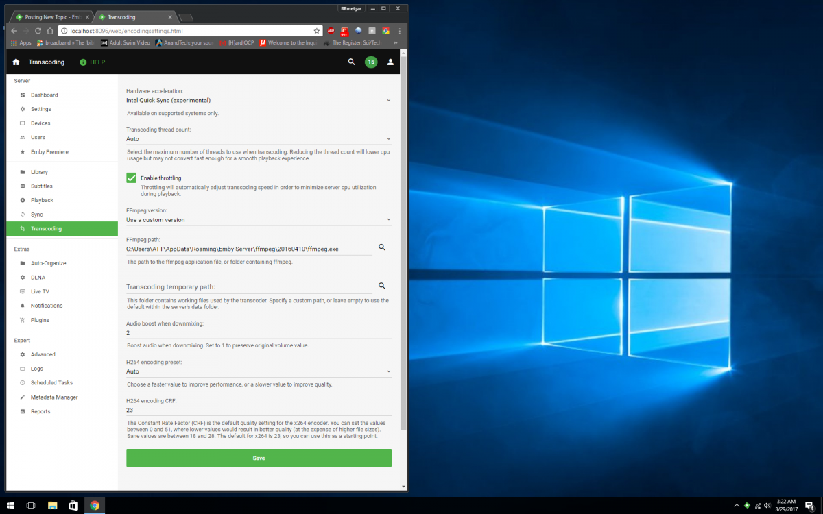

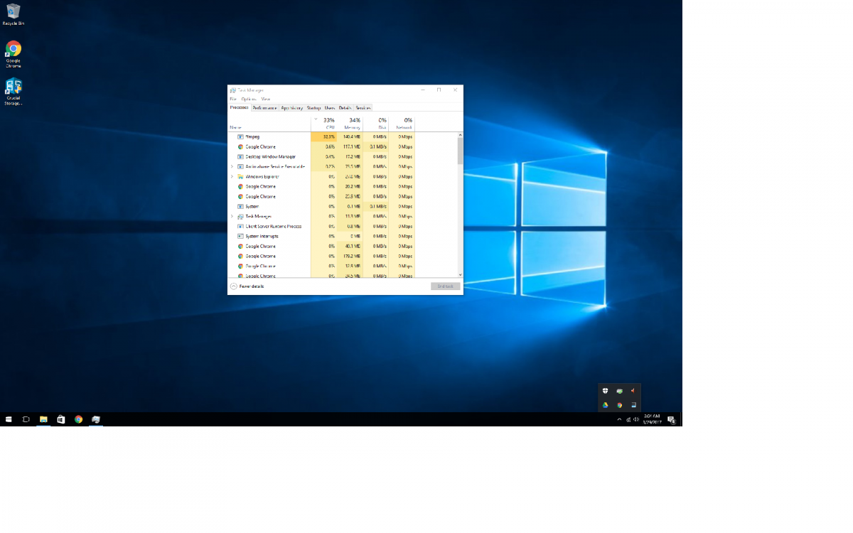

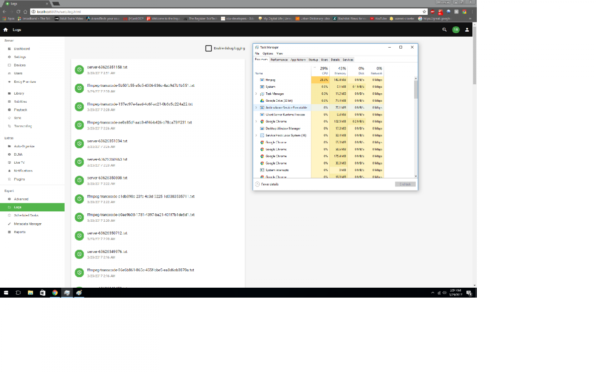

rrmelgar 0 Posted March 29, 2017 Posted March 29, 2017 (edited) Hi my PC I5 6600k with nvidia 770gtx ( pci express) set as primary i have enabled intel gpu in bios and giving it 128mb of ram.... I have also install latest intel drivers and I"m able to see both cards on the device manager. but i can't get quicksync to work at all i turn it on under trans-coding tab however everything works well with ffmpeg software mode I start a channel and wait wait nothing happens this on same PC/server emby running in software mode takes 3-4 seconds to display video I closed the browser and ffmpeg still running 30% cpu usage this are the settings hopefully someone can tell me what i'm doing wrong thx with dvi cable connected to onboard video card don't see ffmpeg but emby and chrome cpu usage jump to 10%+ compared to 1.6% under software mode here the log as well http://localhost:8096/emby/videos/6653d9559b3c9c6a83d1e808ce13e8c7/live.m3u8?DeviceId=958100b9943cf7f5889234e34784012ebffe5781&MediaSourceId=4495a619a3e546a0ab5bedc3ce11ee85_native_29bcd7cee0229f127adf68fad5e0033b&VideoCodec=h264&AudioCodec=aac,mp3&AudioStreamIndex=1&VideoBitrate=1066282666&AudioBitrate=384000&Level=51&Profile=high&PlaySessionId=1bb5e924d9ff4718812071b6cd4433f0&api_key=7478362ac81046d5aae138592eb73da2&LiveStreamId=a17c75760a04e99b68cf766e11316e1c_09efa0d56b934a82adec00a87b837fb0_4495a619a3e546a0ab5bedc3ce11ee85_native_29bcd7cee0229f127adf68fad5e0033b&CopyTimestamps=false&TranscodingMaxAudioChannels=6&EnableSubtitlesInManifest=false&RequireAvc=true {"Protocol":"Http","Id":"4495a619a3e546a0ab5bedc3ce11ee85_native_29bcd7cee0229f127adf68fad5e0033b","Path":"http://127.0.0.1:8096/LiveTv/LiveStreamFiles/d7cbf0bd17ff4b71b9507b61424771c5/stream.ts","Type":"Default","Container":"mpegts","IsRemote":false,"ReadAtNativeFramerate":false,"SupportsTranscoding":true,"SupportsDirectStream":true,"SupportsDirectPlay":false,"IsInfiniteStream":true,"RequiresOpening":true,"RequiresClosing":true,"SupportsProbing":true,"LiveStreamId":"a17c75760a04e99b68cf766e11316e1c_09efa0d56b934a82adec00a87b837fb0_4495a619a3e546a0ab5bedc3ce11ee85_native_29bcd7cee0229f127adf68fad5e0033b","BufferMs":0,"MediaStreams":[{"Codec":"mpeg2video","TimeBase":"1/90000","CodecTimeBase":"1001/60000","IsInterlaced":true,"BitRate":8000000,"RefFrames":1,"IsDefault":false,"IsForced":false,"Height":1080,"Width":1920,"AverageFrameRate":29.97003,"RealFrameRate":29.97003,"Profile":"Main","Type":"Video","AspectRatio":"16:9","Index":0,"IsExternal":false,"IsTextSubtitleStream":false,"SupportsExternalStream":false,"PixelFormat":"yuv420p","Level":4,"IsAnamorphic":false},{"Codec":"ac3","Language":"eng","TimeBase":"1/90000","CodecTimeBase":"1/48000","DisplayTitle":"Eng Dolby Digital 5.1","IsInterlaced":false,"ChannelLayout":"5.1","BitRate":448000,"Channels":6,"SampleRate":48000,"IsDefault":false,"IsForced":false,"Type":"Audio","Index":1,"IsExternal":false,"IsTextSubtitleStream":false,"SupportsExternalStream":false,"Level":0},{"Codec":"ac3","Language":"spa","TimeBase":"1/90000","CodecTimeBase":"1/48000","DisplayTitle":"Spa Dolby Digital stereo","IsInterlaced":false,"ChannelLayout":"stereo","BitRate":192000,"Channels":2,"SampleRate":48000,"IsDefault":false,"IsForced":false,"Type":"Audio","Index":2,"IsExternal":false,"IsTextSubtitleStream":false,"SupportsExternalStream":false,"Level":0},{"Codec":"ac3","Language":"por","TimeBase":"1/90000","CodecTimeBase":"1/48000","DisplayTitle":"Por Dolby Digital stereo","IsInterlaced":false,"ChannelLayout":"stereo","BitRate":192000,"Channels":2,"SampleRate":48000,"IsDefault":false,"IsForced":false,"Type":"Audio","Index":4,"IsExternal":false,"IsTextSubtitleStream":false,"SupportsExternalStream":false,"Level":0}],"PlayableStreamFileNames":[],"Formats":[],"Bitrate":8832000,"RequiredHttpHeaders":{},"AnalyzeDurationMs":2000,"DefaultAudioStreamIndex":1} C:\Users\ATT\AppData\Roaming\Emby-Server\ffmpeg\20160410\ffmpeg.exe -analyzeduration 2000000 -c:v mpeg2_qsv -i "http://127.0.0.1:8096/LiveTv/LiveStreamFiles/d7cbf0bd17ff4b71b9507b61424771c5/stream.ts" -map_metadata -1 -map_chapters -1 -threads 0 -map 0:0 -map 0:1 -map -0:s -codec:v:0 h264_qsv -preset 7 -look_ahead 0 -b:v 8000000 -maxrate 8000000 -bufsize 16000000 -vsync -1 -profile:v high -level 4.1 -force_key_frames "expr:gte(t,n_forced*3)" -vf "yadif=0:-1:0" -flags -global_header -max_delay 5000000 -avoid_negative_ts disabled -start_at_zero -codec:a:0 aac -strict experimental -ac 6 -ab 384000 -af "adelay=1,aresample=async=1" -hls_time 3 -individual_header_trailer 0 -start_number 0 -hls_list_size 0 -hls_base_url "hls/ee4c1cf5564679e3d242be9052c856b1/" -y "C:\Users\ATT\AppData\Roaming\Emby-Server\transcoding-temp\ee4c1cf5564679e3d242be9052c856b1.m3u8" ffmpeg version N-79277-g0c90b2e Copyright (c) 2000-2016 the FFmpeg developers built with gcc 5.3.0 (GCC) configuration: --enable-gpl --enable-version3 --disable-w32threads --enable-avisynth --enable-bzlib --enable-fontconfig --enable-frei0r --enable-gnutls --enable-iconv --enable-libass --enable-libbluray --enable-libbs2b --enable-libcaca --enable-libfreetype --enable-libgme --enable-libgsm --enable-libilbc --enable-libmodplug --enable-libmfx --enable-libmp3lame --enable-libopencore-amrnb --enable-libopencore-amrwb --enable-libopenjpeg --enable-libopus --enable-librtmp --enable-libschroedinger --enable-libsnappy --enable-libsoxr --enable-libspeex --enable-libtheora --enable-libtwolame --enable-libvidstab --enable-libvo-amrwbenc --enable-libvorbis --enable-libvpx --enable-libwavpack --enable-libwebp --enable-libx264 --enable-libx265 --enable-libxavs --enable-libxvid --enable-libzimg --enable-lzma --enable-decklink --enable-zlib libavutil 55. 20.100 / 55. 20.100 libavcodec 57. 34.100 / 57. 34.100 libavformat 57. 32.100 / 57. 32.100 libavdevice 57. 0.101 / 57. 0.101 libavfilter 6. 41.100 / 6. 41.100 libswscale 4. 1.100 / 4. 1.100 libswresample 2. 0.101 / 2. 0.101 libpostproc 54. 0.100 / 54. 0.100 [mpegts @ 00000000024f3140] Could not find codec parameters for stream 3 (Unknown: none ([134][0][0][0] / 0x0086)): unknown codec Consider increasing the value for the 'analyzeduration' and 'probesize' options Input #0, mpegts, from 'http://127.0.0.1:8096/LiveTv/LiveStreamFiles/d7cbf0bd17ff4b71b9507b61424771c5/stream.ts': Duration: N/A, start: 23108.599733, bitrate: N/A Program 766 Stream #0:0[0x1ded]: Video: mpeg2video ([2][0][0][0] / 0x0002), nv12, 1920x1080, max. 64000 kb/s, 29.97 fps, 29.97 tbr, 90k tbn, 59.94 tbc Stream #0:1[0x1dee](eng): Audio: ac3 ([129][0][0][0] / 0x0081), 48000 Hz, 5.1(side), fltp, 448 kb/s Stream #0:2[0x1def](spa): Audio: ac3 ([129][0][0][0] / 0x0081), 48000 Hz, stereo, fltp, 192 kb/s Stream #0:3[0x1df0]: Unknown: none ([134][0][0][0] / 0x0086) Stream #0:4[0x1df1](por): Audio: ac3 ([129][0][0][0] / 0x0081), 48000 Hz, stereo, fltp, 192 kb/s (visual impaired) Output #0, hls, to 'C:\Users\ATT\AppData\Roaming\Emby-Server\transcoding-temp\ee4c1cf5564679e3d242be9052c856b1.m3u8': Metadata: encoder : Lavf57.32.100 Stream #0:0: Video: h264 (h264_qsv), nv12, 1920x1080, q=2-31, 8000 kb/s, 29.97 fps, 90k tbn, 29.97 tbc Metadata: encoder : Lavc57.34.100 h264_qsv Side data: cpb: bitrate max/min/avg: 8000000/0/8000000 buffer size: 16000000 vbv_delay: -1 Stream #0:1: Audio: aac (LC), 48000 Hz, 5.1, fltp, 384 kb/s Metadata: encoder : Lavc57.34.100 aac Stream mapping: Stream #0:0 -> #0:0 (mpeg2video (mpeg2_qsv) -> h264 (h264_qsv)) Stream #0:1 -> #0:1 (ac3 (native) -> aac (native)) Press [q] to stop, [?] for help [ac3 @ 0000000002ccaac0] frame sync error Error while decoding stream #0:1: Invalid data found when processing input Edited March 29, 2017 by rrmelgar

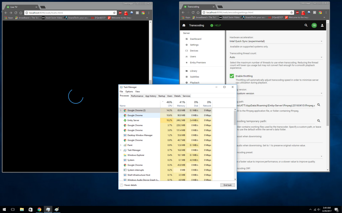

rrmelgar 0 Posted March 30, 2017 Author Posted March 30, 2017 (edited) I just dropped ffmpeg "ffmpeg-20170327-d65b595-win64-static" from https://ffmpeg.zeranoe.com/builds/ effectely replacing the ones on my C:\Users\ATT\AppData\Roaming\Emby-Server\ffmpeg\20160410 folder ffmepg and ffprobe still get all black screem with quicksync enable I don't see ffmpeg come up on task manager at all also tried with NVenc same results is there a special version i though this will be as easy as enabling the option on menu I can navigate through menus and channels but ones I load a channel loading screen animation just spins and spins with software mode everything works fine with the new ffmpeg Log new ffmpeg.txt Edited March 30, 2017 by rrmelgar
