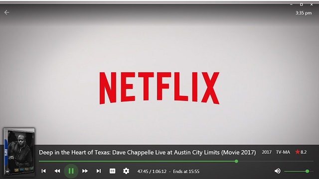

mentasm 43 Posted March 28, 2017 Author Posted March 28, 2017 Here goes: Just resumed this mkv after a server and ET restart. AS you can see the progress bar shows about 75% done, but the video is starting from the begining, hence the netflix splashscreen I don't believe I am running any customizations. Attached are the server logs and ET logs If I run the LAV .069 installer with defaults and restart ET the same file resumes correctly. server-63626312065.txt theater-63626312155.txt
mentasm 43 Posted March 28, 2017 Author Posted March 28, 2017 (edited) Rebooting directly after the above and allowing emby server and ET to auto start as they do and the same file when resumed has returned to the behaviour of playing from the beginning of the file again. For the sake of testing I tried deleting the COmObjects folder and restarting ET. This also temporarily fixes the issue but again the problem returns after a reboot of the media centre Edited March 28, 2017 by mentasm

Solution Luke 42243 Posted March 28, 2017 Solution Posted March 28, 2017 Would you mind please trying a complete uninstall and reinstall of the app? It will ensure you have the latest components. Thanks. 1

mentasm 43 Posted March 29, 2017 Author Posted March 29, 2017 Uninstalled. rebooted. installed from latest setup.exe on emby.media. Tested and video resumed OK Rebooted PC. Tested again. Working OK. Will monitor and see how I go 1
