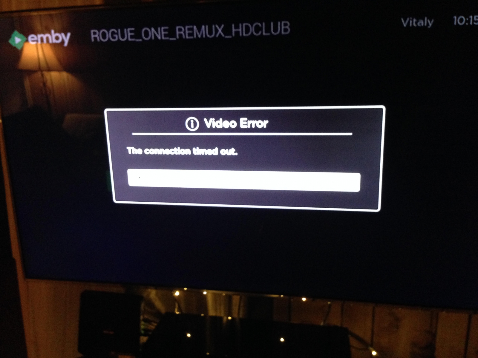

Boomsun 0 Posted March 28, 2017 Author Posted March 28, 2017 this is what I am actually have now on my screen... I dropped my bit-rating streaming a little bit lower (I mean video quality), but still have the same problem.

ebr 16335 Posted March 28, 2017 Posted March 28, 2017 Okay, as noted in the other forum and we now know that your issue is that you are trying to stream a BD folder rip which is only going to work some of the time. I would suggest looking at converting these to a more streaming-friendly format (mkv/mp4) and putting them in a supported folder structure to take advantage of all of Emby's features. Thanks!
Luke 42242 Posted March 28, 2017 Posted March 28, 2017 @@Boomsun, additionally, I notice this particular title has no media info. If you open the detail screen of the web app and use the 3-dot menu to refresh the title, you may have better luck playing it. Let us know how it goes. Thanks !
