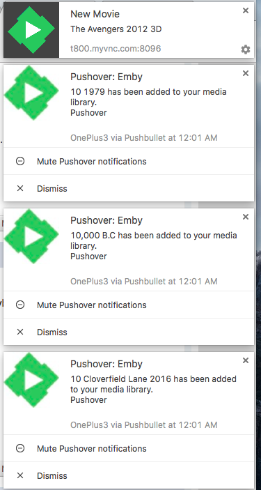

T800 10 Posted March 31, 2017 Author Posted March 31, 2017 The movies are definitely missing. Now I've got Pushover set up I'm getting a stream of notifications adding the movies back in that I've never noticed before.
