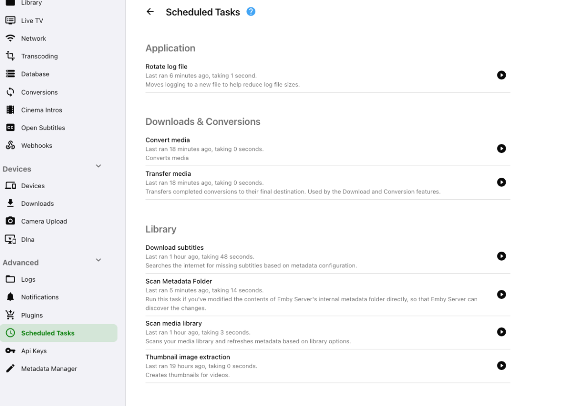

mvanIII 1 Posted January 21, 2023 Posted January 21, 2023 I found this old post via search as I'm having the same trouble described by @megaembyusers. I'm running emby Version 4.7.10.0 as a Docker container. I play media from a web browser and also Roku. The contents of my `transcoding-temp` directory: drwxr-xr-x 2 emby emby 4096 Jan 9 11:21 E9939D/ drwxr-xr-x 2 emby emby 4096 Jan 14 17:43 842EE1/ drwxr-xr-x 2 emby emby 4096 Jan 14 17:43 1FB37B/ drwxr-xr-x 2 emby emby 4096 Jan 14 17:43 12FDBB/ drwxr-xr-x 2 emby emby 4096 Jan 15 06:48 FD94DF/ drwxr-xr-x 2 emby emby 69632 Jan 20 20:37 F66113/ drwxr-xr-x 2 emby emby 73728 Jan 20 21:01 49986D/ drwxr-xr-x 2 emby emby 69632 Jan 20 21:12 1C46CE/ Today is Jan 21. Based on what's discussed above I would've expected the Jan 9, 14 and possiby Jan 15 to have been removed. Where is the task in emby? I don't see anything that applies to cleaning transcoding...
Luke 42245 Posted January 22, 2023 Posted January 22, 2023 22 hours ago, mvanIII said: I found this old post via search as I'm having the same trouble described by @megaembyusers. I'm running emby Version 4.7.10.0 as a Docker container. I play media from a web browser and also Roku. The contents of my `transcoding-temp` directory: drwxr-xr-x 2 emby emby 4096 Jan 9 11:21 E9939D/ drwxr-xr-x 2 emby emby 4096 Jan 14 17:43 842EE1/ drwxr-xr-x 2 emby emby 4096 Jan 14 17:43 1FB37B/ drwxr-xr-x 2 emby emby 4096 Jan 14 17:43 12FDBB/ drwxr-xr-x 2 emby emby 4096 Jan 15 06:48 FD94DF/ drwxr-xr-x 2 emby emby 69632 Jan 20 20:37 F66113/ drwxr-xr-x 2 emby emby 73728 Jan 20 21:01 49986D/ drwxr-xr-x 2 emby emby 69632 Jan 20 21:12 1C46CE/ Today is Jan 21. Based on what's discussed above I would've expected the Jan 9, 14 and possiby Jan 15 to have been removed. Where is the task in emby? I don't see anything that applies to cleaning transcoding... Hi, it happens automatically, so there is no task needed.
