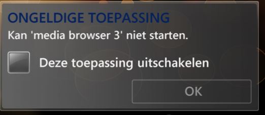

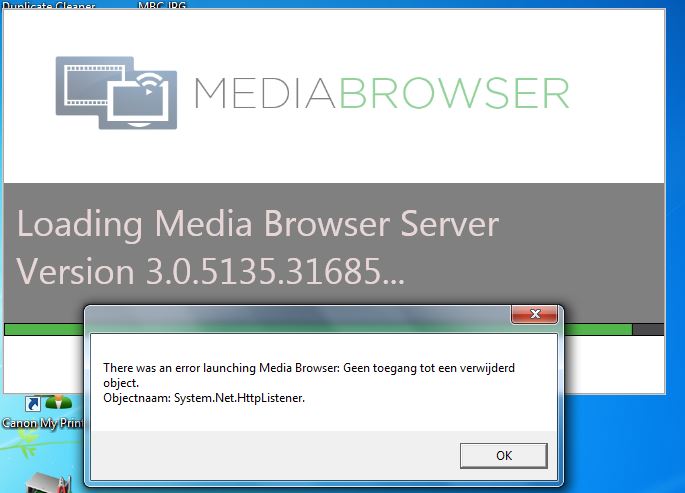

Bizzy 0 Posted February 8, 2014 Posted February 8, 2014 Hi, Before updating to the last update I had some problems that Mediabrowser classic froze. After restarting the problem was gone. But this happened repeatedly. So when I saw there was an update I hoped this would solve may problem but now it seems that I have problems with the server. I can not start Mediabrowser classic. So want to check if the server is running the way it should. So from the start up menu (Windows 7) I hit Mediabrowser server and while trying to start I get the error message: "There was an error launching Mediabrowser. No acces to a removed object. Objectname: system.Net.HttpListner" fter this I removed everything, rebooted and installed everything again but still same error message.... Please help. Best regards, Rob
Luke 42289 Posted February 8, 2014 Posted February 8, 2014 Can you give more information, such as log files and screenshots?
Bizzy 0 Posted February 9, 2014 Author Posted February 9, 2014 Hi, I am sorry that I forgot the details and the logfiles. Now I have added them. The screendumps are partially in Dutch, if needed I can translate this... Best regards, Rob MBClassic-9220142eb42efc03f144f496bedf3e304622ec.log server-63527539441.log unhandled_d0d892b4-2744-4a52-8ebb-9e9584d07a9d.txt
Sven 136 Posted February 9, 2014 Posted February 9, 2014 Not a problem. For me it's not a problem to understand dutch. Could you post the output for this command? Just start a Command Promt as Administrator netsh http show servicestate
Bizzy 0 Posted February 9, 2014 Author Posted February 9, 2014 Momentopname van de status van de HTTP-service (serversessieweergave):----------------------------------------------------------------------Serversessie-id: FF00000320000001 Versie: 1.0 Status: Active Eigenschappen: Maximale bandbreedte: 4294967295 Time-outs: Time-out voor gehele entiteit (sec.): 120 Time-out voor leegmaken van gehele entiteit (sec.): 120 Time-out voor aanvraagwachtrij (sec.): 120 Time-out voor inactieve verbinding (sec.): 120 Time-out voor wachten op header (sec.): 120 Minimale verzendsnelheid (bytes/sec.): 150 URL-groepen: URL-groeps-id: FE00000340000001 Status: Active Naam van aanvraagwachtrij: de aanvraagwachtrij heeft geen naam. Eigenschappen: Max. bandbreedte: overgenomen Max. aantal verbindingen: overgenomen Time-outs: Time-outwaarden zijn overgenomen Aantal geregistreerde URL's: 1 Geregistreerde URL's: HTTP://*:5357/C6CFA655-0600-4B0F-86D3-8C44EEFA609A/Serversessie-id: FA00000220000001 Versie: 1.0 Status: Active Eigenschappen: Maximale bandbreedte: 4294967295 Time-outs: Time-out voor gehele entiteit (sec.): 120 Time-out voor leegmaken van gehele entiteit (sec.): 120 Time-out voor aanvraagwachtrij (sec.): 120 Time-out voor inactieve verbinding (sec.): 120 Time-out voor wachten op header (sec.): 120 Minimale verzendsnelheid (bytes/sec.): 150 URL-groepen: URL-groeps-id: F900000240000001 Status: Active Naam van aanvraagwachtrij: de aanvraagwachtrij heeft geen naam. Eigenschappen: Max. bandbreedte: overgenomen Max. aantal verbindingen: overgenomen Time-outs: Time-outwaarden zijn overgenomen Aantal geregistreerde URL's: 1 Geregistreerde URL's: HTTP://*:2869/Serversessie-id: F800000220000001 Versie: 1.0 Status: Active Eigenschappen: Maximale bandbreedte: 4294967295 Time-outs: Time-out voor gehele entiteit (sec.): 120 Time-out voor leegmaken van gehele entiteit (sec.): 120 Time-out voor aanvraagwachtrij (sec.): 120 Time-out voor inactieve verbinding (sec.): 120 Time-out voor wachten op header (sec.): 120 Minimale verzendsnelheid (bytes/sec.): 150 URL-groepen: URL-groeps-id: F700000240000001 Status: Active Naam van aanvraagwachtrij: de aanvraagwachtrij heeft geen naam. Eigenschappen: Max. bandbreedte: overgenomen Max. aantal verbindingen: overgenomen Time-outs: Time-outwaarden zijn overgenomen Aantal geregistreerde URL's: 1 Geregistreerde URL's: HTTP://*:2869/UPNP/EVENTING/Serversessie-id: FF00000220000001 Versie: 2.0 Status: Active Eigenschappen: Maximale bandbreedte: 4294967295 Time-outs: Time-out voor gehele entiteit (sec.): 120 Time-out voor leegmaken van gehele entiteit (sec.): 120 Time-out voor aanvraagwachtrij (sec.): 120 Time-out voor inactieve verbinding (sec.): 120 Time-out voor wachten op header (sec.): 120 Minimale verzendsnelheid (bytes/sec.): 150 URL-groepen: URL-groeps-id: FE00000240000001 Status: Active Naam van aanvraagwachtrij: de aanvraagwachtrij heeft geen naam. Eigenschappen: Max. bandbreedte: overgenomen Max. aantal verbindingen: overgenomen Time-outs: Time-outwaarden zijn overgenomen Aantal geregistreerde URL's: 1 Geregistreerde URL's: HTTP://+:9080/Serversessie-id: FD00000220000001 Versie: 2.0 Status: Active Eigenschappen: Maximale bandbreedte: 4294967295 Time-outs: Time-out voor gehele entiteit (sec.): 120 Time-out voor leegmaken van gehele entiteit (sec.): 120 Time-out voor aanvraagwachtrij (sec.): 120 Time-out voor inactieve verbinding (sec.): 120 Time-out voor wachten op header (sec.): 120 Minimale verzendsnelheid (bytes/sec.): 150 URL-groepen: URL-groeps-id: FC00000240000001 Status: Active Naam van aanvraagwachtrij: de aanvraagwachtrij heeft geen naam. Eigenschappen: Max. bandbreedte: overgenomen Max. aantal verbindingen: overgenomen Configuratie van Edge Traversal: Blokkeren Time-outs: Time-outwaarden zijn overgenomen Aantal geregistreerde URL's: 1 Geregistreerde URL's: HTTP://+:10243/WMPNSSV4/2680725130/ URL-groeps-id: FB00000240000001 Status: Active Naam van aanvraagwachtrij: de aanvraagwachtrij heeft geen naam. Eigenschappen: Max. bandbreedte: overgenomen Max. aantal verbindingen: overgenomen Configuratie van Edge Traversal: Toestaan Time-outs: Time-outwaarden zijn overgenomenAanvraagwachtrijen: Naam van aanvraagwachtrij: de aanvraagwachtrij heeft geen naam. Versie: 1.0 Status: Active Uitbreidingsniveau van aanvraagwachtrij 503: Standaard Maximum aantal aanvragen: 1000 Aantal gekoppelde actieve processen: 1 Proces-id's: 284 Naam van aanvraagwachtrij: de aanvraagwachtrij heeft geen naam. Versie: 1.0 Status: Active Uitbreidingsniveau van aanvraagwachtrij 503: Standaard Maximum aantal aanvragen: 1000 Aantal gekoppelde actieve processen: 1 Proces-id's: 284 Naam van aanvraagwachtrij: de aanvraagwachtrij heeft geen naam. Versie: 2.0 Status: Active Uitbreidingsniveau van aanvraagwachtrij 503: Volledig Maximum aantal aanvragen: 1000 Aantal gekoppelde actieve processen: 1 Proces-id's: 4188 Naam van aanvraagwachtrij: de aanvraagwachtrij heeft geen naam. Versie: 2.0 Status: Active Uitbreidingsniveau van aanvraagwachtrij 503: Standaard Maximum aantal aanvragen: 1000 Aantal gekoppelde actieve processen: 1 Proces-id's: 1316 Naam van aanvraagwachtrij: de aanvraagwachtrij heeft geen naam. Versie: 1.0 Status: Active Uitbreidingsniveau van aanvraagwachtrij 503: Standaard Maximum aantal aanvragen: 1000 Aantal gekoppelde actieve processen: 1 Proces-id's: 284C:\Users\MediaCenter>
Sven 136 Posted February 9, 2014 Posted February 9, 2014 (edited) That's on the server where you host MediaBrowser? Please download this tool. http://technet.microsoft.com/en-us/sysinternals/bb897437 Then post the txt file ( File --> Save as ) Edited February 9, 2014 by Sven
Bizzy 0 Posted February 9, 2014 Author Posted February 9, 2014 Yes, I run Server and Mediabrowser classic on the same machine. What does this tool do? Oh you're a "Vlamink" we live next to the Belgium border close to Maasmechelen....
Bizzy 0 Posted February 9, 2014 Author Posted February 9, 2014 Here is the file, now I know what it does... rm.txt
Sven 136 Posted February 9, 2014 Posted February 9, 2014 Yes, I run Server and Mediabrowser classic on the same machine. What does this tool do? Oh you're a "Vlamink" we live next to the Belgium border close to Maasmechelen.... Yes, i am from the flemish part. Here is the file, now I know what it does... The first thing i thought when reading the fault was something on the same port. But that's not it! Something else in the eventviewer of windows?
Bizzy 0 Posted February 9, 2014 Author Posted February 9, 2014 Here is the event log..... hope you can find the cause of my problem rm1.txt
Sven 136 Posted February 9, 2014 Posted February 9, 2014 Do you use the theme Chocolate? Is it possible to remove it? Something that @@ebr posted in the old forum.. "Look in your Windows/ehome directory and delete any dlls in there that match the name of a MB theme. e.g. chocolate.dll, neo.dll. All except for crystal.dll because that is actually a MS item and our theme would not be there."
Bizzy 0 Posted February 9, 2014 Author Posted February 9, 2014 Looks like this helped. I reinstalled everything again just now. Need to setup de media library again... Let you know if everything is up and running again. Thanks!
