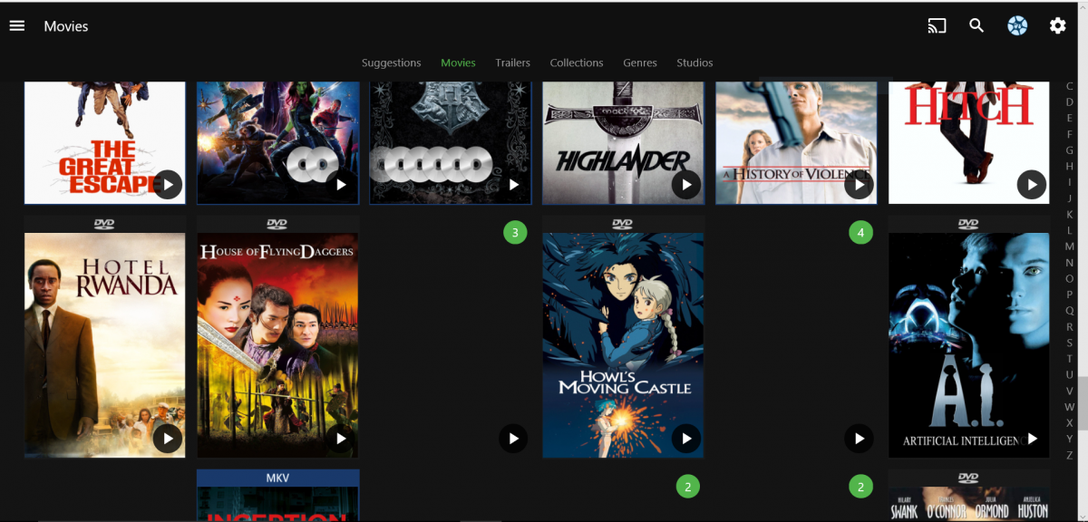

rubicon 16 Posted March 22, 2017 Posted March 22, 2017 Like @@ShoutingMan I haven't changed anything or manually downloaded a poster etc., just whatever was picked up when performing the scans for my library every time I add a new movie. Problem was only with collections and playlists. Maybe in the past with other folders too but in the last versions thats where the problem was focusing. I tried also to ignore collections from the CA unsuccessfully and to be fair it didn't worth the trouble doing that. Once more, after I deleted the plugin, so far scans, playbacks and everything else is working brilliantly. A bit faster than before actually so whatever the problem is, it's either within the plugin or the last windows update I have done (running windows 8) although its weird that this would affect only this.

ShoutingMan 101 Posted March 26, 2017 Author Posted March 26, 2017 Why do you think it's failing? In case I didn't answer your question: that Doctor Stranger poster art is one of the (many) posters that CoverArt isn't processing and that shows as empty / black in the apps.

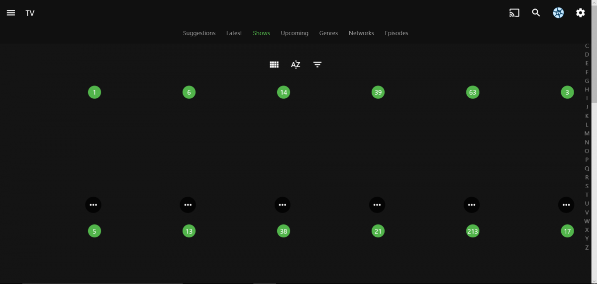

ShoutingMan 101 Posted April 2, 2017 Author Posted April 2, 2017 (edited) Sorry, yes, I really do need the debug logging. Enabled debugging and installed CA 26 beta. Also added new fresh screen caps of the Webview of Movie and TV Libearies showing the problem. Server Log for CA 26 Beta.txt (this one was taken after navigating back to the movies library to show how cover art basically stops at some point.) And here's the log with CA uninstalled Server Log for no CA 26 Beta.txt Edited April 2, 2017 by ShoutingMan
