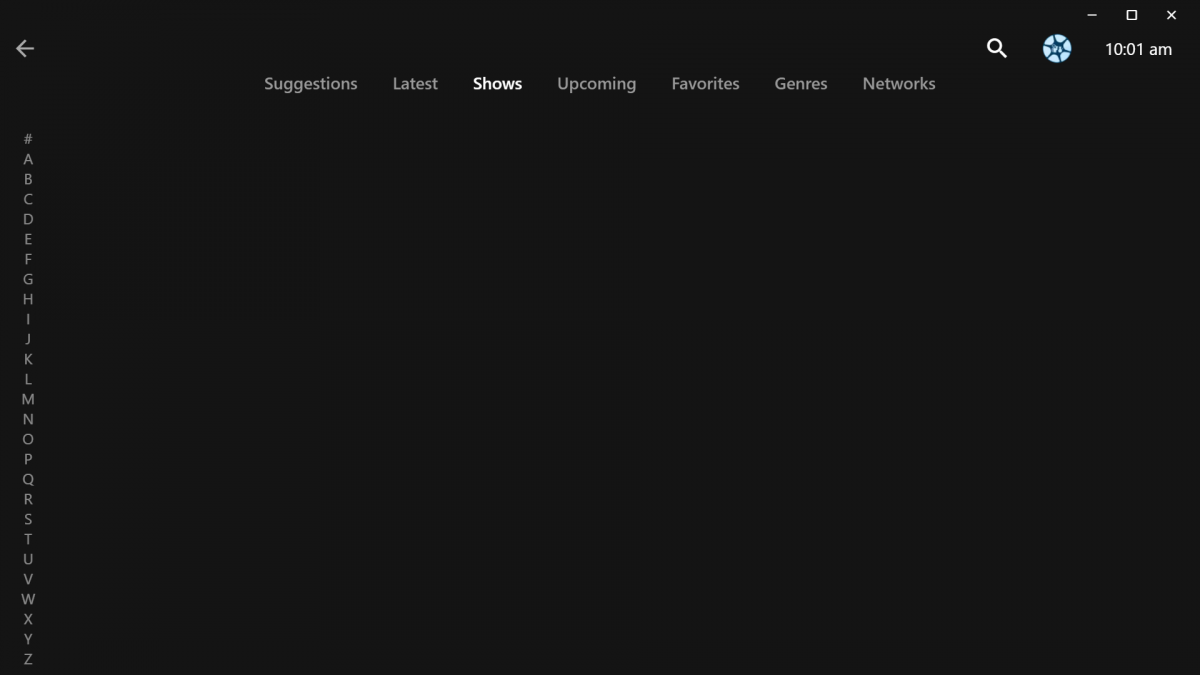

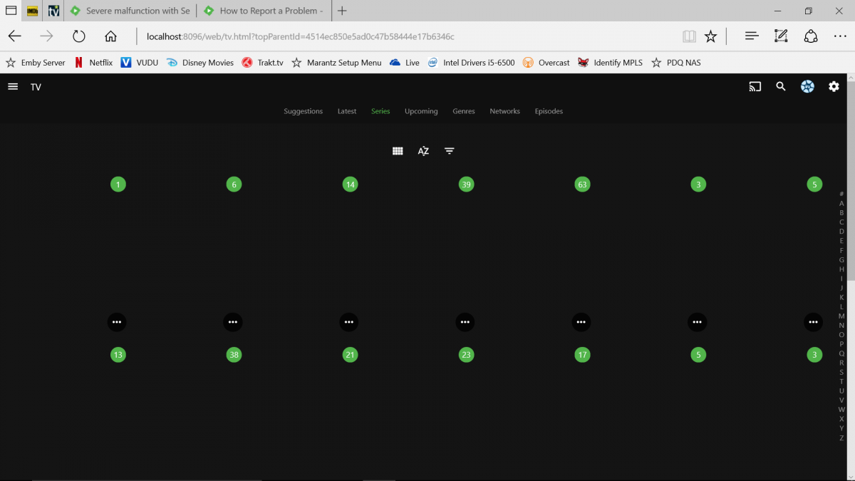

ShoutingMan 101 Posted March 19, 2017 Posted March 19, 2017 Suddenly tonight, Emby Server and Emby Theater (Windows 10) and Emby app (AppleTV) are not working. I'm at a loss. Emby won't show images for anything in the movie library past about the 20th entry. It won't show Collections or TV at all: not just blank images, but nothing. It's emtpy. This is for Server (web view), Theater (Windows 10), and Emby App (AppleTV). Theater (Win10) will play moviesthough movies play. Emby Theater won't show Collections or TV shows at all: the libraries show as empty. Emby App on Apple TV shows no images and can't play anything. Metadata Manager in Server webview won't load. At all. It was working, and now it's now. I've rebooted my PC and restarted the Server, with no change. I don't think I changed anything. I replaced four existing ISOs with MKVs in the library between when I saw things working normally and not working now. I have in the past week reinstalled Server and rebuilt all the metadata for the Theater app. All the metadata and images for the libray itself was in the library folders and shouldn't have been re-downloaded. I may try reinstalling Server (without deleting metadata). Otherwise, I'm at a loss.

ShoutingMan 101 Posted March 19, 2017 Author Posted March 19, 2017 I uninstalled / reinstalled Server. I got Collections back in webview, so no artwork. No TV at all in Theater. And Theater spontaneously locked up. Might be the CoverArt thing again ? Remove CoverArt or try a different treatment. If you haven't got CoverArt then I may just possibly be incorrect .... I run CoverArt plug-in. I'll try reinstalling that. Thanks for the tip.
ShoutingMan 101 Posted March 19, 2017 Author Posted March 19, 2017 CoverArt is broken. Uninstall CoverArt and everything is back to normal. Reinstall CoverArt and things are broken. Uninstall again and things are working again. I hope this will be fixed. I've gotten to where I rely on CoverArt to know what's ISO (DVD or Blu) and what's MKV.
