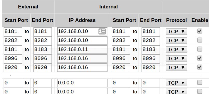

MontyJ 0 Posted March 2, 2017 Author Posted March 2, 2017 Did you forward the port properly? Just because 8096 is open to the world doesn't mean it goes anywhere. Well, I can't figure out how to do the inline image thing, so have attached a snapshot of the port forwarding screen in the Cisco router. The QNAP box IP address is "16" so it agrees with the setup. Don't know what else to check there. In another section, the router status also says "No Ports Restricted", for what it is worth. The site CanYouSeeMe.org shows both ports open, but like you say, that may not mean much I guess. Locally, the Linux util nmap shows the ports "open" on both boxes.
MontyJ 0 Posted March 2, 2017 Author Posted March 2, 2017 Did you forward the port properly? Just because 8096 is open to the world doesn't mean it goes anywhere. Update: Ok, MOD was able to see login screen so it appears to be working!...just not from where I am sitting, LoL. Gotta get up and move
mastrmind11 722 Posted March 2, 2017 Posted March 2, 2017 (edited) Update: Ok, MOD was able to see login screen so it appears to be working!...just not from where I am sitting, LoL. Gotta get up and move FYI if you're trying to access your external address internally, it won't work unless you tweak your router settings. I can't either, don't have time to figure it out, and don't have a use case where I'd ever need to. However once I shut off my wifi on my device and I use 4G, I'm right in... Might be your case too. Sent from my SM-G935T using Tapatalk Edited March 2, 2017 by mastrmind11
