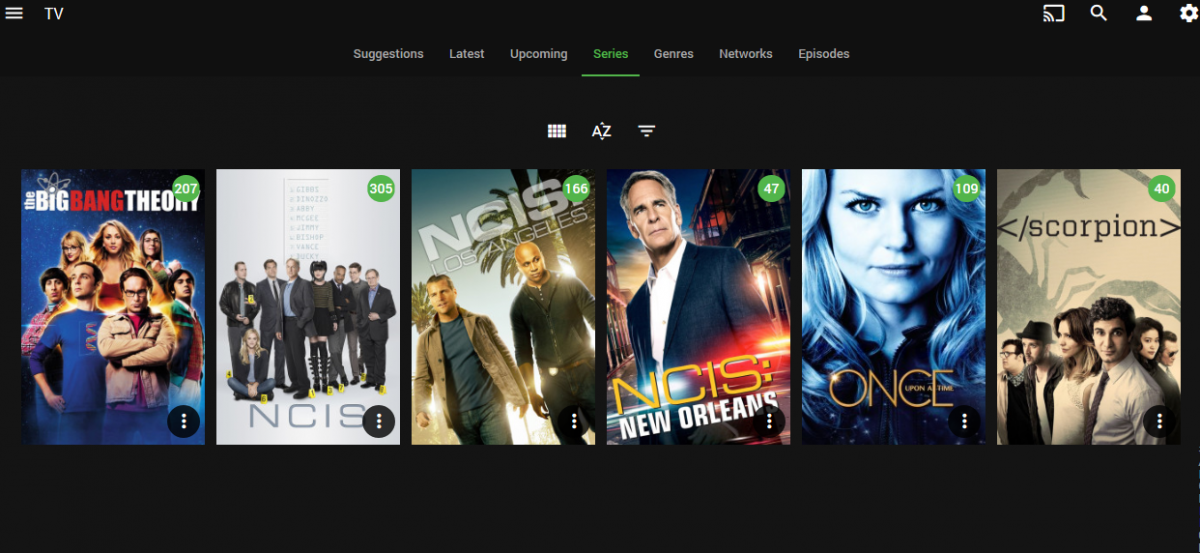

JulesC 51 Posted February 28, 2017 Author Posted February 28, 2017 (edited) Hi, it seems OK here in my testing. Are you able to use the single item edit function? Try right clicking a video -> Edit Info. Hey Luke, Yes, I can right click on a video --> Edit Info, but the info is not the same from the NFO file. Attached are screenshots of what my TV Series screen looks like for series I added as MP4 vs. Video_TS. I was hoping the end results for Video_TS would be the same as MP4. My naive understanding is that Emby will let you choose where they should look for metadata for a movie or show, and you can choose multiple options. IMDB, NFO files etc. So the primary option I would like to set is XBMC NFO importer, so first it looks for an NFO file (created by My Movies), if none is found it moves to the second metadata tool such as IMDB. So I save XBMC / Kodi NFO files from MyMovies, and Emby picks up that info and uses it for its Metadata. Is my understanding accurate? How can I set the primary metadata option to XBMC NFO importer? Do I need to do this from the Metadata Manager? If so, I'm unable to launch it...it just hangs - see original post & log file please. I'm sorry if I'm not presenting this need the right way. Let me know if you have any clarifying questions so you can better understand what I'm trying to accomplish. Any assistance is greatly appreciated. Thanks. Edited February 28, 2017 by JulesC

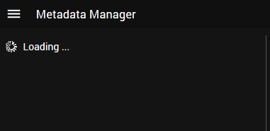

JulesC 51 Posted March 1, 2017 Author Posted March 1, 2017 Luke, I think I have two separate issues going on, so let me focus on one within this thread: Metadata Manager not launching and I'll open another thread for the other issue I'm encountering. I launched the Metadata Manager, it ran for 30 minutes this morning and never launched. Please see the attached screenshot and server log. Let me know if you need anything else. Thank you. server-63623923199.txt

Luke 42197 Posted March 1, 2017 Posted March 1, 2017 Can you try removing all plugins and see if the issue persists? Also as a test, can you try another browser? Thanks.

JulesC 51 Posted March 1, 2017 Author Posted March 1, 2017 Can you try removing all plugins and see if the issue persists? Also as a test, can you try another browser? Thanks. Luke, thank you. Switching browsers fixed the problem. Now I can run "Metadata Manager" and it launches very quickly. Learning's for others: I have Emby installed on a Windows Home Server 2011, which has an older version of Internet Explorer running (at least in my case). Once I downloaded Google Chrome, all is good. So for now on, I will access the Emby Server Dashboard via Google Chrome. Hope this is helpful.
Luke 42197 Posted March 2, 2017 Posted March 2, 2017 Thanks @@JulesC, yes IE11 is the minimum supported version.
