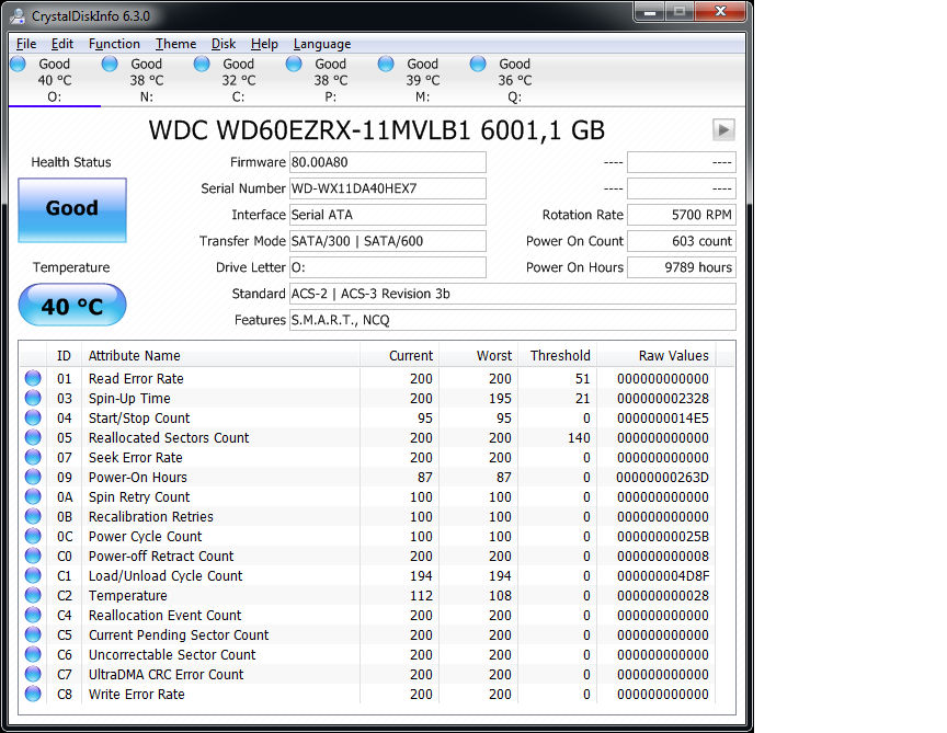

CharleyVarrick 284 Posted May 30, 2017 Posted May 30, 2017 (edited) I"m trying out Stablebit Scanner, and noticed at the bottom of the window this mention: "The on-disk S.M.A.R.T. check is not accessible on any of your disks. Drive temperature and mechanical operating parameters are not available and will not be monitored" Is it saying this only because scanning has just got underway, and it will eventually display the info? I've been using CrystalDiskInfo for a good while and it never complained about status availability. Edited May 30, 2017 by jlr19

Happy2Play 9811 Posted May 30, 2017 Posted May 30, 2017 I"m trying out Stablebit Scanner, and noticed at the bottom of the window this mention: "The on-disk S.M.A.R.T. check is not accessible on any of your disks. Drive temperature and mechanical operating parameters are not available and will not be monitored" Is it saying this only because scanning has just got underway, and it will eventually display the info? I've been using CrystalDiskInfo for a good while and it never complained about status availability. Some controllers require you to adjust the DirectIO option to unsafe to passthrough the SMART information.
CharleyVarrick 284 Posted May 30, 2017 Posted May 30, 2017 Some controllers require you to adjust the DirectIO option to unsafe to passthrough the SMART information. Hi @@Happy2Play Sorry, I have no idea what you mean by that
Happy2Play 9811 Posted May 30, 2017 Posted May 30, 2017 There are advanced options that have to be adjusted to get SMART info to passthrough. I had to change the option to unsafe to see SMART data through my Highpoint card. How to activate these options. Click on the "Settings" button in the toolbar and select "Scanner Settings". Enable the "Show advanced settings and information" option, and hit "OK". You will only need to do this once, from now on, it will always display this option.Click on "Settings", and select the new "Advanced Settings and information" option. Open the Configuration Properties tab. You will find a list of all the settings here, organized into section. You can also search for the setting you are looking for.Once you've made any changes, you will need to restart the service, or restart the computer. To restart the service, run "services.msc" on the system find the "StableBit Scanner Service" and restart it.And the setting is the "Unsafe" option under "DirectIo".Also, make sure that the HighPoint management software is installed on the system as well... as apparently without this, the SMART data doesn't update properly (yay highly proprietary firmware)
CharleyVarrick 284 Posted May 30, 2017 Posted May 30, 2017 There are advanced options that have to be adjusted to get SMART info to passthrough. I had to change the option to unsafe to see SMART data through my Highpoint card. How to activate these options. Thanks!

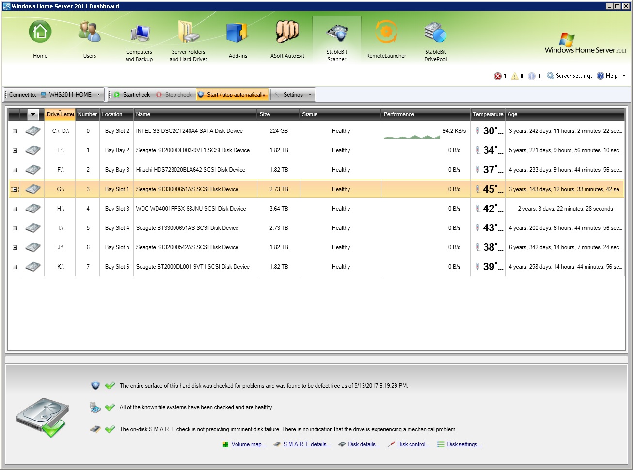

Happy2Play 9811 Posted May 30, 2017 Posted May 30, 2017 (edited) I am still on version integrated in whs2011. Edited May 30, 2017 by Happy2Play 1

CharleyVarrick 284 Posted May 30, 2017 Posted May 30, 2017 I am still on version integrated in whs2011. Nice, mine doesn't look anything like that. You got all your relevant info in there, and I like the fist in your face icon...
