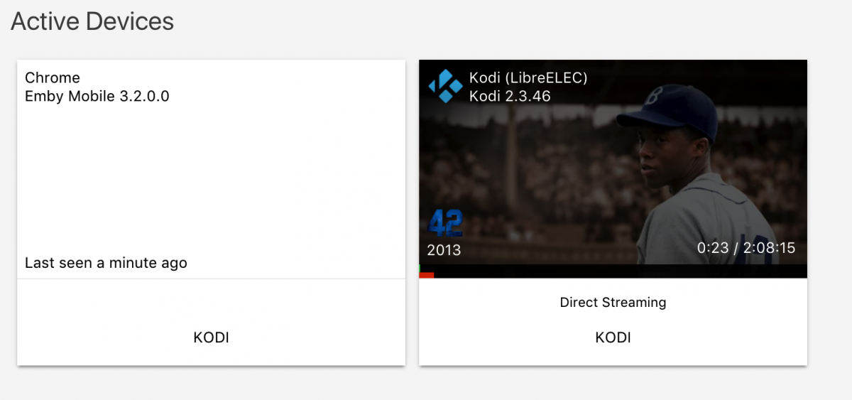

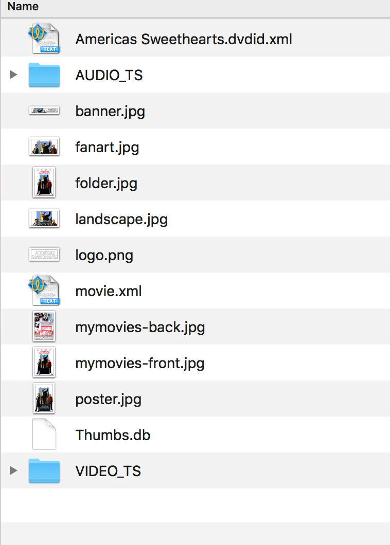

dbott 16 Posted February 21, 2017 Author Posted February 21, 2017 The .mp4 video files for example play just fine and do not ask about subtitles and in the server is shows playing direct. If trying to play a Blu-ray, main movie rip, it will ask about subtitles and then looking at the server it will show as transcoding which made to sense as Kodi should be doing the work. Thus became the question on the paths for maybe that was it.

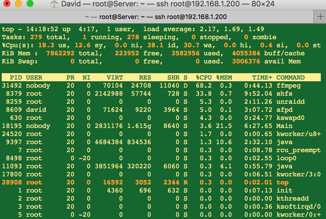

dbott 16 Posted February 21, 2017 Author Posted February 21, 2017 (edited) Ok, well, some videos transcode and some do not. DVD's, transcode and always ask for subtitle choice. Blu-rays some transcode and some play direct but always asks for subtitle choice. Straight files (like mp4) play direct and do not ask about subtitles. But here is an issue....Even though the Blu-ray & DVD's reads as Direct Streaming - FFMPG is invoked on the server anyway and is being used thus killing the server. (Even though it works, the server was not made for transcoding, just storage/playback) Even if I switch to Native Mode all is the same. Edited February 21, 2017 by dbott

dbott 16 Posted February 22, 2017 Author Posted February 22, 2017 @@dbott I think that will be fine. The only thing you're really going to miss is transcoding support if you're away from home. Is that correct @? Let us know how you get on with it ! Hi...Actually only that Kodi will not be able to transcode and that is fine as it stays in place. What I do loose is the advanced features that most of your paid features do. (Like trailers or bumper before the movie starts.) It still makes no sense that the Emby server reported Direct Playing a video but it surely was using FFMPG as shown in the screen grabs. So it seems it is not handing out the direct link to Kodi as it should even though it thinks it is. So I do think that there may be an issue with the server or Kodi addon (16.1) as surely this is not expected behavior. (It would have been great to use the extra features at some point.) SIDE NOTE ISSUE: I am using your UnRAID docker and the repository version that came down from your repository is 3.2.0 and the current version is 3.2.1. (released 12 days ago) It has not auto upgraded even over night, so not sure how to get to the current version. I did post a message about it in the docker thread for it on UnRaid forum in a thread started by an Emby developer. https://forums.lime-technology.com/topic/43743-new-emby-docker/?do=findComment&comment=539073 The only reply was...Have to wait for them to push it out. It has been 12 days and also I would think the built in auto updater would have kicked in and brought it down.

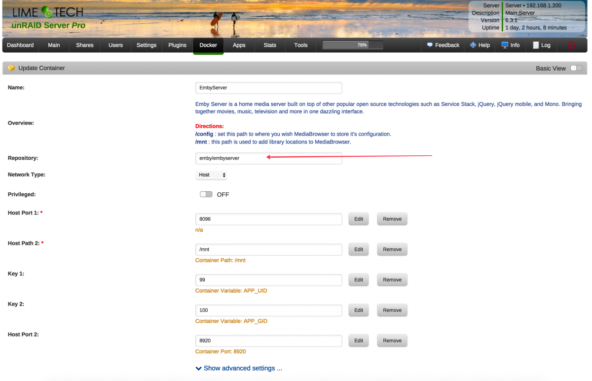

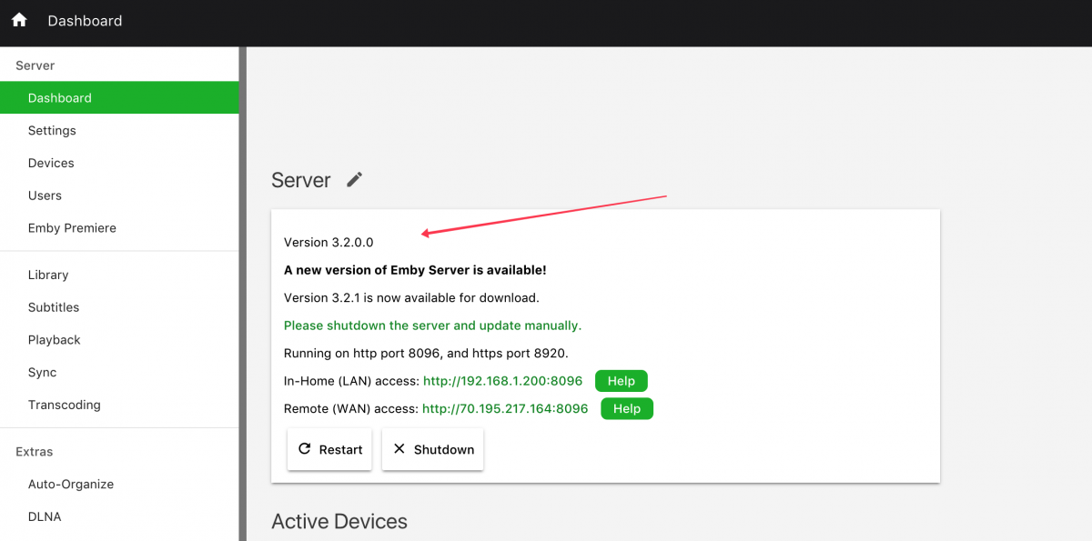

Luke 42245 Posted February 22, 2017 Posted February 22, 2017 @@dbott, it may have reported direct stream. When it says direct stream, that means the video is just being changed into a different container but is not re-encoded. Our Docker is up to date with the latest release though. Have you tried to update again?
dbott 16 Posted February 22, 2017 Author Posted February 22, 2017 @@dbott, it may have reported direct stream. When it says direct stream, that means the video is just being changed into a different container but is not re-encoded. Our Docker is up to date with the latest release though. Have you tried to update again? Hi Luke... Well it is doing something as FFMPG is running and using the server. I understand what you are saying, but understand, when you read that it will just play back directly per the docs and the server says direct playing, that is what one thinks should be going on. If it is putting it into another container, then it is doing something with it and that is not direct. (Not to mention asking about subtitles all the time which is just silly. Whats up with that anyway.) Thanks for the note on the Docker. I have just now reinstalled the docker from the repository and it is still at 3.2.0. I could find no way to have the Emby server force update itself and Auto Update is turned on. So no joy on that either.

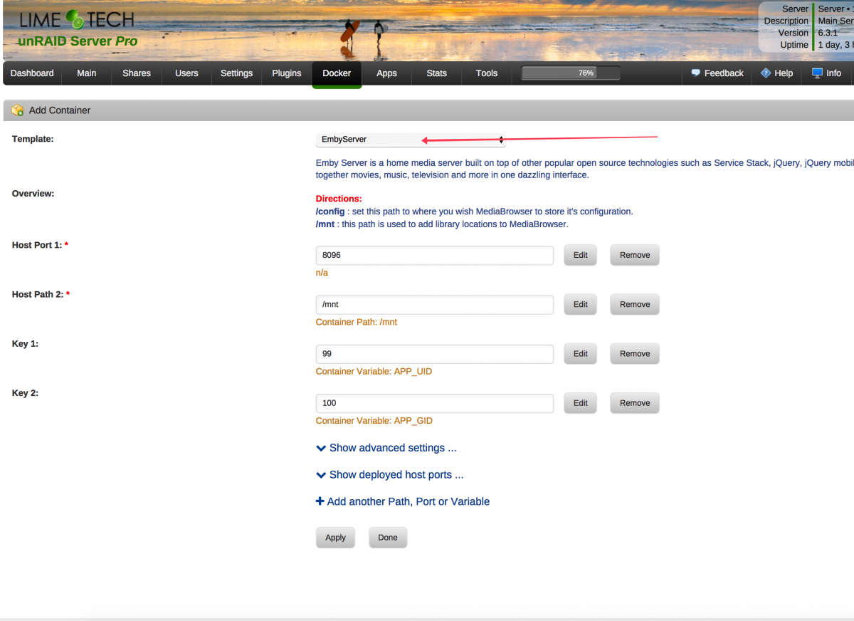

dbott 16 Posted February 22, 2017 Author Posted February 22, 2017 Hey Luke... When looking to get the upgrade to work, a note to whomever handled the docs here... https://github.com/MediaBrowser/Emby.Build#unraid-automatic-upgrades It seems that the docker template container name is NOT set to be "emby-server" as the doc states, it is set to be "EmbyServer". As such, the command in the referenced link is not correct. It should be... echo "0 2 * * * docker exec EmbyServer update" | sudo tee -a /var/spool/cron/crontabs/root (All other references to installs in Linux do show emby-server, it is just the docker template that sets it in correctly and not sure how long it has been like that. If from day one, I would suggest updating the doc. Otherwise, the template should be updated to setup the right container.
hurricanehrndz 149 Posted February 22, 2017 Posted February 22, 2017 Hey Luke... When looking to get the upgrade to work, a note to whomever handled the docs here... https://github.com/MediaBrowser/Emby.Build#unraid-automatic-upgrades It seems that the docker template container name is NOT set to be "emby-server" as the doc states, it is set to be "EmbyServer". As such, the command in the referenced link is not correct. It should be... echo "0 2 * * * docker exec EmbyServer update" | sudo tee -a /var/spool/cron/crontabs/root (All other references to installs in Linux do show emby-server, it is just the docker template that sets it in correctly and not sure how long it has been like that. If from day one, I would suggest updating the doc. Otherwise, the template should be updated to setup the right container. Thanks, if you wish you can fix and do a pull request.
dbott 16 Posted February 22, 2017 Author Posted February 22, 2017 Thanks, if you wish you can fix and do a pull request. Not sure what I would fix. For as mentioned, not sure how long it has been like this and thus could affect people. As of this time it seems to be a year old thus the docs are incorrect. (IMHO)
hurricanehrndz 149 Posted February 22, 2017 Posted February 22, 2017 Not sure what I would fix. For as mentioned, not sure how long it has been like this and thus could affect people. As of this time it seems to be a year old thus the docs are incorrect. (IMHO) It's a typo more than anything, and the code is an example. Most users just use the EDGE variable.
dbott 16 Posted February 22, 2017 Author Posted February 22, 2017 It's a typo more than anything, and the code is an example. Most users just use the EDGE variable. It does not read as an example. "On unRAID, execute the following to have the container periodically update itself..." In any case, I discovered it when I tried to get the upgrade working and did what it said. I mentioned it to try to help. Thanks
hurricanehrndz 149 Posted February 22, 2017 Posted February 22, 2017 It does not read as an example. "On unRAID, execute the following to have the container periodically update itself..." In any case, I discovered it when I tried to get the upgrade working and did what it said. I mentioned it to try to help. Thanks Again thank you so much for your contribution. You could fix the typo by forking the github project and fixing the typo if you wish, that way your contribution is recognized. Otherwise, I will get to it by the end of the week or so.
