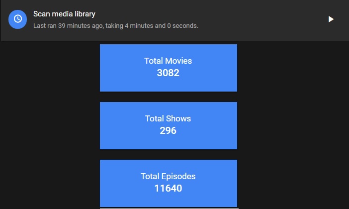

Happy2Play 9802 Posted February 23, 2017 Posted February 23, 2017 (edited) Another question, what is the approximately time I should expect a library scan to take with 2800 movies and 160 TV series (each with multiple seasons and episodes) in my libraries? I won't bother with this if what I'm seeing is what I should expect, and since there are no obvious errors I'm starting to wonder if this is just how long it takes? A lot depends on your setup. Is all your data local or external? Are you using a SSD for the server? This is my small server Edited February 23, 2017 by Happy2Play

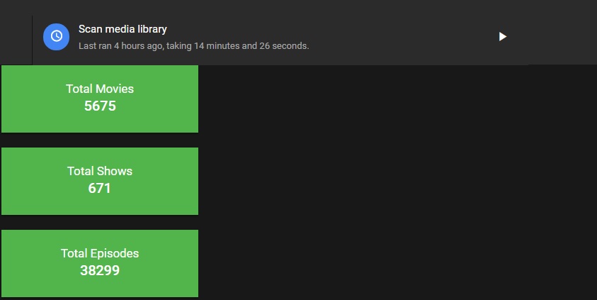

Happy2Play 9802 Posted February 23, 2017 Posted February 23, 2017 (edited) Thanks, now this is very interesting as you have way better library scan times than me with a bigger library. Could you please share some system specs? See my signature for server specs. My Main server Both servers have all local/internal data. Edited February 23, 2017 by Happy2Play

dcook 303 Posted February 24, 2017 Posted February 24, 2017 How do you guys get the library scan to give you a total number of items? Mine does not give that info, it just says: Last ran x hours ago, taking x minutes
Happy2Play 9802 Posted February 24, 2017 Posted February 24, 2017 How do you guys get the library scan to give you a total number of items? Mine does not give that info, it just says: Last ran x hours ago, taking x minutes That is the Statistics plug and library scan results in one image.
