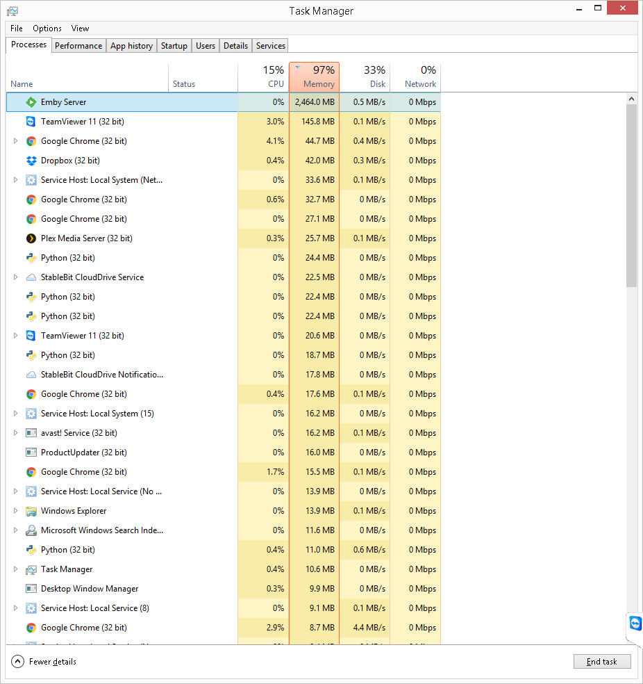

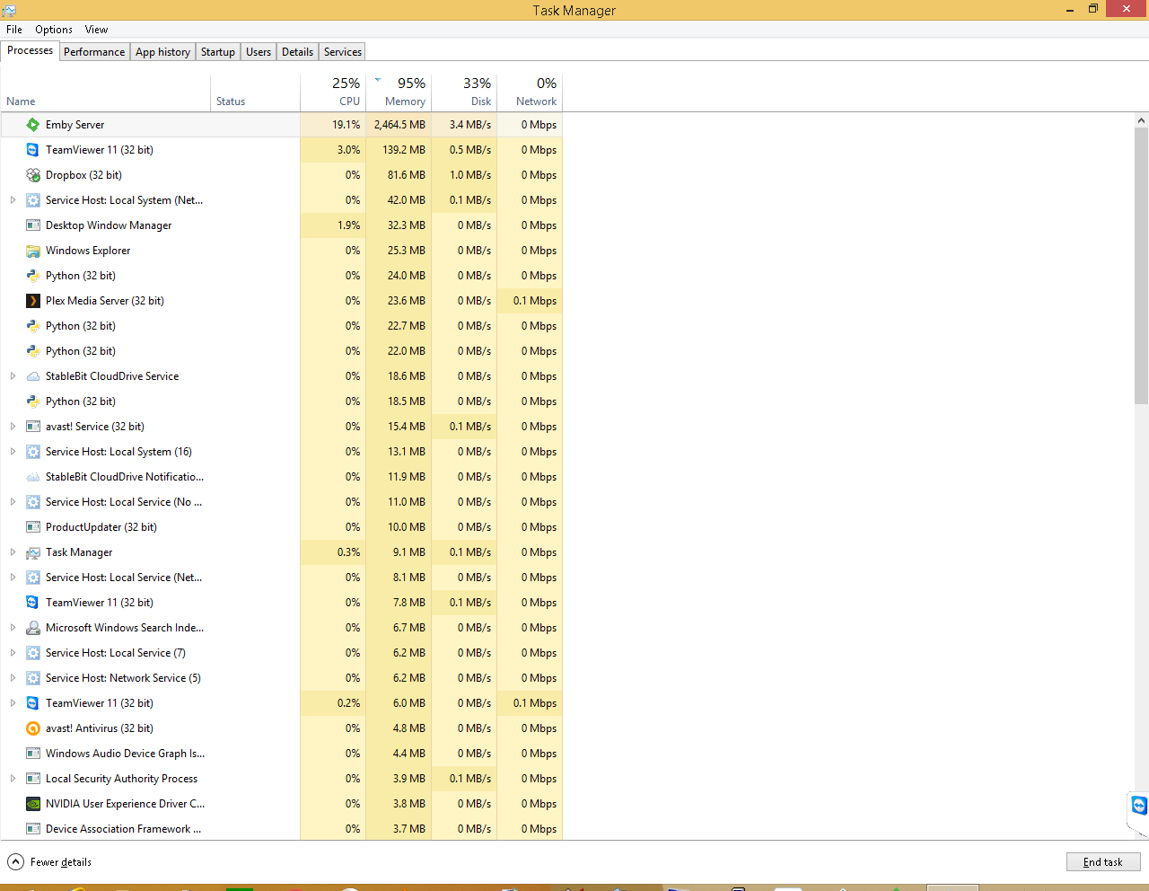

Mystical666 3 Posted February 14, 2017 Posted February 14, 2017 Hi, I have purchased an EMBY Premium Subscription and this is the first time I have ever used the software but I am getting very high RAM usage on the server. All I have done so far is install the Server, add a couple of Libraries and let it scan, I left this overnight and when I came back this morning I could no longer access the computer as it had crashed (as i thought at the time), but actually it hadnt crashed but it had eaten up all the memory available and made the server so slow nothing would work on it, I cant access any interface etc. So I have no access to Libraries (they wont display), I cant change any settings and I cant access Remotely or over the local Network. When I restart the PC (tried this several times) the memory usage starts off normal then rapidly jumps up. All my media is located on NAS drives over the local network, nothing is stored on the server. Does anyone have any advice? Please see screenshot below the memory usage. thanks,

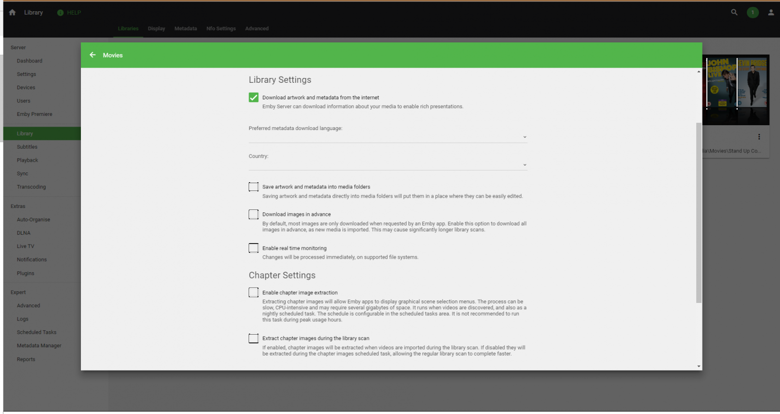

Latchmor 584 Posted February 16, 2017 Posted February 16, 2017 Hi, do you have chapter image extraction on per library during the scan? That can slow things down a lot. If I add lots of media at once I disable this setting so it just scans and matches media. Then after (through the night) I'll kick off a chapter extraction. Perhaps you could show a screen print of what the Rips folder structure/content looks like? Also, that log file doesn't show much, can you find the one where it was scanning then became unresponsive? Cheers
