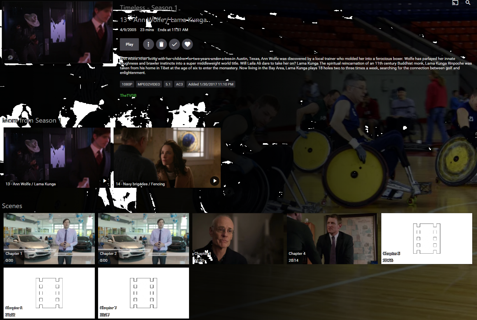

tvinhas 14 Posted February 13, 2017 Posted February 13, 2017 Hi, Got into a peculiar bug today. If I have a recording interrupted for some reason, and then I replace that file with a full-length file, Emby won't update the show information no matter what, even with different filenames. I got two shows interrupted (disk space issue) and after I removed the files and replaced with the full episodes, no matter what I do Emby will still show them with about 20 minutes, even though the chapter extractor shows there's more. Take a look at the screenshot:
tvinhas 14 Posted February 13, 2017 Author Posted February 13, 2017 @@Luke is there anyway I can remove that episode's information so Emby can properly detect those two episodes as new, and not reusing the information for the originally recorded files?
Jdiesel 1506 Posted February 13, 2017 Posted February 13, 2017 (edited) You could try forcing a Scheduled Task to clean the database Edited February 13, 2017 by Jdiesel
tvinhas 14 Posted February 13, 2017 Author Posted February 13, 2017 You could try forcing a Scheduled Task to clean the database I did, but it takes 0 seconds, so I guess it's not doing much...
Solution Luke 43461 Posted February 13, 2017 Solution Posted February 13, 2017 Just a run a library scan and Emby will reprobe the file. 1
