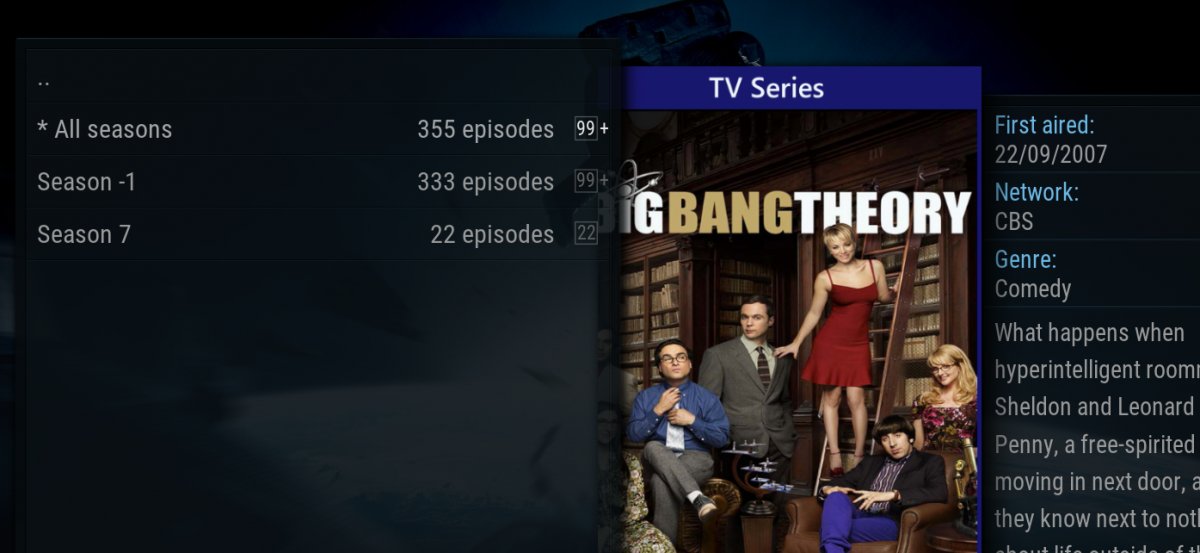

HTPCS 1 Posted February 12, 2017 Posted February 12, 2017 All TV folders on server is configured correctly. Show\season\show.s01e01.episodename.ext but some /all tv shows showing folder season -1 under kodi Refer to pic Not sure what is going on. Regards, HTPCS.
HTPCS 1 Posted February 17, 2017 Author Posted February 17, 2017 (edited) So i can confirm that my entire library is configured the same Folder = Series Name File name = Series.S01E01.epsiodename.ext Problem is i am seeing some picked up correctly and others not. Season -1 seems to be some kinda " All Seasons" catch all. nbo point trying to explain. watch vid Regards, Alan. Edited February 17, 2017 by HTPCS

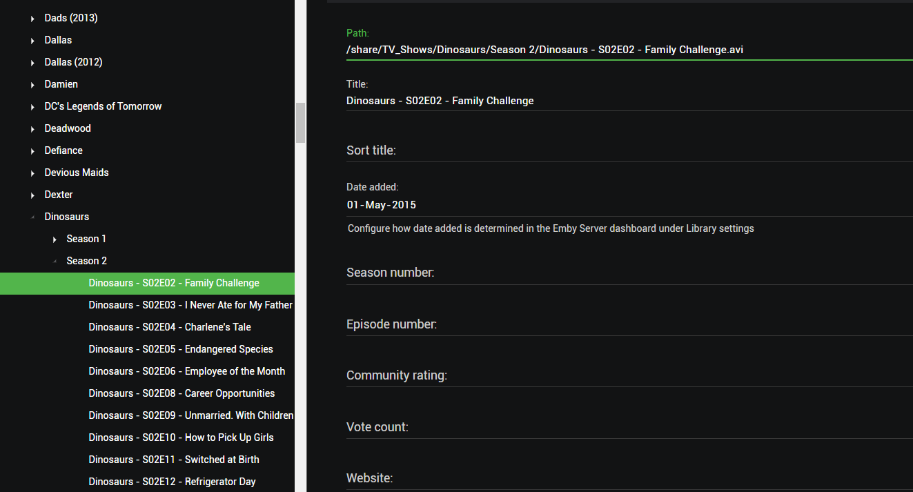

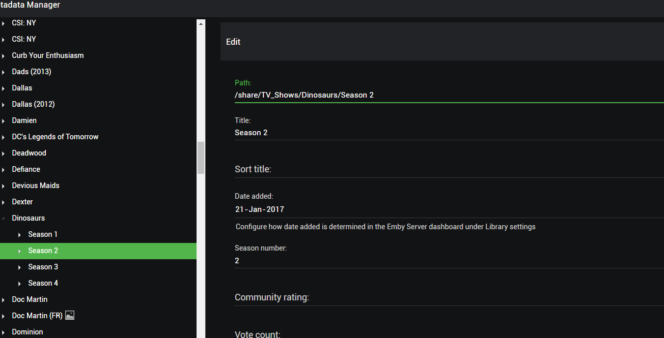

Angelblue05 4132 Posted February 17, 2017 Posted February 17, 2017 (edited) In the Emby metadata manager, look at the episodes that appear under the -1 season in Kodi. These episodes don't have a season number in the metadata manager. Add the season number and it will correct the issue. Something must be wrong with your file naming if Emby is not able to automatically determine the season number. Edited February 17, 2017 by Angelblue05
HTPCS 1 Posted February 17, 2017 Author Posted February 17, 2017 (edited) In the Emby metadata manager, look at the episodes that appear under the -1 season in Kodi. These episodes don't have a season number in the metadata manager. Add the season number and it will correct the issue. Something must be wrong with your file naming if Emby is not able to automatically determine the season number. Season is depicted by the following in the naming convention Edited February 17, 2017 by null_pointer

HTPCS 1 Posted February 17, 2017 Author Posted February 17, 2017 Missing the season number. and episode number.
