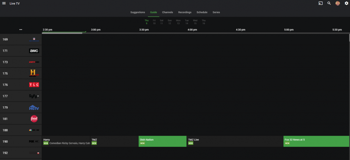

Luke 42197 Posted February 9, 2017 Posted February 9, 2017 and what does your guide look like? can you show a screenshot of that? thanks.

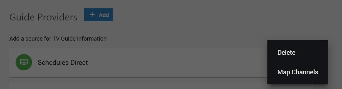

Luke 42197 Posted February 9, 2017 Posted February 9, 2017 Can you go into live tv settings, click the 3-dot menu next to schedules direct, then take a screenshot of the popup that opens up? thanks.
tpchristian 2 Posted February 9, 2017 Author Posted February 9, 2017 Wonder, if you might have wanted this. (Well, now I see where mappings are )

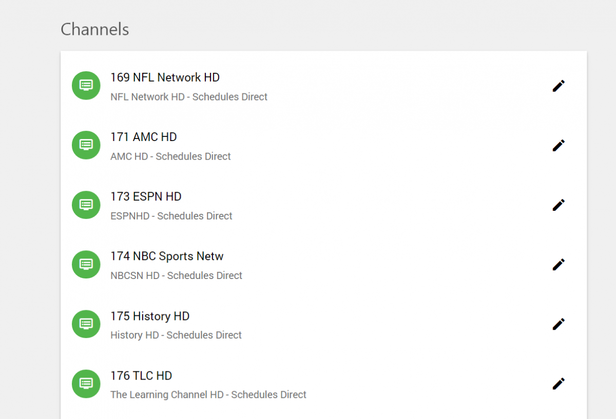

Luke 42197 Posted February 9, 2017 Posted February 9, 2017 Sorry, the popup after clicking map channels.
Luke 42197 Posted February 9, 2017 Posted February 9, 2017 Do they all have mappings listed under the channels or are any blank?
tpchristian 2 Posted February 9, 2017 Author Posted February 9, 2017 If I am reading this correctly, they all do. There is smaller font text with the SD channel name below all of them. NOTE: I never did anything to do a mapping.

Luke 42197 Posted February 10, 2017 Posted February 10, 2017 No i'm just curious if another guide download has any effect because right now everything seems to look normal, apart from the missing data.
