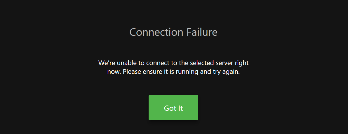

JulesC 51 Posted February 8, 2017 Author Posted February 8, 2017 Starting the installation process for Emby Theater for Windows (Windows Store app) On the next installation screen I see "Sign in with Emby Connect", which I skip since I'm trying to connect to my Emby Server within my LAN. Next, I try to "Connect to Server" via the IP Address. After it tries to connect for awhile I get this "Connection Failure" message. Is this what you were looking for? Let me know if you need any additional information.
JulesC 51 Posted February 8, 2017 Author Posted February 8, 2017 I tried connecting to the Emby Server from another PC within our LAN via the browser (following suggestions from "Connectivity" wiki), but i received the following error:This site can't be reached [iP Address] took too long to respond ERR_CONNECTION_TIMED_OUT Further supporting your point about "general connectivity issues".
Luke 42243 Posted February 8, 2017 Posted February 8, 2017 Ok, then i would check out the troubleshooting section. Something is blocking the connection and we need to find out what. thanks.
JulesC 51 Posted February 8, 2017 Author Posted February 8, 2017 Good point, Luke. I reviewed the "Connectivity" wiki. Once I opened the TCP Port (8096) on the Windows Firewall I was able to connect my HTPCs and iOS devices. Thanks for guiding me along as I ramp up my learning's for Emby. 1
