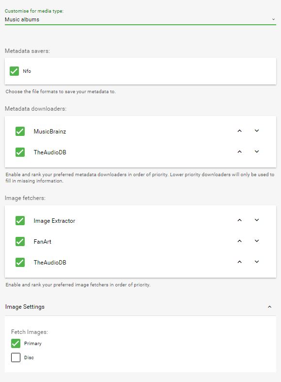

Happy2Play 9802 Posted February 23, 2017 Posted February 23, 2017 (edited) How are your Music Artist and Music Album Downloaders/Fetchers set? Dashboard-Library-Metadata-change the "Customize for media type:" drop-down Edited February 23, 2017 by Happy2Play
