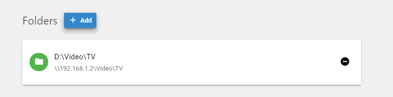

Luke 42197 Posted February 7, 2017 Posted February 7, 2017 So in your case, the videos are streaming through Emby Server : 2017-02-06 23:49:33.4012,Debug,,Calling MediaCenterEnvironment.PlayMedia: http://10.10.0.1:8096/emby/videos/42f7a743600248d312da63d7a2eb6214/stream.asf?DeviceId=d098b47cc85842fd83becc42ae068476&MediaSourceId=42f7a743600248d312da63d7a2eb6214&VideoCodec=msmpeg4&AudioCodec=wmav2&AudioStreamIndex=1&VideoBitrate=29872000&AudioBitrate=128000&MaxAudioChannels=2&api_key=94f9f19b093c44db84d93d314cb0df76&CopyTimestamps=false&ForceLiveStream=false,1,Application This is happening because the machine running Emby for WMC does not have direct access to this location: F:\My Videos 03\TV Shows 02\TV Shows\Bones (2005)\Season 12 What you want to do is share the path over the network, then go into Emby library setup, click on each of your folder paths, and fill in the optional network path.

Solution Luke 42197 Posted February 7, 2017 Solution Posted February 7, 2017 Click on the f: folder path in library setup and edit it and enter the network path. when you are done it will look like this The top path is what Emby server will use internally, the bottom path is what apps on other devices will use. 1

Mustang Dave 5 Posted February 7, 2017 Author Posted February 7, 2017 Beautiful... thanks Luke, it works perfectly now. All I need to do now are the others. Thanks for everything.... Hey while I got you, just curious, but any eta with anything with the shortcut situation??
