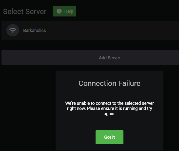

ucantcme69 2 Posted February 6, 2017 Posted February 6, 2017 Hello everyone. I hope this is just an easy fix but I had everything working properly and then over night it stopped letting me connect to my server remotely with connect. The mobile android app does let me connect and see my content. I have port forwarding setup. I restarted the server I restarted the emby server itself removed port forwarding and readded it on my router I've tried multiple browers and a different device Each time im getting the following: Connection Failure We're unable to connect to the selected server right now. Please ensure it is running and try aga I am newer with this so I apologize if this might be an easy fix. I can connect with the connect app on my home network which made me think it was port forwarding at first. I'm just stuck at this point with things to look over. Thanks

ucantcme69 2 Posted February 7, 2017 Author Posted February 7, 2017 Following the article I try: Remote (WAN) access: [redacted] This doesn't load for me. Moving on to step two: http://www.canyouseeme.org/ does verify it can see port 8096 open Restarted server Restarted router Same issue Also to answer I can access other things outside my network. The mobile app works fine as well as a plex setup I still have going until I have everything set the way I like it with emby
ebr 16309 Posted February 7, 2017 Posted February 7, 2017 I just clicked on the link you had above (I removed it so you don't get swamped) and it loaded the Emby Login page for me...
Solution ucantcme69 2 Posted February 7, 2017 Author Solution Posted February 7, 2017 You're right. It must be the location im physically at. I just tried using my phones network and it worked. Thank you much for being patient and helping me out 1
