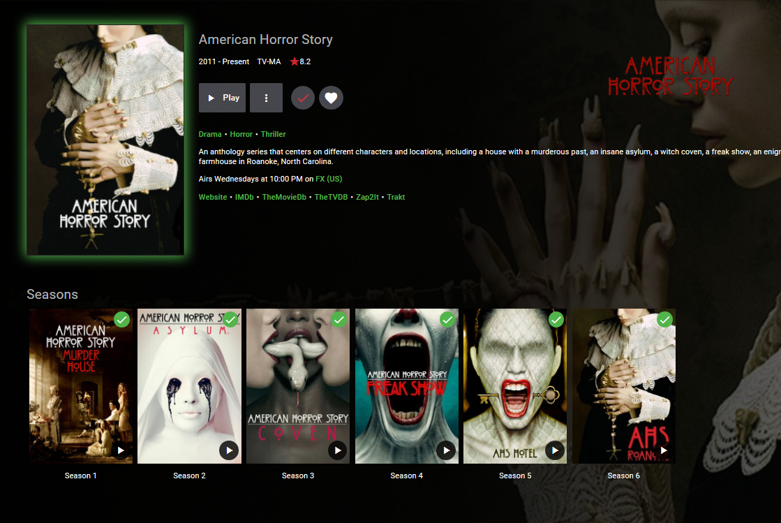

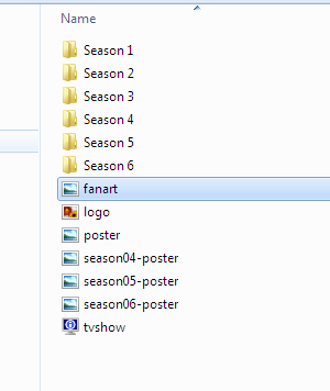

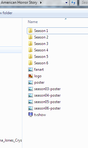

Spyderturbo007 19 Posted January 29, 2017 Author Posted January 29, 2017 (edited) Thanks Luke. I just found that in another thread. Is there a way to get it to use the existing artwork? Also, it doesn't appear to be finding everything. Log attached. For example, I refreshed American Horror Story. Here is the initial screenshot prior to using the Refresh: Here is what was in the directory after the refresh. Notice that it's missing the images for Season 01, 02 & 03. If I manually open Season 03 and hit Refresh, it will load the image. Log.txt Edited January 29, 2017 by Spyderturbo007
Luke 42197 Posted January 29, 2017 Posted January 29, 2017 That screenshot looks good to me, what is the issue exactly? Why not just leave it alone?
Spyderturbo007 19 Posted January 29, 2017 Author Posted January 29, 2017 The screenshot was before the refresh, not after. The exact issue is that posters for Season01, Season 02 & Season 03, were not downloaded during the refresh operation. I don't want to let it alone because it isn't copying the images correctly. I'd like all of the images on the parity protected array in case my cache drive dies.

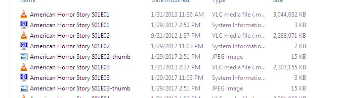

Spyderturbo007 19 Posted January 30, 2017 Author Posted January 30, 2017 And what images are in the Season folder? Only the .mkv file, the .nfo file and a thumbnail image for each of the episodes. What are you using for the parity protection? I'd been thinking about moving my metadata from the media folders to a custom location because I recently had some issues restoring a drive using Snapraid. I had a drive failure within my first few weeks of getting Snapraid up and running. When I went to restore the drive, a few of the files couldn't be restored. From the log it looked like Emby had updated a few .nfo files since the last sync after videos were watched, but because files changed on the drives that didn't fail, it caused issues restoring the drive that did fail. I don't know a ton about Snapraid, so I've been meaning to ask on here to see what others do if they run Emby server and Snapraid or something similar. In my case, I didn't lose anything that I couldn't just reload and it still saved me hours of reloading a bunch of stuff I own. I'm not familiar with Snapraid, but I use a program called unRAID. I currently have 22TB of storage and a 6TB parity drive. After my last upgrade, I noticed that they added support for dual parity drives. I have another 6TB on order in case something bad happens. I'd really like to build another server and move it offsite, but buying 28TB of drive space isn't the cheapest thing in the world. Why not just Backup you cache drive/images? It's easier to let the parity drive handle things. I'm also not sure if I'll be using any add-ons in the future that will want to access the images directly, as opposed to going through Emby.

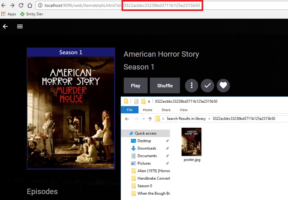

Happy2Play 9802 Posted January 30, 2017 Posted January 30, 2017 Is there a way to confirm that's the case? You would need to navigate to that season and look at the url to get the item id and search for the id in the metadata/library folder. See what images are in that folder. Example

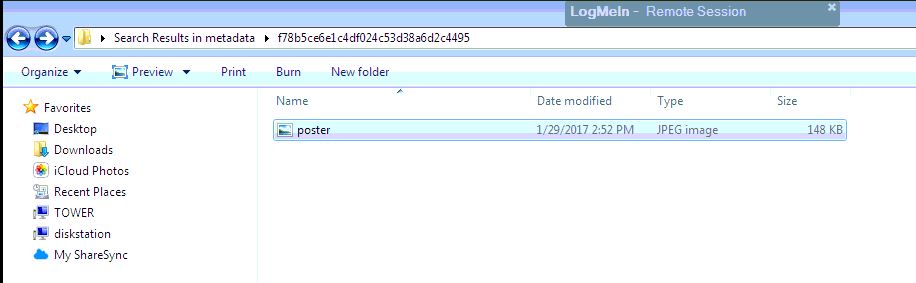

Spyderturbo007 19 Posted February 2, 2017 Author Posted February 2, 2017 You would need to navigate to that season and look at the url to get the item id and search for the id in the metadata/library folder. See what images are in that folder. Example The only thing in the Emby metadata folder is the Season Cover Art, which isn't in the folder with the shows / NFOs.
