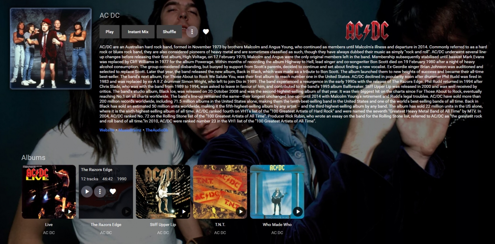

Guest asrequested Posted January 29, 2017 Posted January 29, 2017 So I tried this with AC/DC (just one album) Removed, ran library scan, cleaned folder(s), musicbrainzed it, added it back to the library, and hey presto! AC/DC has disappeared! The album is there, but no amount of editing the info will make the band show up under Album Artist or Artist

PenkethBoy 2068 Posted January 30, 2017 Posted January 30, 2017 So I tried this with AC/DC (just one album) Removed, ran library scan, cleaned folder(s), musicbrainzed it, added it back to the library, and hey presto! AC/DC has disappeared! The album is there, but no amount of editing the info will make the band show up under Album Artist or Artist lol - you had to choose AC/DC change the artist and album artist tags inside the mp3 to AC-DC - there are a couple of long threads here on the / and other non "standard" characters that emby used to have problems with If it were my collection i would use something like mp3tag and remove all tags from the files so they are clean and do not have any data that could confuse emby prior to using picard -
Happy2Play 9811 Posted January 30, 2017 Posted January 30, 2017 Yes that "/" in AC/DC is still an issue when it comes to Artists and Album Artists. Had to manually add artist id to each album for Artists and Album Artists to show them. Or as @@PenkethBoy said change the tag from AC/DC to AC-DC.

Guest asrequested Posted January 30, 2017 Posted January 30, 2017 In the end, the solution was simply to delete all the fields and refresh. But it won't pull any cover art. It's always been blank. The name was AC-DC, I changed it to AC/DC (that's how musicbrainz names it), and still no cover art. I'll have to manually put it in.
