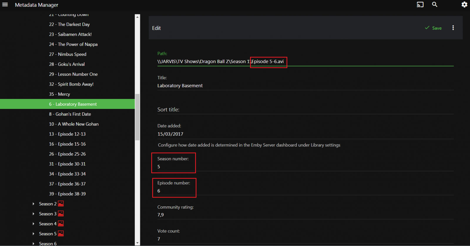

SilentStrike 1 Posted March 15, 2017 Author Posted March 15, 2017 (edited) Hey Luke, Been importing my library all night! So far, it seems to be working! It's just taking a lot of time, but that's ok. Once it's done, it's done! Already a great step Thanks! That being said, there seems to be an issue with multi-episodes. As you can see, multi-episodes (Episode 5-6) is immediately split into Season 5 Episode 6 while it should be considered as Episode 5 Episode 6. I don't know if there's anything you can do about this part? Edited March 15, 2017 by SilentStrike

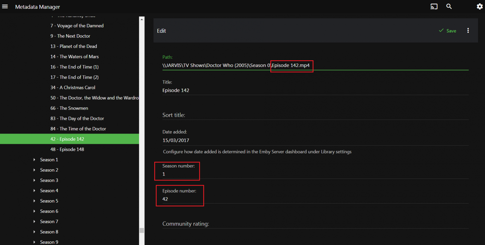

SilentStrike 1 Posted March 15, 2017 Author Posted March 15, 2017 Another issue I encountered is if I have a tripple digit Episode #. It splits it to try and get the Season #. This is rare, but can still happen.
Luke 42197 Posted March 15, 2017 Posted March 15, 2017 These are not issues, these are clashes with supported naming conventions. For these situations you need to use a supported naming convention, I am sorry. I can't make changes for these without breaking other scenarios. So in the first example you could use 1x05-x06 Or any of other other multi-episode naming conventions. In the second example, you could use 1x42 Or any of our other naming conventions. Or, you could leave the file names alone and just use the Emby editor and persist the overrides in nfo files.
SilentStrike 1 Posted March 15, 2017 Author Posted March 15, 2017 Thanks for the info about multi-episode. How to I change 1 file in the metadata manager to say "Hey, this is 2 episodes" ? In the second example, you could use 1x42 Or any of our other naming conventions. Or, you could leave the file names alone and just use the Emby editor and persist the overrides in nfo files. Concerning this example, that would output Season 1, Episode 42. What I'm aiming for here, is Season 0 Episode 142. Yet it parsed Episode 142 as Season and Episode due to the fact it was a 3-digit episode. I'm assuming you can't do anything about this part? (If you can, how could I rename my files for this?) I'm still wondering whether I'll rename those files, or I'll use the metadata manager. But not having to edit 7,000 but maybe 100 is a huge win for me! Thanks again! That being said, my library scan crashed after 11 hours of scanning. I tried scanning again and it crashed again. I'm not home, so I can't access the physical logs (Stream too long, so can't open in web page), but when I do get there, I'll send them over.
