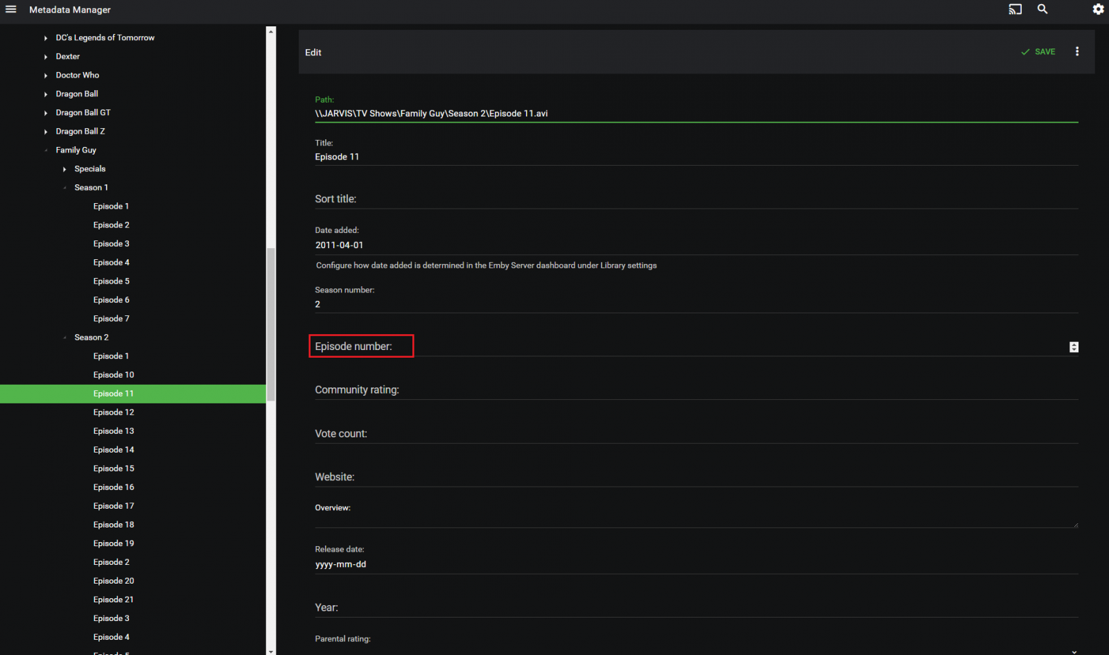

SilentStrike 1 Posted January 29, 2017 Author Posted January 29, 2017 Hey Luke, thanks for the reply. I took a screenshot of how the file is interpreted at first. Basically, you see my file name up top as a reference. It doesn't recognize the episode number. It just recognizes the Season # due to the folder it is situated in. Which actually made me think... What about those multi-episode files? Found a good example bellow which basically made me realize that basically it's ABSOLUTELY looking for a Season # in the file name, or else it doesn't find anything. Almost like the parents folder has no impact whatsoever. As for the French metadata.. I'm a bit confused now... To try and see if it was the fact it was a subfolder that was hindering everything, I created a seperate folder and refreshed the metadata on that one. It came out in French... But... Wrong movie? While the same file, in another library, was properly identified? I really don't know what happened there... And to answer your question, I'm positive. All my French movies were parsed with Kodi in the past by themoviedb.org and I've never encountered any issues of the sort. Anyways, that's what I got for now, let me know if you know what's going on, and if you need me to give you any other information! Thanks!

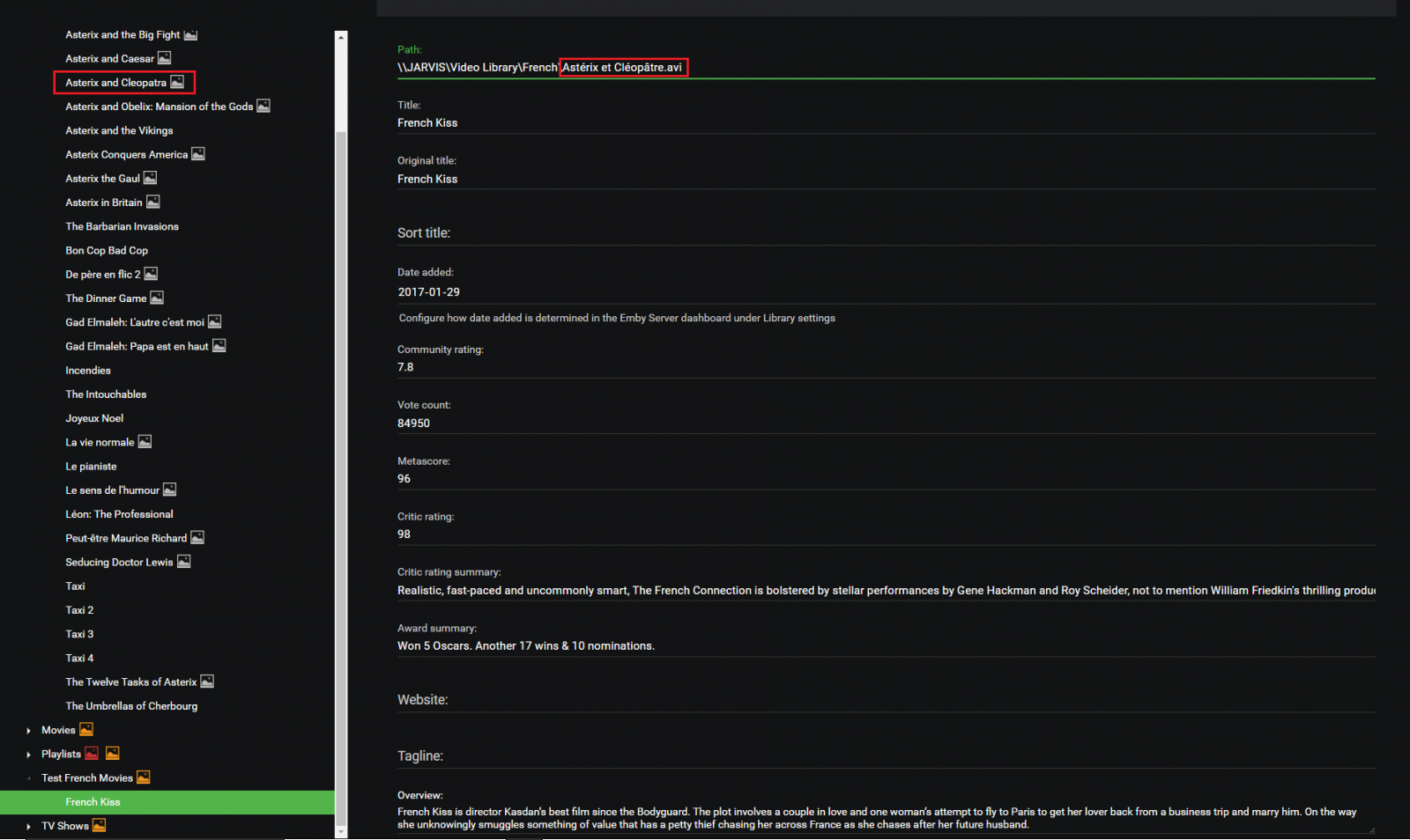

SilentStrike 1 Posted January 29, 2017 Author Posted January 29, 2017 (edited) I tried switching to fr, but it's no good either. Everything is still in English. Yet from the link you provided, everything seemed to be in French. Edited January 29, 2017 by SilentStrike
SilentStrike 1 Posted January 29, 2017 Author Posted January 29, 2017 I forgot to post the logs.. So here they are. Again, very curious.. Doesn't show anything in French.. Also tried it on my testing folder, and it never refreshed the movie.. 2017-01-28 23:28:10.8430 Debug JsonSerializer: Deserializing file C:\Users\Ben\AppData\Roaming\Emby-Server\cache\tmdb-movies2\2335\all-en.json 2017-01-28 23:28:10.8430 Debug App: Running MovieNfoProvider for \\JARVIS\Video Library\Movies\French\Taxi 4.avi 2017-01-28 23:28:10.8430 Debug App: MovieNfoProvider returned no metadata for \\JARVIS\Video Library\Movies\French\Taxi 4.avi 2017-01-28 23:28:10.8430 Debug App: Running MovieXmlProvider for \\JARVIS\Video Library\Movies\French\Taxi 4.avi 2017-01-28 23:28:10.8430 Debug App: MovieXmlProvider returned no metadata for \\JARVIS\Video Library\Movies\French\Taxi 4.avi 2017-01-28 23:28:10.8430 Debug App: Running FanartMovieImageProvider for \\JARVIS\Video Library\Movies\French\Taxi 4.avi 2017-01-28 23:28:10.8430 Debug JsonSerializer: Deserializing file C:\Users\Ben\AppData\Roaming\Emby-Server\cache\fanart-movies\2335\fanart.json 2017-01-28 23:28:10.8650 Debug App: Saving \\JARVIS\Video Library\Movies\French\Taxi 4.avi to database. 2017-01-28 23:28:10.8796 Debug App: Running FFProbeProvider for \\JARVIS\Video Library\Movies\French\Astérix - Le Domaine des Dieux.avi 2017-01-28 23:28:10.8796 Debug MediaEncoder: C:\Users\Ben\AppData\Roaming\Emby-Server\ffmpeg\20160410\ffprobe.exe -i file:"\\JARVIS\Video Library\Movies\French\Astérix - Le Domaine des Dieux.avi" -threads 0 -v info -print_format json -show_streams -show_chapters -show_format 2017-01-28 23:28:11.1326 Debug MediaEncoder: C:\Users\Ben\AppData\Roaming\Emby-Server\ffmpeg\20160410\ffmpeg.exe -i file:"\\JARVIS\Video Library\Movies\French\Astérix - Le Domaine des Dieux.avi" -map 0:v:0 -an -filter:v idet -frames:v 500 -an -f null /dev/null 2017-01-28 23:28:11.3237 Info HttpServer: HTTP GET http://localhost:8096/web/css/images/favicon.ico. UserAgent: Mozilla/5.0 (Windows NT 10.0; WOW64) AppleWebKit/537.36 (KHTML, like Gecko) Chrome/55.0.2883.87 Safari/537.36 2017-01-28 23:28:11.3237 Info HttpServer: HTTP Response 200 to ::1. Time: 2ms. http://localhost:8096/web/css/images/favicon.ico 2017-01-28 23:28:11.4693 Info HttpServer: HTTP GET http://localhost:8096/web/strings/en-us.json?v=1485664091448. UserAgent: Mozilla/5.0 (Windows NT 10.0; WOW64) AppleWebKit/537.36 (KHTML, like Gecko) Chrome/55.0.2883.87 Safari/537.36 2017-01-28 23:28:11.4693 Info HttpServer: HTTP Response 200 to ::1. Time: 2ms. http://localhost:8096/web/strings/en-us.json?v=1485664091448 2017-01-28 23:28:11.4693 Info HttpServer: HTTP GET http://localhost:8096/web/bower_components/emby-webcomponents/strings/en-us.json?v=1485664091448. UserAgent: Mozilla/5.0 (Windows NT 10.0; WOW64) AppleWebKit/537.36 (KHTML, like Gecko) Chrome/55.0.2883.87 Safari/537.36 2017-01-28 23:28:11.4693 Info HttpServer: HTTP Response 200 to ::1. Time: 1ms. http://localhost:8096/web/bower_components/emby-webcomponents/strings/en-us.json?v=1485664091448 2017-01-28 23:28:11.6354 Debug App: Running OmdbItemProvider for \\JARVIS\Video Library\Movies\French\Astérix - Le Domaine des Dieux.avi 2017-01-28 23:28:11.6354 Debug App: Running MovieDbProvider for \\JARVIS\Video Library\Movies\French\Astérix - Le Domaine des Dieux.avi 2017-01-28 23:28:11.6354 Debug JsonSerializer: Deserializing file C:\Users\Ben\AppData\Roaming\Emby-Server\cache\tmdb-movies2\170522\all-en.json 2017-01-28 23:28:11.6354 Debug App: Running MovieNfoProvider for \\JARVIS\Video Library\Movies\French\Astérix - Le Domaine des Dieux.avi 2017-01-28 23:28:11.6354 Debug App: MovieNfoProvider returned no metadata for \\JARVIS\Video Library\Movies\French\Astérix - Le Domaine des Dieux.avi 2017-01-28 23:28:11.6354 Debug App: Running MovieXmlProvider for \\JARVIS\Video Library\Movies\French\Astérix - Le Domaine des Dieux.avi 2017-01-28 23:28:11.6354 Debug App: MovieXmlProvider returned no metadata for \\JARVIS\Video Library\Movies\French\Astérix - Le Domaine des Dieux.avi 2017-01-28 23:28:11.6354 Debug App: Running FanartMovieImageProvider for \\JARVIS\Video Library\Movies\French\Astérix - Le Domaine des Dieux.avi 2017-01-28 23:28:11.6354 Debug JsonSerializer: Deserializing file C:\Users\Ben\AppData\Roaming\Emby-Server\cache\fanart-movies\170522\fanart.json 2017-01-28 23:28:11.6354 Debug App: Saving \\JARVIS\Video Library\Movies\French\Astérix - Le Domaine des Dieux.avi to database. 2017-01-28 23:28:11.7165 Info HttpServer: HTTP GET http://localhost:8096/emby/system/info/public. UserAgent: Mozilla/5.0 (Windows NT 10.0; WOW64) AppleWebKit/537.36 (KHTML, like Gecko) Chrome/55.0.2883.87 Safari/537.36 2017-01-28 23:28:11.7385 Debug NetworkManager: Querying interface: Ethernet. Type: Ethernet. Status: Up 2017-01-28 23:28:11.7385 Debug NetworkManager: Querying interface: Loopback Pseudo-Interface 1. Type: Loopback. Status: Up 2017-01-28 23:28:11.7385 Debug NetworkManager: Querying interface: Teredo Tunneling Pseudo-Interface. Type: Tunnel. Status: Up 2017-01-28 23:28:11.7580 Info HttpServer: HTTP Response 200 to ::1. Time: 42ms. http://localhost:8096/emby/system/info/public 2017-01-28 23:28:11.7705 Info HttpServer: HTTP GET http://localhost:8096/emby/System/Info. UserAgent: Mozilla/5.0 (Windows NT 10.0; WOW64) AppleWebKit/537.36 (KHTML, like Gecko) Chrome/55.0.2883.87 Safari/537.36 2017-01-28 23:28:11.7890 Info HttpServer: HTTP Response 200 to ::1. Time: 19ms. http://localhost:8096/emby/System/Info 2017-01-28 23:28:11.8005 Info HttpServer: HTTP GET http://localhost:8096/emby/users/1e6bd031643d4535896a895d23c3256c. UserAgent: Mozilla/5.0 (Windows NT 10.0; WOW64) AppleWebKit/537.36 (KHTML, like Gecko) Chrome/55.0.2883.87 Safari/537.36 2017-01-28 23:28:11.8005 Info HttpServer: HTTP Response 200 to ::1. Time: 2ms. http://localhost:8096/emby/users/1e6bd031643d4535896a895d23c3256c 2017-01-28 23:28:11.8155 Info HttpServer: HTTP GET http://localhost:8096/emby/DisplayPreferences/usersettings?userId=1e6bd031643d4535896a895d23c3256c&client=emby. UserAgent: Mozilla/5.0 (Windows NT 10.0; WOW64) AppleWebKit/537.36 (KHTML, like Gecko) Chrome/55.0.2883.87 Safari/537.36 2017-01-28 23:28:11.8155 Info HttpServer: HTTP Response 200 to ::1. Time: 1ms. http://localhost:8096/emby/DisplayPreferences/usersettings?userId=1e6bd031643d4535896a895d23c3256c&client=emby 2017-01-28 23:28:11.8155 Info HttpServer: WS ws://localhost:8096/embywebsocket?api_key=3d03e77b8caa43ea9928045ec32b6d21&deviceId=3ce1fb5f89fb4aab2d69183cb1b91e21f3c91a3f. UserAgent: Mozilla/5.0 (Windows NT 10.0; WOW64) AppleWebKit/537.36 (KHTML, like Gecko) Chrome/55.0.2883.87 Safari/537.36 2017-01-28 23:28:11.8155 Debug HttpServer: Web socket connection allowed 2017-01-28 23:28:11.8245 Info HttpServer: HTTP POST http://localhost:8096/emby/Sessions/Capabilities/Full. UserAgent: Mozilla/5.0 (Windows NT 10.0; WOW64) AppleWebKit/537.36 (KHTML, like Gecko) Chrome/55.0.2883.87 Safari/537.36 2017-01-28 23:28:11.8245 Info HttpServer: HTTP Response 204 to ::1. Time: 4ms. http://localhost:8096/emby/Sessions/Capabilities/Full 2017-01-28 23:28:11.8640 Info HttpServer: HTTP GET http://localhost:8096/emby/Users/1e6bd031643d4535896a895d23c3256c. UserAgent: Mozilla/5.0 (Windows NT 10.0; WOW64) AppleWebKit/537.36 (KHTML, like Gecko) Chrome/55.0.2883.87 Safari/537.36 2017-01-28 23:28:11.8640 Info HttpServer: HTTP Response 200 to ::1. Time: 2ms. http://localhost:8096/emby/Users/1e6bd031643d4535896a895d23c3256c 2017-01-28 23:28:11.8845 Info HttpServer: HTTP GET http://localhost:8096/emby/Users/1e6bd031643d4535896a895d23c3256c/Views. UserAgent: Mozilla/5.0 (Windows NT 10.0; WOW64) AppleWebKit/537.36 (KHTML, like Gecko) Chrome/55.0.2883.87 Safari/537.36 2017-01-28 23:28:11.8870 Info HttpServer: HTTP Response 200 to ::1. Time: 3ms. http://localhost:8096/emby/Users/1e6bd031643d4535896a895d23c3256c/Views 2017-01-28 23:28:12.0191 Info HttpServer: HTTP GET http://localhost:8096/emby/LiveTv/Channels?limit=0. UserAgent: Mozilla/5.0 (Windows NT 10.0; WOW64) AppleWebKit/537.36 (KHTML, like Gecko) Chrome/55.0.2883.87 Safari/537.36 2017-01-28 23:28:12.0191 Info HttpServer: HTTP Response 200 to ::1. Time: 2ms. http://localhost:8096/emby/LiveTv/Channels?limit=0 2017-01-28 23:28:12.0411 Info HttpServer: HTTP GET http://localhost:8096/emby/Library/MediaFolders. UserAgent: Mozilla/5.0 (Windows NT 10.0; WOW64) AppleWebKit/537.36 (KHTML, like Gecko) Chrome/55.0.2883.87 Safari/537.36 2017-01-28 23:28:12.0441 Info HttpServer: HTTP Response 200 to ::1. Time: 3ms. http://localhost:8096/emby/Library/MediaFolders 2017-01-28 23:28:12.6917 Info HttpServer: HTTP GET http://localhost:8096/emby/ScheduledTasks?IsEnabled=true. UserAgent: Mozilla/5.0 (Windows NT 10.0; WOW64) AppleWebKit/537.36 (KHTML, like Gecko) Chrome/55.0.2883.87 Safari/537.36 2017-01-28 23:28:12.6917 Info HttpServer: HTTP Response 200 to ::1. Time: 1ms. http://localhost:8096/emby/ScheduledTasks?IsEnabled=true 2017-01-28 23:28:12.9328 Info HttpServer: HTTP GET http://localhost:8096/emby/Users/1e6bd031643d4535896a895d23c3256c/Items?ParentId=9b1e536ba6bffbc26d8f5fd8c6502db5&Fields=Settings&SortBy=SortName. UserAgent: Mozilla/5.0 (Windows NT 10.0; WOW64) AppleWebKit/537.36 (KHTML, like Gecko) Chrome/55.0.2883.87 Safari/537.36 2017-01-28 23:28:12.9328 Info HttpServer: HTTP Response 200 to ::1. Time: 10ms. http://localhost:8096/emby/Users/1e6bd031643d4535896a895d23c3256c/Items?ParentId=9b1e536ba6bffbc26d8f5fd8c6502db5&Fields=Settings&SortBy=SortName 2017-01-28 23:28:13.6921 Info HttpServer: HTTP GET http://localhost:8096/emby/ScheduledTasks?IsEnabled=true. UserAgent: Mozilla/5.0 (Windows NT 10.0; WOW64) AppleWebKit/537.36 (KHTML, like Gecko) Chrome/55.0.2883.87 Safari/537.36 2017-01-28 23:28:13.6921 Info HttpServer: HTTP Response 200 to ::1. Time: 1ms. http://localhost:8096/emby/ScheduledTasks?IsEnabled=true 2017-01-28 23:28:15.2036 Info HttpServer: HTTP GET http://localhost:8096/emby/Users/1e6bd031643d4535896a895d23c3256c/Items/68fda2d375c695c02a1f04a0d77b6acb. UserAgent: Mozilla/5.0 (Windows NT 10.0; WOW64) AppleWebKit/537.36 (KHTML, like Gecko) Chrome/55.0.2883.87 Safari/537.36 2017-01-28 23:28:15.2036 Info HttpServer: HTTP Response 200 to ::1. Time: 8ms. http://localhost:8096/emby/Users/1e6bd031643d4535896a895d23c3256c/Items/68fda2d375c695c02a1f04a0d77b6acb 2017-01-28 23:28:15.2036 Info HttpServer: HTTP GET http://localhost:8096/emby/Items/68fda2d375c695c02a1f04a0d77b6acb/MetadataEditor. UserAgent: Mozilla/5.0 (Windows NT 10.0; WOW64) AppleWebKit/537.36 (KHTML, like Gecko) Chrome/55.0.2883.87 Safari/537.36 2017-01-28 23:28:15.2161 Info HttpServer: HTTP Response 200 to ::1. Time: 4ms. http://localhost:8096/emby/Items/68fda2d375c695c02a1f04a0d77b6acb/MetadataEditor 2017-01-28 23:28:17.6918 Info HttpServer: HTTP GET http://localhost:8096/emby/ScheduledTasks?IsEnabled=true. UserAgent: Mozilla/5.0 (Windows NT 10.0; WOW64) AppleWebKit/537.36 (KHTML, like Gecko) Chrome/55.0.2883.87 Safari/537.36 2017-01-28 23:28:17.6918 Info HttpServer: HTTP Response 200 to ::1. Time: 2ms. http://localhost:8096/emby/ScheduledTasks?IsEnabled=true 2017-01-28 23:28:17.8509 Info HttpServer: HTTP GET http://localhost:8096/emby/Playback/BitrateTest?Size=100000. UserAgent: Mozilla/5.0 (Windows NT 10.0; WOW64) AppleWebKit/537.36 (KHTML, like Gecko) Chrome/55.0.2883.87 Safari/537.36 2017-01-28 23:28:17.8509 Info HttpServer: HTTP Response 200 to ::1. Time: 1ms. http://localhost:8096/emby/Playback/BitrateTest?Size=100000 2017-01-28 23:28:17.8664 Info HttpServer: HTTP GET http://localhost:8096/emby/Playback/BitrateTest?Size=1000000. UserAgent: Mozilla/5.0 (Windows NT 10.0; WOW64) AppleWebKit/537.36 (KHTML, like Gecko) Chrome/55.0.2883.87 Safari/537.36 2017-01-28 23:28:17.8724 Info HttpServer: HTTP Response 200 to ::1. Time: 6ms. http://localhost:8096/emby/Playback/BitrateTest?Size=1000000 2017-01-28 23:28:17.8724 Info HttpServer: HTTP GET http://localhost:8096/emby/Playback/BitrateTest?Size=3000000. UserAgent: Mozilla/5.0 (Windows NT 10.0; WOW64) AppleWebKit/537.36 (KHTML, like Gecko) Chrome/55.0.2883.87 Safari/537.36 2017-01-28 23:28:17.9029 Info HttpServer: HTTP Response 200 to ::1. Time: 21ms. http://localhost:8096/emby/Playback/BitrateTest?Size=3000000 2017-01-28 23:28:18.6923 Info HttpServer: HTTP GET http://localhost:8096/emby/ScheduledTasks?IsEnabled=true. UserAgent: Mozilla/5.0 (Windows NT 10.0; WOW64) AppleWebKit/537.36 (KHTML, like Gecko) Chrome/55.0.2883.87 Safari/537.36 2017-01-28 23:28:18.6923 Info HttpServer: HTTP Response 200 to ::1. Time: 1ms. http://localhost:8096/emby/ScheduledTasks?IsEnabled=true 2017-01-28 23:28:20.8714 Info HttpServer: HTTP GET http://localhost:8096/emby/Users/1e6bd031643d4535896a895d23c3256c/Items/9b1e536ba6bffbc26d8f5fd8c6502db5. UserAgent: Mozilla/5.0 (Windows NT 10.0; WOW64) AppleWebKit/537.36 (KHTML, like Gecko) Chrome/55.0.2883.87 Safari/537.36 2017-01-28 23:28:20.8714 Info HttpServer: HTTP Response 200 to ::1. Time: 1ms. http://localhost:8096/emby/Users/1e6bd031643d4535896a895d23c3256c/Items/9b1e536ba6bffbc26d8f5fd8c6502db5 2017-01-28 23:28:20.8714 Info HttpServer: HTTP GET http://localhost:8096/emby/Items/9b1e536ba6bffbc26d8f5fd8c6502db5/MetadataEditor. UserAgent: Mozilla/5.0 (Windows NT 10.0; WOW64) AppleWebKit/537.36 (KHTML, like Gecko) Chrome/55.0.2883.87 Safari/537.36 2017-01-28 23:28:20.8714 Info HttpServer: HTTP Response 200 to ::1. Time: 6ms. http://localhost:8096/emby/Items/9b1e536ba6bffbc26d8f5fd8c6502db5/MetadataEditor 2017-01-28 23:28:22.6955 Info HttpServer: HTTP GET http://localhost:8096/emby/ScheduledTasks?IsEnabled=true. UserAgent: Mozilla/5.0 (Windows NT 10.0; WOW64) AppleWebKit/537.36 (KHTML, like Gecko) Chrome/55.0.2883.87 Safari/537.36 2017-01-28 23:28:22.6955 Info HttpServer: HTTP Response 200 to ::1. Time: 2ms. http://localhost:8096/emby/ScheduledTasks?IsEnabled=true 2017-01-28 23:28:23.6925 Info HttpServer: HTTP GET http://localhost:8096/emby/ScheduledTasks?IsEnabled=true. UserAgent: Mozilla/5.0 (Windows NT 10.0; WOW64) AppleWebKit/537.36 (KHTML, like Gecko) Chrome/55.0.2883.87 Safari/537.36 2017-01-28 23:28:23.6925 Info HttpServer: HTTP Response 200 to ::1. Time: 2ms. http://localhost:8096/emby/ScheduledTasks?IsEnabled=true 2017-01-28 23:28:27.6944 Info HttpServer: HTTP GET http://localhost:8096/emby/ScheduledTasks?IsEnabled=true. UserAgent: Mozilla/5.0 (Windows NT 10.0; WOW64) AppleWebKit/537.36 (KHTML, like Gecko) Chrome/55.0.2883.87 Safari/537.36 2017-01-28 23:28:27.6944 Info HttpServer: HTTP Response 200 to ::1. Time: 2ms. http://localhost:8096/emby/ScheduledTasks?IsEnabled=true 2017-01-28 23:28:28.1743 Info HttpServer: HTTP POST http://localhost:8096/emby/Items/9b1e536ba6bffbc26d8f5fd8c6502db5. UserAgent: Mozilla/5.0 (Windows NT 10.0; WOW64) AppleWebKit/537.36 (KHTML, like Gecko) Chrome/55.0.2883.87 Safari/537.36 2017-01-28 23:28:28.1743 Debug ProviderManager: Saving C:\Users\Ben\AppData\Roaming\Emby-Server\root\default\French Movies to Emby Xml. 2017-01-28 23:28:28.1743 Debug App: Saving C:\Users\Ben\AppData\Roaming\Emby-Server\root\default\French Movies to database. 2017-01-28 23:28:28.1743 Info HttpServer: HTTP Response 204 to ::1. Time: 3ms. http://localhost:8096/emby/Items/9b1e536ba6bffbc26d8f5fd8c6502db5 2017-01-28 23:28:28.6936 Info HttpServer: HTTP GET http://localhost:8096/emby/ScheduledTasks?IsEnabled=true. UserAgent: Mozilla/5.0 (Windows NT 10.0; WOW64) AppleWebKit/537.36 (KHTML, like Gecko) Chrome/55.0.2883.87 Safari/537.36 2017-01-28 23:28:28.6936 Info HttpServer: HTTP Response 200 to ::1. Time: 2ms. http://localhost:8096/emby/ScheduledTasks?IsEnabled=true 2017-01-28 23:28:32.6914 Info HttpServer: HTTP GET http://localhost:8096/emby/ScheduledTasks?IsEnabled=true. UserAgent: Mozilla/5.0 (Windows NT 10.0; WOW64) AppleWebKit/537.36 (KHTML, like Gecko) Chrome/55.0.2883.87 Safari/537.36 2017-01-28 23:28:32.6914 Info HttpServer: HTTP Response 200 to ::1. Time: 1ms. http://localhost:8096/emby/ScheduledTasks?IsEnabled=true 2017-01-28 23:28:33.6910 Info HttpServer: HTTP GET http://localhost:8096/emby/ScheduledTasks?IsEnabled=true. UserAgent: Mozilla/5.0 (Windows NT 10.0; WOW64) AppleWebKit/537.36 (KHTML, like Gecko) Chrome/55.0.2883.87 Safari/537.36 2017-01-28 23:28:33.6910 Info HttpServer: HTTP Response 200 to ::1. Time: 1ms. http://localhost:8096/emby/ScheduledTasks?IsEnabled=true 2017-01-28 23:28:37.6909 Info HttpServer: HTTP GET http://localhost:8096/emby/ScheduledTasks?IsEnabled=true. UserAgent: Mozilla/5.0 (Windows NT 10.0; WOW64) AppleWebKit/537.36 (KHTML, like Gecko) Chrome/55.0.2883.87 Safari/537.36 2017-01-28 23:28:37.6909 Info HttpServer: HTTP Response 200 to ::1. Time: 1ms. http://localhost:8096/emby/ScheduledTasks?IsEnabled=true 2017-01-28 23:28:38.6914 Info HttpServer: HTTP GET http://localhost:8096/emby/ScheduledTasks?IsEnabled=true. UserAgent: Mozilla/5.0 (Windows NT 10.0; WOW64) AppleWebKit/537.36 (KHTML, like Gecko) Chrome/55.0.2883.87 Safari/537.36 2017-01-28 23:28:38.6914 Info HttpServer: HTTP Response 200 to ::1. Time: 2ms. http://localhost:8096/emby/ScheduledTasks?IsEnabled=true 2017-01-28 23:28:40.9262 Info HttpServer: HTTP POST http://localhost:8096/emby/Items/9b1e536ba6bffbc26d8f5fd8c6502db5/Refresh?Recursive=true&ImageRefreshMode=FullRefresh&MetadataRefreshMode=FullRefresh&ReplaceAllImages=false&ReplaceAllMetadata=true. UserAgent: Mozilla/5.0 (Windows NT 10.0; WOW64) AppleWebKit/537.36 (KHTML, like Gecko) Chrome/55.0.2883.87 Safari/537.36 2017-01-28 23:28:40.9262 Info HttpServer: HTTP Response 204 to ::1. Time: 1ms. http://localhost:8096/emby/Items/9b1e536ba6bffbc26d8f5fd8c6502db5/Refresh?Recursive=true&ImageRefreshMode=FullRefresh&MetadataRefreshMode=FullRefresh&ReplaceAllImages=false&ReplaceAllMetadata=true 2017-01-28 23:28:41.0343 Debug App: Running CollectionFolderImageProvider for C:\Users\Ben\AppData\Roaming\Emby-Server\root\default\French Movies 2017-01-28 23:28:41.0343 Debug App: Saving C:\Users\Ben\AppData\Roaming\Emby-Server\root\default\French Movies to database. 2017-01-28 23:28:41.0523 Debug App: Running FFProbeProvider for \\JARVIS\Video Library\Movies\French\Astérix Chez les Bretons.avi 2017-01-28 23:28:41.0523 Debug MediaEncoder: C:\Users\Ben\AppData\Roaming\Emby-Server\ffmpeg\20160410\ffprobe.exe -i file:"\\JARVIS\Video Library\Movies\French\Astérix Chez les Bretons.avi" -threads 0 -v info -print_format json -show_streams -show_chapters -show_format 2017-01-28 23:28:41.1744 Debug MediaEncoder: C:\Users\Ben\AppData\Roaming\Emby-Server\ffmpeg\20160410\ffmpeg.exe -i file:"\\JARVIS\Video Library\Movies\French\Astérix Chez les Bretons.avi" -map 0:v:0 -an -filter:v idet -frames:v 500 -an -f null /dev/null 2017-01-28 23:28:41.4570 Debug App: Running OmdbItemProvider for \\JARVIS\Video Library\Movies\French\Astérix Chez les Bretons.avi 2017-01-28 23:28:41.4570 Debug App: Running MovieDbProvider for \\JARVIS\Video Library\Movies\French\Astérix Chez les Bretons.avi 2017-01-28 23:28:41.4570 Debug JsonSerializer: Deserializing file C:\Users\Ben\AppData\Roaming\Emby-Server\cache\tmdb-movies2\9318\all-en.json 2017-01-28 23:28:41.4570 Debug App: Running MovieNfoProvider for \\JARVIS\Video Library\Movies\French\Astérix Chez les Bretons.avi 2017-01-28 23:28:41.4570 Debug App: MovieNfoProvider returned no metadata for \\JARVIS\Video Library\Movies\French\Astérix Chez les Bretons.avi 2017-01-28 23:28:41.4570 Debug App: Running MovieXmlProvider for \\JARVIS\Video Library\Movies\French\Astérix Chez les Bretons.avi 2017-01-28 23:28:41.4570 Debug App: MovieXmlProvider returned no metadata for \\JARVIS\Video Library\Movies\French\Astérix Chez les Bretons.avi 2017-01-28 23:28:41.4570 Debug App: Running FanartMovieImageProvider for \\JARVIS\Video Library\Movies\French\Astérix Chez les Bretons.avi 2017-01-28 23:28:41.4636 Debug JsonSerializer: Deserializing file C:\Users\Ben\AppData\Roaming\Emby-Server\cache\fanart-movies\9318\fanart.json 2017-01-28 23:28:41.5041 Debug App: Saving \\JARVIS\Video Library\Movies\French\Astérix Chez les Bretons.avi to database. 2017-01-28 23:28:41.5181 Debug App: Running FFProbeProvider for \\JARVIS\Video Library\Movies\French\Astérix et Cléopâtre.avi 2017-01-28 23:28:41.5181 Debug MediaEncoder: C:\Users\Ben\AppData\Roaming\Emby-Server\ffmpeg\20160410\ffprobe.exe -i file:"\\JARVIS\Video Library\Movies\French\Astérix et Cléopâtre.avi" -threads 0 -v info -print_format json -show_streams -show_chapters -show_format 2017-01-28 23:28:41.6166 Debug MediaEncoder: C:\Users\Ben\AppData\Roaming\Emby-Server\ffmpeg\20160410\ffmpeg.exe -i file:"\\JARVIS\Video Library\Movies\French\Astérix et Cléopâtre.avi" -map 0:v:0 -an -filter:v idet -frames:v 500 -an -f null /dev/null 2017-01-28 23:28:41.8428 Debug App: Running OmdbItemProvider for \\JARVIS\Video Library\Movies\French\Astérix et Cléopâtre.avi 2017-01-28 23:28:41.8428 Debug App: Running MovieDbProvider for \\JARVIS\Video Library\Movies\French\Astérix et Cléopâtre.avi 2017-01-28 23:28:41.8428 Debug JsonSerializer: Deserializing file C:\Users\Ben\AppData\Roaming\Emby-Server\cache\tmdb-movies2\9929\all-en.json 2017-01-28 23:28:41.8428 Debug App: Running MovieNfoProvider for \\JARVIS\Video Library\Movies\French\Astérix et Cléopâtre.avi 2017-01-28 23:28:41.8428 Debug App: MovieNfoProvider returned no metadata for \\JARVIS\Video Library\Movies\French\Astérix et Cléopâtre.avi 2017-01-28 23:28:41.8428 Debug App: Running MovieXmlProvider for \\JARVIS\Video Library\Movies\French\Astérix et Cléopâtre.avi 2017-01-28 23:28:41.8428 Debug App: MovieXmlProvider returned no metadata for \\JARVIS\Video Library\Movies\French\Astérix et Cléopâtre.avi 2017-01-28 23:28:41.8428 Debug App: Running FanartMovieImageProvider for \\JARVIS\Video Library\Movies\French\Astérix et Cléopâtre.avi 2017-01-28 23:28:41.8428 Debug JsonSerializer: Deserializing file C:\Users\Ben\AppData\Roaming\Emby-Server\cache\fanart-movies\9929\fanart.json 2017-01-28 23:28:41.8428 Debug App: Saving \\JARVIS\Video Library\Movies\French\Astérix et Cléopâtre.avi to database. 2017-01-28 23:28:41.8668 Debug App: Running FFProbeProvider for \\JARVIS\Video Library\Movies\French\Astérix et la Surprise de César.avi 2017-01-28 23:28:41.8668 Debug MediaEncoder: C:\Users\Ben\AppData\Roaming\Emby-Server\ffmpeg\20160410\ffprobe.exe -i file:"\\JARVIS\Video Library\Movies\French\Astérix et la Surprise de César.avi" -threads 0 -v info -print_format json -show_streams -show_chapters -show_format 2017-01-28 23:28:41.9468 Debug MediaEncoder: C:\Users\Ben\AppData\Roaming\Emby-Server\ffmpeg\20160410\ffmpeg.exe -i file:"\\JARVIS\Video Library\Movies\French\Astérix et la Surprise de César.avi" -map 0:v:0 -an -filter:v idet -frames:v 500 -an -f null /dev/null 2017-01-28 23:28:42.2395 Debug App: Running OmdbItemProvider for \\JARVIS\Video Library\Movies\French\Astérix et la Surprise de César.avi 2017-01-28 23:28:42.2395 Debug App: Running MovieDbProvider for \\JARVIS\Video Library\Movies\French\Astérix et la Surprise de César.avi 2017-01-28 23:28:42.2395 Debug JsonSerializer: Deserializing file C:\Users\Ben\AppData\Roaming\Emby-Server\cache\tmdb-movies2\8868\all-en.json 2017-01-28 23:28:42.2395 Debug App: Running MovieNfoProvider for \\JARVIS\Video Library\Movies\French\Astérix et la Surprise de César.avi 2017-01-28 23:28:42.2395 Debug App: MovieNfoProvider returned no metadata for \\JARVIS\Video Library\Movies\French\Astérix et la Surprise de César.avi 2017-01-28 23:28:42.2395 Debug App: Running MovieXmlProvider for \\JARVIS\Video Library\Movies\French\Astérix et la Surprise de César.avi 2017-01-28 23:28:42.2395 Debug App: MovieXmlProvider returned no metadata for \\JARVIS\Video Library\Movies\French\Astérix et la Surprise de César.avi 2017-01-28 23:28:42.2395 Debug App: Running FanartMovieImageProvider for \\JARVIS\Video Library\Movies\French\Astérix et la Surprise de César.avi 2017-01-28 23:28:42.2395 Debug JsonSerializer: Deserializing file C:\Users\Ben\AppData\Roaming\Emby-Server\cache\fanart-movies\8868\fanart.json 2017-01-28 23:28:42.2505 Debug App: Saving \\JARVIS\Video Library\Movies\French\Astérix et la Surprise de César.avi to database. 2017-01-28 23:28:42.2645 Debug App: Running FFProbeProvider for \\JARVIS\Video Library\Movies\French\Astérix et le Coup du Menhir.avi 2017-01-28 23:28:42.2645 Debug MediaEncoder: C:\Users\Ben\AppData\Roaming\Emby-Server\ffmpeg\20160410\ffprobe.exe -i file:"\\JARVIS\Video Library\Movies\French\Astérix et le Coup du Menhir.avi" -threads 0 -v info -print_format json -show_streams -show_chapters -show_format 2017-01-28 23:28:42.3756 Debug MediaEncoder: C:\Users\Ben\AppData\Roaming\Emby-Server\ffmpeg\20160410\ffmpeg.exe -i file:"\\JARVIS\Video Library\Movies\French\Astérix et le Coup du Menhir.avi" -map 0:v:0 -an -filter:v idet -frames:v 500 -an -f null /dev/null 2017-01-28 23:28:42.6488 Debug App: Running OmdbItemProvider for \\JARVIS\Video Library\Movies\French\Astérix et le Coup du Menhir.avi 2017-01-28 23:28:42.6488 Debug App: Running MovieDbProvider for \\JARVIS\Video Library\Movies\French\Astérix et le Coup du Menhir.avi 2017-01-28 23:28:42.6488 Debug JsonSerializer: Deserializing file C:\Users\Ben\AppData\Roaming\Emby-Server\cache\tmdb-movies2\11625\all-en.json 2017-01-28 23:28:42.6488 Debug App: Running MovieNfoProvider for \\JARVIS\Video Library\Movies\French\Astérix et le Coup du Menhir.avi 2017-01-28 23:28:42.6488 Debug App: MovieNfoProvider returned no metadata for \\JARVIS\Video Library\Movies\French\Astérix et le Coup du Menhir.avi 2017-01-28 23:28:42.6488 Debug App: Running MovieXmlProvider for \\JARVIS\Video Library\Movies\French\Astérix et le Coup du Menhir.avi 2017-01-28 23:28:42.6528 Debug App: MovieXmlProvider returned no metadata for \\JARVIS\Video Library\Movies\French\Astérix et le Coup du Menhir.avi 2017-01-28 23:28:42.6528 Debug App: Running FanartMovieImageProvider for \\JARVIS\Video Library\Movies\French\Astérix et le Coup du Menhir.avi 2017-01-28 23:28:42.6528 Debug JsonSerializer: Deserializing file C:\Users\Ben\AppData\Roaming\Emby-Server\cache\fanart-movies\11625\fanart.json 2017-01-28 23:28:42.6528 Debug App: Saving \\JARVIS\Video Library\Movies\French\Astérix et le Coup du Menhir.avi to database. 2017-01-28 23:28:42.6708 Debug App: Running FFProbeProvider for \\JARVIS\Video Library\Movies\French\Astérix et les Indiens.avi 2017-01-28 23:28:42.6708 Debug MediaEncoder: C:\Users\Ben\AppData\Roaming\Emby-Server\ffmpeg\20160410\ffprobe.exe -i file:"\\JARVIS\Video Library\Movies\French\Astérix et les Indiens.avi" -threads 0 -v info -print_format json -show_streams -show_chapters -show_format 2017-01-28 23:28:42.6918 Info HttpServer: HTTP GET http://localhost:8096/emby/ScheduledTasks?IsEnabled=true. UserAgent: Mozilla/5.0 (Windows NT 10.0; WOW64) AppleWebKit/537.36 (KHTML, like Gecko) Chrome/55.0.2883.87 Safari/537.36 2017-01-28 23:28:42.6918 Info HttpServer: HTTP Response 200 to ::1. Time: 2ms. http://localhost:8096/emby/ScheduledTasks?IsEnabled=true 2017-01-28 23:28:42.8224 Debug MediaEncoder: C:\Users\Ben\AppData\Roaming\Emby-Server\ffmpeg\20160410\ffmpeg.exe -i file:"\\JARVIS\Video Library\Movies\French\Astérix et les Indiens.avi" -map 0:v:0 -an -filter:v idet -frames:v 500 -an -f null /dev/null 2017-01-28 23:28:43.1346 Debug App: Running OmdbItemProvider for \\JARVIS\Video Library\Movies\French\Astérix et les Indiens.avi 2017-01-28 23:28:43.1346 Debug App: Running MovieDbProvider for \\JARVIS\Video Library\Movies\French\Astérix et les Indiens.avi 2017-01-28 23:28:43.1346 Debug JsonSerializer: Deserializing file C:\Users\Ben\AppData\Roaming\Emby-Server\cache\tmdb-movies2\9369\all-en.json 2017-01-28 23:28:43.1361 Debug App: Running MovieNfoProvider for \\JARVIS\Video Library\Movies\French\Astérix et les Indiens.avi 2017-01-28 23:28:43.1361 Debug App: MovieNfoProvider returned no metadata for \\JARVIS\Video Library\Movies\French\Astérix et les Indiens.avi 2017-01-28 23:28:43.1361 Debug App: Running MovieXmlProvider for \\JARVIS\Video Library\Movies\French\Astérix et les Indiens.avi 2017-01-28 23:28:43.1361 Debug App: MovieXmlProvider returned no metadata for \\JARVIS\Video Library\Movies\French\Astérix et les Indiens.avi 2017-01-28 23:28:43.1361 Debug App: Running FanartMovieImageProvider for \\JARVIS\Video Library\Movies\French\Astérix et les Indiens.avi 2017-01-28 23:28:43.1361 Debug JsonSerializer: Deserializing file C:\Users\Ben\AppData\Roaming\Emby-Server\cache\fanart-movies\9369\fanart.json 2017-01-28 23:28:43.1361 Debug App: Saving \\JARVIS\Video Library\Movies\French\Astérix et les Indiens.avi to database. 2017-01-28 23:28:43.1596 Debug App: Running FFProbeProvider for \\JARVIS\Video Library\Movies\French\Astérix et les Vikings.avi 2017-01-28 23:28:43.1596 Debug MediaEncoder: C:\Users\Ben\AppData\Roaming\Emby-Server\ffmpeg\20160410\ffprobe.exe -i file:"\\JARVIS\Video Library\Movies\French\Astérix et les Vikings.avi" -threads 0 -v info -print_format json -show_streams -show_chapters -show_format 2017-01-28 23:28:43.2692 Debug MediaEncoder: C:\Users\Ben\AppData\Roaming\Emby-Server\ffmpeg\20160410\ffmpeg.exe -i file:"\\JARVIS\Video Library\Movies\French\Astérix et les Vikings.avi" -map 0:v:0 -an -filter:v idet -frames:v 500 -an -f null /dev/null 2017-01-28 23:28:43.5508 Debug App: Running OmdbItemProvider for \\JARVIS\Video Library\Movies\French\Astérix et les Vikings.avi 2017-01-28 23:28:43.5508 Debug App: Running MovieDbProvider for \\JARVIS\Video Library\Movies\French\Astérix et les Vikings.avi 2017-01-28 23:28:43.5508 Debug JsonSerializer: Deserializing file C:\Users\Ben\AppData\Roaming\Emby-Server\cache\tmdb-movies2\9642\all-en.json 2017-01-28 23:28:43.5508 Debug App: Running MovieNfoProvider for \\JARVIS\Video Library\Movies\French\Astérix et les Vikings.avi 2017-01-28 23:28:43.5508 Debug App: MovieNfoProvider returned no metadata for \\JARVIS\Video Library\Movies\French\Astérix et les Vikings.avi 2017-01-28 23:28:43.5508 Debug App: Running MovieXmlProvider for \\JARVIS\Video Library\Movies\French\Astérix et les Vikings.avi 2017-01-28 23:28:43.5508 Debug App: MovieXmlProvider returned no metadata for \\JARVIS\Video Library\Movies\French\Astérix et les Vikings.avi 2017-01-28 23:28:43.5508 Debug App: Running FanartMovieImageProvider for \\JARVIS\Video Library\Movies\French\Astérix et les Vikings.avi 2017-01-28 23:28:43.5508 Debug JsonSerializer: Deserializing file C:\Users\Ben\AppData\Roaming\Emby-Server\cache\fanart-movies\9642\fanart.json 2017-01-28 23:28:43.5708 Debug App: Saving \\JARVIS\Video Library\Movies\French\Astérix et les Vikings.avi to database. 2017-01-28 23:28:43.5848 Debug App: Running FFProbeProvider for \\JARVIS\Video Library\Movies\French\Astérix le Gaulois.avi 2017-01-28 23:28:43.5848 Debug MediaEncoder: C:\Users\Ben\AppData\Roaming\Emby-Server\ffmpeg\20160410\ffprobe.exe -i file:"\\JARVIS\Video Library\Movies\French\Astérix le Gaulois.avi" -threads 0 -v info -print_format json -show_streams -show_chapters -show_format 2017-01-28 23:28:43.6914 Info HttpServer: HTTP GET http://localhost:8096/emby/ScheduledTasks?IsEnabled=true. UserAgent: Mozilla/5.0 (Windows NT 10.0; WOW64) AppleWebKit/537.36 (KHTML, like Gecko) Chrome/55.0.2883.87 Safari/537.36 2017-01-28 23:28:43.6914 Info HttpServer: HTTP Response 200 to ::1. Time: 1ms. http://localhost:8096/emby/ScheduledTasks?IsEnabled=true 2017-01-28 23:28:43.7009 Debug MediaEncoder: C:\Users\Ben\AppData\Roaming\Emby-Server\ffmpeg\20160410\ffmpeg.exe -i file:"\\JARVIS\Video Library\Movies\French\Astérix le Gaulois.avi" -map 0:v:1 -an -filter:v idet -frames:v 500 -an -f null /dev/null 2017-01-28 23:28:43.8137 Debug App: Running OmdbItemProvider for \\JARVIS\Video Library\Movies\French\Astérix le Gaulois.avi 2017-01-28 23:28:43.8137 Debug App: Running MovieDbProvider for \\JARVIS\Video Library\Movies\French\Astérix le Gaulois.avi 2017-01-28 23:28:43.8137 Debug JsonSerializer: Deserializing file C:\Users\Ben\AppData\Roaming\Emby-Server\cache\tmdb-movies2\11047\all-en.json 2017-01-28 23:28:43.8137 Debug App: Running MovieNfoProvider for \\JARVIS\Video Library\Movies\French\Astérix le Gaulois.avi 2017-01-28 23:28:43.8137 Debug App: MovieNfoProvider returned no metadata for \\JARVIS\Video Library\Movies\French\Astérix le Gaulois.avi 2017-01-28 23:28:43.8137 Debug App: Running MovieXmlProvider for \\JARVIS\Video Library\Movies\French\Astérix le Gaulois.avi 2017-01-28 23:28:43.8137 Debug App: MovieXmlProvider returned no metadata for \\JARVIS\Video Library\Movies\French\Astérix le Gaulois.avi 2017-01-28 23:28:43.8137 Debug App: Running FanartMovieImageProvider for \\JARVIS\Video Library\Movies\French\Astérix le Gaulois.avi 2017-01-28 23:28:43.8137 Debug JsonSerializer: Deserializing file C:\Users\Ben\AppData\Roaming\Emby-Server\cache\fanart-movies\11047\fanart.json 2017-01-28 23:28:43.8232 Debug App: Saving \\JARVIS\Video Library\Movies\French\Astérix le Gaulois.avi to database. 2017-01-28 23:28:43.8232 Debug App: Running FFProbeProvider for \\JARVIS\Video Library\Movies\French\Bon Cop Bad Cop.avi 2017-01-28 23:28:43.8232 Debug MediaEncoder: C:\Users\Ben\AppData\Roaming\Emby-Server\ffmpeg\20160410\ffprobe.exe -i file:"\\JARVIS\Video Library\Movies\French\Bon Cop Bad Cop.avi" -threads 0 -v info -print_format json -show_streams -show_chapters -show_format 2017-01-28 23:28:44.0409 Debug MediaEncoder: C:\Users\Ben\AppData\Roaming\Emby-Server\ffmpeg\20160410\ffmpeg.exe -i file:"\\JARVIS\Video Library\Movies\French\Bon Cop Bad Cop.avi" -map 0:v:0 -an -filter:v idet -frames:v 500 -an -f null /dev/null 2017-01-28 23:28:44.3891 Debug App: Running OmdbItemProvider for \\JARVIS\Video Library\Movies\French\Bon Cop Bad Cop.avi 2017-01-28 23:28:44.3891 Debug App: Running MovieDbProvider for \\JARVIS\Video Library\Movies\French\Bon Cop Bad Cop.avi 2017-01-28 23:28:44.3891 Debug JsonSerializer: Deserializing file C:\Users\Ben\AppData\Roaming\Emby-Server\cache\tmdb-movies2\15049\all-en.json 2017-01-28 23:28:44.3891 Debug App: Running MovieNfoProvider for \\JARVIS\Video Library\Movies\French\Bon Cop Bad Cop.avi 2017-01-28 23:28:44.3891 Debug App: MovieNfoProvider returned no metadata for \\JARVIS\Video Library\Movies\French\Bon Cop Bad Cop.avi 2017-01-28 23:28:44.3891 Debug App: Running MovieXmlProvider for \\JARVIS\Video Library\Movies\French\Bon Cop Bad Cop.avi 2017-01-28 23:28:44.3891 Debug App: MovieXmlProvider returned no metadata for \\JARVIS\Video Library\Movies\French\Bon Cop Bad Cop.avi 2017-01-28 23:28:44.3891 Debug App: Running FanartMovieImageProvider for \\JARVIS\Video Library\Movies\French\Bon Cop Bad Cop.avi 2017-01-28 23:28:44.3891 Debug JsonSerializer: Deserializing file C:\Users\Ben\AppData\Roaming\Emby-Server\cache\fanart-movies\15049\fanart.json 2017-01-28 23:28:44.4011 Debug App: Saving \\JARVIS\Video Library\Movies\French\Bon Cop Bad Cop.avi to database. 2017-01-28 23:28:44.4011 Debug App: Running FFProbeProvider for \\JARVIS\Video Library\Movies\French\De Père En Flic.avi 2017-01-28 23:28:44.4011 Debug MediaEncoder: C:\Users\Ben\AppData\Roaming\Emby-Server\ffmpeg\20160410\ffprobe.exe -i file:"\\JARVIS\Video Library\Movies\French\De Père En Flic.avi" -threads 0 -v info -print_format json -show_streams -show_chapters -show_format 2017-01-28 23:28:44.5476 Debug MediaEncoder: C:\Users\Ben\AppData\Roaming\Emby-Server\ffmpeg\20160410\ffmpeg.exe -i file:"\\JARVIS\Video Library\Movies\French\De Père En Flic.avi" -map 0:v:0 -an -filter:v idet -frames:v 500 -an -f null /dev/null 2017-01-28 23:28:44.8208 Debug App: Running OmdbItemProvider for \\JARVIS\Video Library\Movies\French\De Père En Flic.avi 2017-01-28 23:28:44.8208 Debug App: Running MovieDbProvider for \\JARVIS\Video Library\Movies\French\De Père En Flic.avi 2017-01-28 23:28:44.8208 Debug JsonSerializer: Deserializing file C:\Users\Ben\AppData\Roaming\Emby-Server\cache\tmdb-movies2\26566\all-en.json 2017-01-28 23:28:44.8233 Debug App: Running MovieNfoProvider for \\JARVIS\Video Library\Movies\French\De Père En Flic.avi 2017-01-28 23:28:44.8233 Debug App: MovieNfoProvider returned no metadata for \\JARVIS\Video Library\Movies\French\De Père En Flic.avi 2017-01-28 23:28:44.8233 Debug App: Running MovieXmlProvider for \\JARVIS\Video Library\Movies\French\De Père En Flic.avi 2017-01-28 23:28:44.8233 Debug App: MovieXmlProvider returned no metadata for \\JARVIS\Video Library\Movies\French\De Père En Flic.avi 2017-01-28 23:28:44.8233 Debug App: Running FanartMovieImageProvider for \\JARVIS\Video Library\Movies\French\De Père En Flic.avi 2017-01-28 23:28:44.8233 Debug JsonSerializer: Deserializing file C:\Users\Ben\AppData\Roaming\Emby-Server\cache\fanart-movies\26566\fanart.json 2017-01-28 23:28:44.8858 Debug App: Saving \\JARVIS\Video Library\Movies\French\De Père En Flic.avi to database. 2017-01-28 23:28:44.8858 Debug App: Running FFProbeProvider for \\JARVIS\Video Library\Movies\French\Gad Elmaleh - La vie normale.mp4 2017-01-28 23:28:44.8858 Debug MediaEncoder: C:\Users\Ben\AppData\Roaming\Emby-Server\ffmpeg\20160410\ffprobe.exe -i file:"\\JARVIS\Video Library\Movies\French\Gad Elmaleh - La vie normale.mp4" -threads 0 -v info -print_format json -show_streams -show_chapters -show_format 2017-01-28 23:28:44.9684 Debug MediaEncoder: C:\Users\Ben\AppData\Roaming\Emby-Server\ffmpeg\20160410\ffmpeg.exe -i file:"\\JARVIS\Video Library\Movies\French\Gad Elmaleh - La vie normale.mp4" -map 0:v:0 -an -filter:v idet -frames:v 500 -an -f null /dev/null 2017-01-28 23:28:45.1870 Debug App: Running OmdbItemProvider for \\JARVIS\Video Library\Movies\French\Gad Elmaleh - La vie normale.mp4 2017-01-28 23:28:45.1870 Debug App: Running MovieDbProvider for \\JARVIS\Video Library\Movies\French\Gad Elmaleh - La vie normale.mp4 2017-01-28 23:28:45.1870 Debug JsonSerializer: Deserializing file C:\Users\Ben\AppData\Roaming\Emby-Server\cache\tmdb-movies2\30271\all-en.json 2017-01-28 23:28:45.1870 Debug App: Running MovieNfoProvider for \\JARVIS\Video Library\Movies\French\Gad Elmaleh - La vie normale.mp4 2017-01-28 23:28:45.1870 Debug App: MovieNfoProvider returned no metadata for \\JARVIS\Video Library\Movies\French\Gad Elmaleh - La vie normale.mp4 2017-01-28 23:28:45.1870 Debug App: Running MovieXmlProvider for \\JARVIS\Video Library\Movies\French\Gad Elmaleh - La vie normale.mp4 2017-01-28 23:28:45.1870 Debug App: MovieXmlProvider returned no metadata for \\JARVIS\Video Library\Movies\French\Gad Elmaleh - La vie normale.mp4 2017-01-28 23:28:45.1870 Debug App: Running FanartMovieImageProvider for \\JARVIS\Video Library\Movies\French\Gad Elmaleh - La vie normale.mp4 2017-01-28 23:28:45.1870 Debug JsonSerializer: Deserializing file C:\Users\Ben\AppData\Roaming\Emby-Server\cache\fanart-movies\30271\fanart.json 2017-01-28 23:28:45.1870 Debug App: Saving \\JARVIS\Video Library\Movies\French\Gad Elmaleh - La vie normale.mp4 to database. 2017-01-28 23:28:45.2070 Debug App: Running FFProbeProvider for \\JARVIS\Video Library\Movies\French\Gad Elmaleh - L'autre c'est moi.avi 2017-01-28 23:28:45.2070 Debug MediaEncoder: C:\Users\Ben\AppData\Roaming\Emby-Server\ffmpeg\20160410\ffprobe.exe -i file:"\\JARVIS\Video Library\Movies\French\Gad Elmaleh - L'autre c'est moi.avi" -threads 0 -v info -print_format json -show_streams -show_chapters -show_format 2017-01-28 23:28:45.3842 Debug MediaEncoder: C:\Users\Ben\AppData\Roaming\Emby-Server\ffmpeg\20160410\ffmpeg.exe -i file:"\\JARVIS\Video Library\Movies\French\Gad Elmaleh - L'autre c'est moi.avi" -map 0:v:0 -an -filter:v idet -frames:v 500 -an -f null /dev/null 2017-01-28 23:28:45.7169 Debug App: Running OmdbItemProvider for \\JARVIS\Video Library\Movies\French\Gad Elmaleh - L'autre c'est moi.avi 2017-01-28 23:28:45.7169 Debug App: Running MovieDbProvider for \\JARVIS\Video Library\Movies\French\Gad Elmaleh - L'autre c'est moi.avi 2017-01-28 23:28:45.7169 Debug JsonSerializer: Deserializing file C:\Users\Ben\AppData\Roaming\Emby-Server\cache\tmdb-movies2\30270\all-en.json 2017-01-28 23:28:45.7169 Debug App: Running MovieNfoProvider for \\JARVIS\Video Library\Movies\French\Gad Elmaleh - L'autre c'est moi.avi 2017-01-28 23:28:45.7169 Debug App: MovieNfoProvider returned no metadata for \\JARVIS\Video Library\Movies\French\Gad Elmaleh - L'autre c'est moi.avi 2017-01-28 23:28:45.7169 Debug App: Running MovieXmlProvider for \\JARVIS\Video Library\Movies\French\Gad Elmaleh - L'autre c'est moi.avi 2017-01-28 23:28:45.7169 Debug App: MovieXmlProvider returned no metadata for \\JARVIS\Video Library\Movies\French\Gad Elmaleh - L'autre c'est moi.avi 2017-01-28 23:28:45.7169 Debug App: Running FanartMovieImageProvider for \\JARVIS\Video Library\Movies\French\Gad Elmaleh - L'autre c'est moi.avi 2017-01-28 23:28:45.7169 Debug JsonSerializer: Deserializing file C:\Users\Ben\AppData\Roaming\Emby-Server\cache\fanart-movies\30270\fanart.json 2017-01-28 23:28:45.7169 Debug App: Saving \\JARVIS\Video Library\Movies\French\Gad Elmaleh - L'autre c'est moi.avi to database. 2017-01-28 23:28:45.7369 Debug App: Running FFProbeProvider for \\JARVIS\Video Library\Movies\French\Gad Elmaleh - Papa est en haut.avi 2017-01-28 23:28:45.7369 Debug MediaEncoder: C:\Users\Ben\AppData\Roaming\Emby-Server\ffmpeg\20160410\ffprobe.exe -i file:"\\JARVIS\Video Library\Movies\French\Gad Elmaleh - Papa est en haut.avi" -threads 0 -v info -print_format json -show_streams -show_chapters -show_format 2017-01-28 23:28:45.9195 Debug MediaEncoder: C:\Users\Ben\AppData\Roaming\Emby-Server\ffmpeg\20160410\ffmpeg.exe -i file:"\\JARVIS\Video Library\Movies\French\Gad Elmaleh - Papa est en haut.avi" -map 0:v:0 -an -filter:v idet -frames:v 500 -an -f null /dev/null 2017-01-28 23:28:46.2117 Debug App: Running OmdbItemProvider for \\JARVIS\Video Library\Movies\French\Gad Elmaleh - Papa est en haut.avi 2017-01-28 23:28:46.2117 Debug App: Running MovieDbProvider for \\JARVIS\Video Library\Movies\French\Gad Elmaleh - Papa est en haut.avi 2017-01-28 23:28:46.2117 Debug JsonSerializer: Deserializing file C:\Users\Ben\AppData\Roaming\Emby-Server\cache\tmdb-movies2\30273\all-en.json 2017-01-28 23:28:46.2117 Debug App: Running MovieNfoProvider for \\JARVIS\Video Library\Movies\French\Gad Elmaleh - Papa est en haut.avi 2017-01-28 23:28:46.2137 Debug App: MovieNfoProvider returned no metadata for \\JARVIS\Video Library\Movies\French\Gad Elmaleh - Papa est en haut.avi 2017-01-28 23:28:46.2137 Debug App: Running MovieXmlProvider for \\JARVIS\Video Library\Movies\French\Gad Elmaleh - Papa est en haut.avi 2017-01-28 23:28:46.2137 Debug App: MovieXmlProvider returned no metadata for \\JARVIS\Video Library\Movies\French\Gad Elmaleh - Papa est en haut.avi 2017-01-28 23:28:46.2137 Debug App: Running FanartMovieImageProvider for \\JARVIS\Video Library\Movies\French\Gad Elmaleh - Papa est en haut.avi 2017-01-28 23:28:46.2137 Debug JsonSerializer: Deserializing file C:\Users\Ben\AppData\Roaming\Emby-Server\cache\fanart-movies\30273\fanart.json 2017-01-28 23:28:46.2137 Debug App: Saving \\JARVIS\Video Library\Movies\French\Gad Elmaleh - Papa est en haut.avi to database. 2017-01-28 23:28:46.2358 Debug App: Running FFProbeProvider for \\JARVIS\Video Library\Movies\French\Incendies.avi 2017-01-28 23:28:46.2358 Debug MediaEncoder: C:\Users\Ben\AppData\Roaming\Emby-Server\ffmpeg\20160410\ffprobe.exe -i file:"\\JARVIS\Video Library\Movies\French\Incendies.avi" -threads 0 -v info -print_format json -show_streams -show_chapters -show_format 2017-01-28 23:28:46.2503 Debug App: ScheduledTasksWebSocketListener stop transmitting over websocket to ::1:58529 2017-01-28 23:28:46.2758 Info HttpServer: HTTP GET http://localhost:8096/emby/System/Logs. UserAgent: Mozilla/5.0 (Windows NT 10.0; WOW64) AppleWebKit/537.36 (KHTML, like Gecko) Chrome/55.0.2883.87 Safari/537.36 2017-01-28 23:28:46.2773 Info HttpServer: HTTP Response 200 to ::1. Time: 2ms. http://localhost:8096/emby/System/Logs 2017-01-28 23:28:46.2773 Info HttpServer: HTTP GET http://localhost:8096/emby/System/Configuration. UserAgent: Mozilla/5.0 (Windows NT 10.0; WOW64) AppleWebKit/537.36 (KHTML, like Gecko) Chrome/55.0.2883.87 Safari/537.36 2017-01-28 23:28:46.2773 Info HttpServer: HTTP Response 200 to ::1. Time: 2ms. http://localhost:8096/emby/System/Configuration 2017-01-28 23:28:46.4334 Debug MediaEncoder: C:\Users\Ben\AppData\Roaming\Emby-Server\ffmpeg\20160410\ffmpeg.exe -i file:"\\JARVIS\Video Library\Movies\French\Incendies.avi" -map 0:v:0 -an -filter:v idet -frames:v 500 -an -f null /dev/null 2017-01-28 23:28:46.6855 Debug App: Running OmdbItemProvider for \\JARVIS\Video Library\Movies\French\Incendies.avi 2017-01-28 23:28:46.6855 Debug App: Running MovieDbProvider for \\JARVIS\Video Library\Movies\French\Incendies.avi 2017-01-28 23:28:46.6855 Debug JsonSerializer: Deserializing file C:\Users\Ben\AppData\Roaming\Emby-Server\cache\tmdb-movies2\46738\all-en.json 2017-01-28 23:28:46.6855 Debug App: Running MovieNfoProvider for \\JARVIS\Video Library\Movies\French\Incendies.avi 2017-01-28 23:28:46.6855 Debug App: MovieNfoProvider returned no metadata for \\JARVIS\Video Library\Movies\French\Incendies.avi 2017-01-28 23:28:46.6855 Debug App: Running MovieXmlProvider for \\JARVIS\Video Library\Movies\French\Incendies.avi 2017-01-28 23:28:46.6855 Debug App: MovieXmlProvider returned no metadata for \\JARVIS\Video Library\Movies\French\Incendies.avi 2017-01-28 23:28:46.6985 Debug App: Saving \\JARVIS\Video Library\Movies\French\Incendies.avi to database. 2017-01-28 23:28:46.6985 Debug App: Running FFProbeProvider for \\JARVIS\Video Library\Movies\French\Intouchables.mp4 2017-01-28 23:28:46.6985 Debug MediaEncoder: C:\Users\Ben\AppData\Roaming\Emby-Server\ffmpeg\20160410\ffprobe.exe -i file:"\\JARVIS\Video Library\Movies\French\Intouchables.mp4" -threads 0 -v info -print_format json -show_streams -show_chapters -show_format 2017-01-28 23:28:46.7780 Debug App: Running OmdbItemProvider for \\JARVIS\Video Library\Movies\French\Intouchables.mp4 2017-01-28 23:28:46.7780 Debug App: Running MovieDbProvider for \\JARVIS\Video Library\Movies\French\Intouchables.mp4 2017-01-28 23:28:46.7780 Debug JsonSerializer: Deserializing file C:\Users\Ben\AppData\Roaming\Emby-Server\cache\tmdb-movies2\77338\all-en.json 2017-01-28 23:28:46.7780 Debug App: Running MovieNfoProvider for \\JARVIS\Video Library\Movies\French\Intouchables.mp4 2017-01-28 23:28:46.7780 Debug App: MovieNfoProvider returned no metadata for \\JARVIS\Video Library\Movies\French\Intouchables.mp4 2017-01-28 23:28:46.7780 Debug App: Running MovieXmlProvider for \\JARVIS\Video Library\Movies\French\Intouchables.mp4 2017-01-28 23:28:46.7780 Debug App: MovieXmlProvider returned no metadata for \\JARVIS\Video Library\Movies\French\Intouchables.mp4 2017-01-28 23:28:46.7780 Debug App: Running FanartMovieImageProvider for \\JARVIS\Video Library\Movies\French\Intouchables.mp4 2017-01-28 23:28:46.7780 Debug JsonSerializer: Deserializing file C:\Users\Ben\AppData\Roaming\Emby-Server\cache\fanart-movies\77338\fanart.json 2017-01-28 23:28:46.7960 Debug App: Saving \\JARVIS\Video Library\Movies\French\Intouchables.mp4 to database. 2017-01-28 23:28:46.8095 Debug App: Running FFProbeProvider for \\JARVIS\Video Library\Movies\French\Joyeux Noel.avi 2017-01-28 23:28:46.8095 Debug MediaEncoder: C:\Users\Ben\AppData\Roaming\Emby-Server\ffmpeg\20160410\ffprobe.exe -i file:"\\JARVIS\Video Library\Movies\French\Joyeux Noel.avi" -threads 0 -v info -print_format json -show_streams -show_chapters -show_format 2017-01-28 23:28:47.0142 Debug MediaEncoder: C:\Users\Ben\AppData\Roaming\Emby-Server\ffmpeg\20160410\ffmpeg.exe -i file:"\\JARVIS\Video Library\Movies\French\Joyeux Noel.avi" -map 0:v:0 -an -filter:v idet -frames:v 500 -an -f null /dev/null 2017-01-28 23:28:47.3268 Debug App: Running OmdbItemProvider for \\JARVIS\Video Library\Movies\French\Joyeux Noel.avi 2017-01-28 23:28:47.3268 Debug App: Running MovieDbProvider for \\JARVIS\Video Library\Movies\French\Joyeux Noel.avi 2017-01-28 23:28:47.3268 Debug JsonSerializer: Deserializing file C:\Users\Ben\AppData\Roaming\Emby-Server\cache\tmdb-movies2\11661\all-en.json 2017-01-28 23:28:47.3268 Debug App: Running MovieNfoProvider for \\JARVIS\Video Library\Movies\French\Joyeux Noel.avi 2017-01-28 23:28:47.3268 Debug App: MovieNfoProvider returned no metadata for \\JARVIS\Video Library\Movies\French\Joyeux Noel.avi 2017-01-28 23:28:47.3268 Debug App: Running MovieXmlProvider for \\JARVIS\Video Library\Movies\French\Joyeux Noel.avi 2017-01-28 23:28:47.3268 Debug App: MovieXmlProvider returned no metadata for \\JARVIS\Video Library\Movies\French\Joyeux Noel.avi 2017-01-28 23:28:47.3268 Debug App: Running FanartMovieImageProvider for \\JARVIS\Video Library\Movies\French\Joyeux Noel.avi 2017-01-28 23:28:47.3268 Debug JsonSerializer: Deserializing file C:\Users\Ben\AppData\Roaming\Emby-Server\cache\fanart-movies\11661\fanart.json 2017-01-28 23:28:47.3388 Debug App: Saving \\JARVIS\Video Library\Movies\French\Joyeux Noel.avi to database. 2017-01-28 23:28:47.3388 Debug App: Running FFProbeProvider for \\JARVIS\Video Library\Movies\French\La Grande Seduction.avi 2017-01-28 23:28:47.3388 Debug MediaEncoder: C:\Users\Ben\AppData\Roaming\Emby-Server\ffmpeg\20160410\ffprobe.exe -i file:"\\JARVIS\Video Library\Movies\French\La Grande Seduction.avi" -threads 0 -v info -print_format json -show_streams -show_chapters -show_format 2017-01-28 23:28:47.5144 Debug MediaEncoder: C:\Users\Been\AppData\Roaming\Emby-Server\ffmpeg\20160410\ffmpeg.exe -i file:"\\JARVIS\Video Library\Movies\French\La Grande Seduction.avi" -map 0:v:0 -an -filter:v idet -frames:v 500 -an -f null /dev/null That being said, do you guys have any idea what's going on for my TV Shows?
Luke 42197 Posted January 29, 2017 Posted January 29, 2017 In your latest log everything appears to be coming through in English, so it doesn't look like you've configured it to French. Where did you do that? For episodes, we use the same regexes as Kodi so it's not surprising that you would need to adjust them. We have not yet gotten around to exposing that for configuration. It is something we'd like to do but it's not available at this point. Having said that I just played around a bit and found a regex that solves that without breaking any of our test cases, so in theory it might be possible to support out of the box. Thanks.

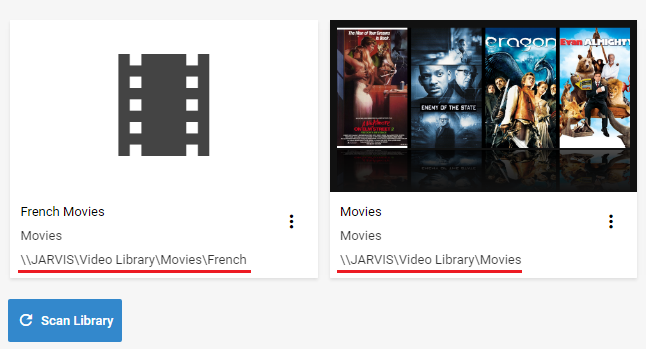

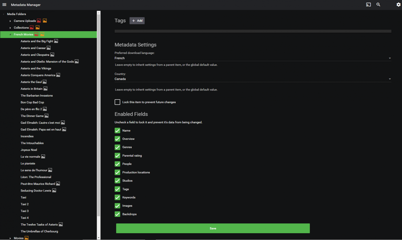

SilentStrike 1 Posted January 29, 2017 Author Posted January 29, 2017 I change the language at the library level in the metadata editor. And I refresh at the library level as well. I double-checked, and the files themselves have nothing. For episodes, we use the same regexes as Kodi so it's not surprising that you would need to adjust them. We have not yet gotten around to exposing that for configuration. It is something we'd like to do but it's not available at this point. Having said that I just played around a bit and found a regex that solves that without breaking any of our test cases, so in theory it might be possible to support out of the box. So if I understand correctly, right now it's not something that's possible.. But you think you might have found something that would work to easily be implemented to fix this?

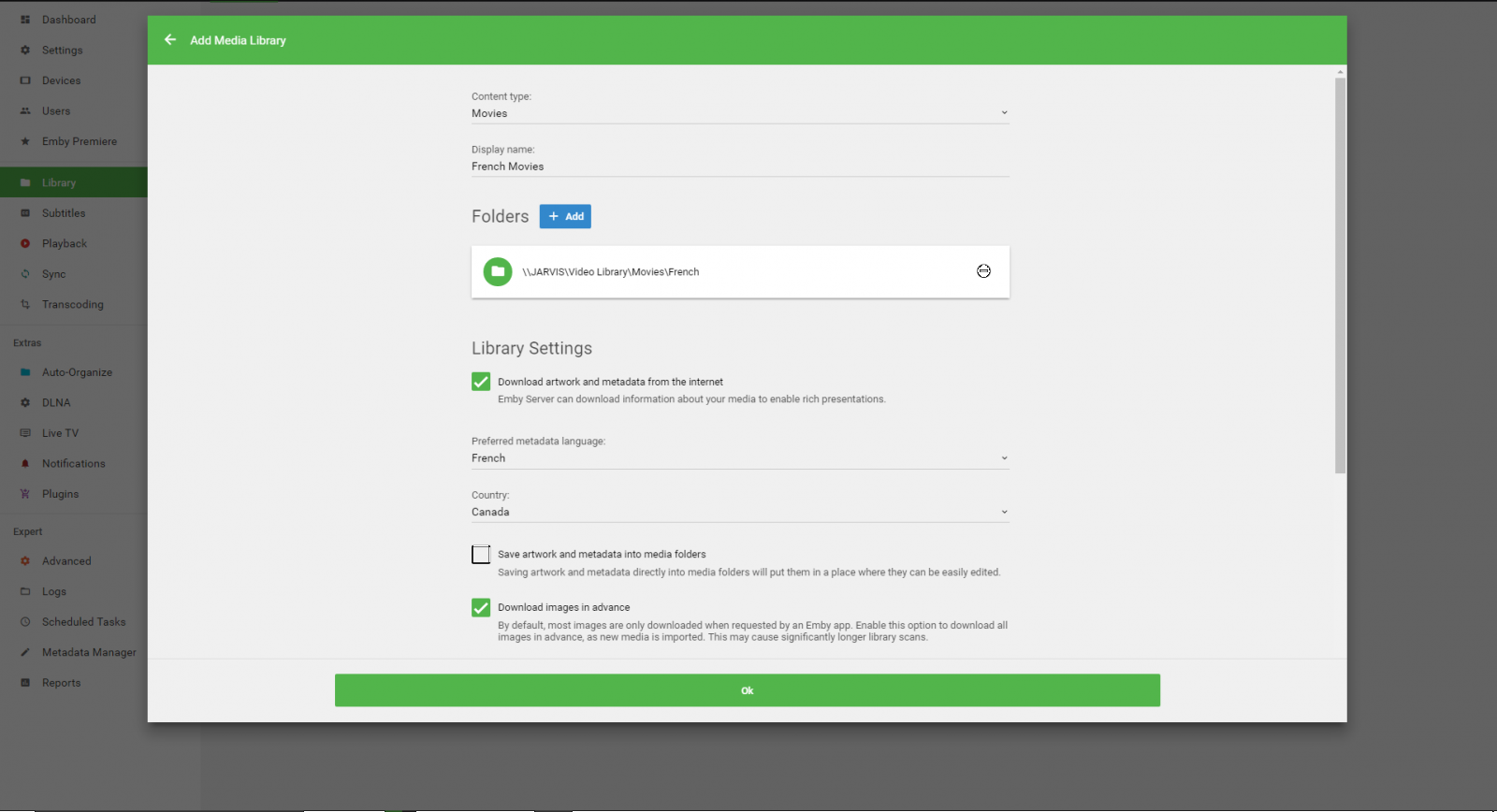

Luke 42197 Posted January 29, 2017 Posted January 29, 2017 Ok, with this release we have added per library language options in library setup. I need to reconcile that with the metadata manager. In the meantime, try setting it in server library setup.
SilentStrike 1 Posted January 29, 2017 Author Posted January 29, 2017 (edited) Tried from the library, and it doesn't work from there either. Everything is still in English. To be sure I'm adding from the right spot... And sorry for coming back on this... But I'm still trying to figure out what you meant with this statement.. "Having said that I just played around a bit and found a regex that solves that without breaking any of our test cases, so in theory it might be possible to support out of the box." Thanks for all your help! Edited January 29, 2017 by SilentStrike
Luke 42197 Posted January 29, 2017 Posted January 29, 2017 Make sure you didn't override with english at a lower level. to make sure, try configuring on the item directly, then refresh. And yes it means it might be possible to support that convention out of the box, but I am not sure yet.
SilentStrike 1 Posted January 29, 2017 Author Posted January 29, 2017 (edited) I tried putting French on the lower level. Then refreshed, and everything worked. That being said, I have English nowhere else. I rechecked the Library settings and it's indeed French there. Why would it fall back to English? It feels like a waste of time and effort to have to put the language setting on each item on the lower level. As for the possible support of that convention.. That's good news! Maybe? Haha. Let me know where that goes! Edited January 29, 2017 by SilentStrike

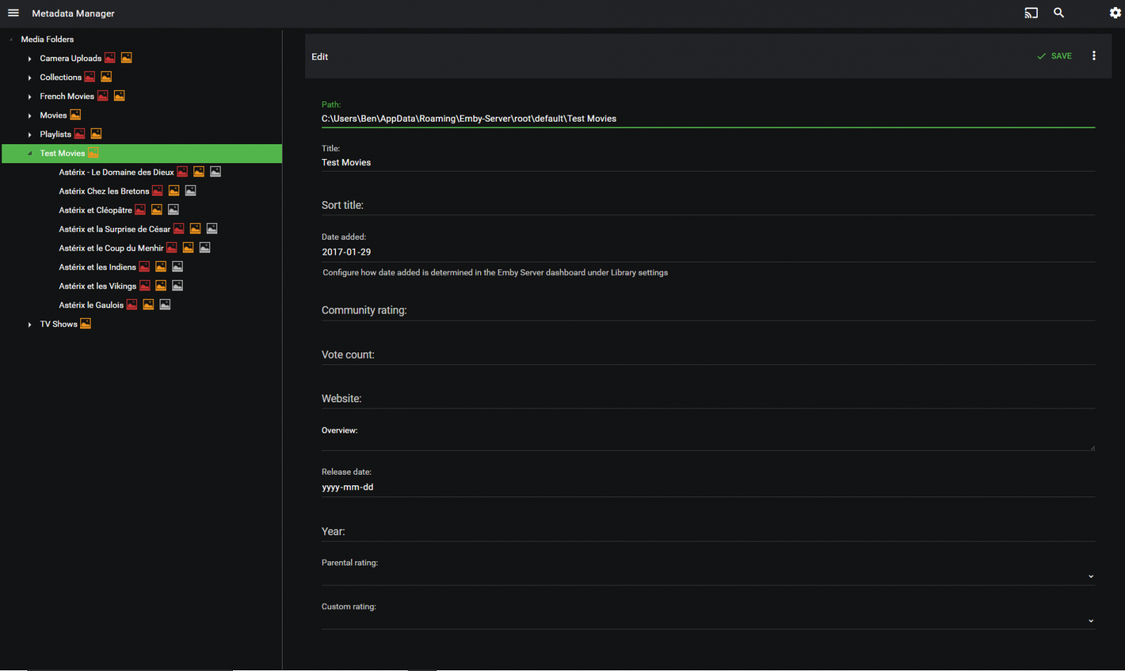

SilentStrike 1 Posted January 29, 2017 Author Posted January 29, 2017 (edited) Ok, so... I figured out what was going on with that test folder... If you remember... My test folder outside my movie folder had a single movie in it.. That screwed up the identifying of the movie for some reason. The metadata kind of used the folder name for some reason? I added movies, just to test the theory, and... Everything works fine.. That being said... It comes back to my original theory. I just posted in my last post that... I have English set nowhere else. But that folder IS a subfolder of another library. Another library that is set in English. Could it be that this is why the other library defaults to English instead of following with French like it should? Thanks again Luke. Edited January 29, 2017 by SilentStrike
Luke 42197 Posted January 29, 2017 Posted January 29, 2017 Yea I'm sure that's why. I'll have to look at that, thanks.
SilentStrike 1 Posted January 29, 2017 Author Posted January 29, 2017 No problem! Last thing I'll add about the subfolder issue, doesn't seem to be able to create a Primary Image when that's the case. Both "French" folders have the exact same content. One has a primary image, and the other doesn't.
