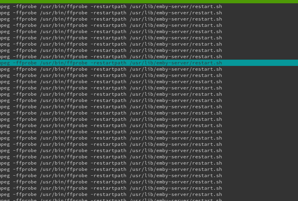

thejacer87 9 Posted January 28, 2017 Posted January 28, 2017 (edited) just upgraded to 3.1.287.0 beta, and still having this (what i assume is weird) issue where i have multiple instances of restart.sh being called. and they do NOT go away. looking at the processes shows them being active for 24 plus hours. process looks like this: /usr/bin/mono-sgen --optimize=all /usr/lib/emby-server/bin/MediaBrowser.Server.Mono.exe -programdata /var/lib/emby-server -ffmpeg /usr/bin/ffmpeg -ffprobe /usr/bin/ffprobe -restartpath /usr/lib/emby-server/restart.sh there are usually 2 or 3 of them, and sometimes when the cpu spikes, it appears to be bcuz of them. I could be wrong on their impact on the system. just posting what i see running the server on Linux AZ-3 3.2.0-4-amd64 #1 SMP Debian 3.2.84-1 x86_64 GNU/Linux Edited January 28, 2017 by thejacer87
Luke 42197 Posted January 28, 2017 Posted January 28, 2017 Please kill them, try to recreate the problem, then attach the emby server log. thanks.

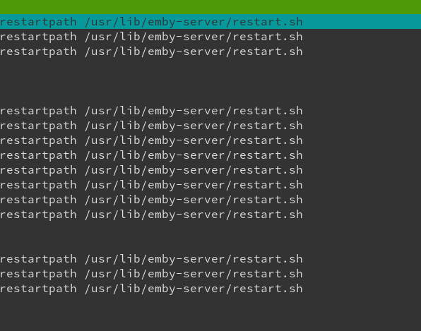

thejacer87 9 Posted January 28, 2017 Author Posted January 28, 2017 killed the processes... the server shutdown. called service emby-server start about 20 restart.sh processes fired i restarted the server from the dashboard... 3 processes showed up... Log.txt Log1.txt Log2.txt
Luke 42197 Posted January 28, 2017 Posted January 28, 2017 processes of what? those should not show up just from starting the server.
thejacer87 9 Posted January 28, 2017 Author Posted January 28, 2017 (edited) processes of what? those should not show up just from starting the server. the restart.sh process. run by the emby user Edited January 28, 2017 by thejacer87
thejacer87 9 Posted January 29, 2017 Author Posted January 29, 2017 when do they start showing up? As soon as the server turns back on

Luke 42197 Posted January 29, 2017 Posted January 29, 2017 What makes you think those are running processes? The server doesn't just start itself randomly. Is there an issue that you're experiencing?
thejacer87 9 Posted January 29, 2017 Author Posted January 29, 2017 What makes you think those are running processes? The server doesn't just start itself randomly. Is there an issue that you're experiencing? i see these processes when i run htop on the server. the issue, if any, is that these processes just popped up, after an update recently. a few weeks ago, i would have never have seen these processes listed. But the started popping up for unknown reasons. just seemed weird that they showed up. and sometimes, like i said in my original post, they spike the CPU usage
