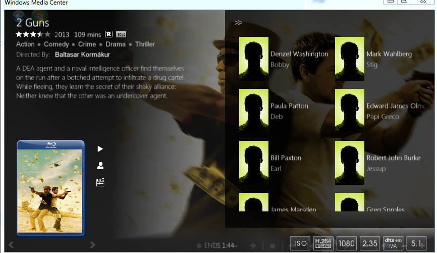

manutdsoc20 2 Posted February 1, 2014 Posted February 1, 2014 Hello All, I'm having an issue where my Images by Names pictures are not showing up in MBC 117. I'm assuming I'm doing something wrong. I've also attached the Server Log. Also attached are picutres showing examples and my IBN folder location. MBC 117 MBS Version 3.0.5144.26879 Here is a movie title 2 Guns which shows the actors with no pictures: Here is the IBN Folder location: Picture Showing IBN Folder Denzel W. with Picture: Thanks everyone for the assistance. Cheers Jason-manutdsoc20 server-63526787163.log

manutdsoc20 2 Posted February 1, 2014 Author Posted February 1, 2014 EBR I understand the picture I show is the web client and not MBC. The images for actors is not working in the web client or MBC as you can see in the attached picture. This was still not working on the last official release of the MB server. Are there any issues with have my IBN folder on my flexraid? Should I have the IBN folder on my c: drive? The only actor image that I have working I had to go into the web client choose the actor and upload the image from the IBN folder location. Thanks for the help. cheers manutdsoc20

Solution GhostRider 49 Posted February 1, 2014 Solution Posted February 1, 2014 Looking at the screenshot it showsDenzel Washington folder under ImagesByName\D\Denzel Washington I believe it should be under people i.e. ImagesByName\People\D\Denzel Washington 3
ebr 16354 Posted February 1, 2014 Posted February 1, 2014 Oooh - good catch Ghost. That is definitely the problem. Manut - How did those images get there?
manutdsoc20 2 Posted February 1, 2014 Author Posted February 1, 2014 EBR- I though all of it was created from Metabrowser. I did notice I had a People folder inside of the Images by Name Folder. Inside the people folder were all the actors folders, but I also had all the actors folders directly inside the Images by Name folder as well. I've had it this way for many years from my setup on MB 2 in which I had it working. I will clean up the Images by Name folder and make sure all the actors folders are inside the People folder. Should I be using MBS or Metabrowser to get the actors images? Lastly should MBS be pointing at the folder location Images By Name/People? Also does it need to be a UNC Path or a direct folder location? Thanks everyone for the help. cheers manutdsoc20
manutdsoc20 2 Posted February 1, 2014 Author Posted February 1, 2014 Just cleaned out the whole folder and started from scratch. I pointed MBS to \\MOVIESERVER\Drivers_software\mediabrowser\ImagesByName I downloaded the cast memebers for a couple of movies through Metabrowser. I refreshed People on MBS. Now I'm golden. Thanks EBR and Ghostrider for the assistance. You can mark this one as answered. cheers manutdsoc20
