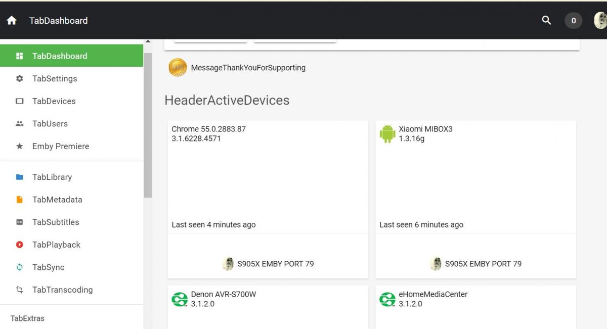

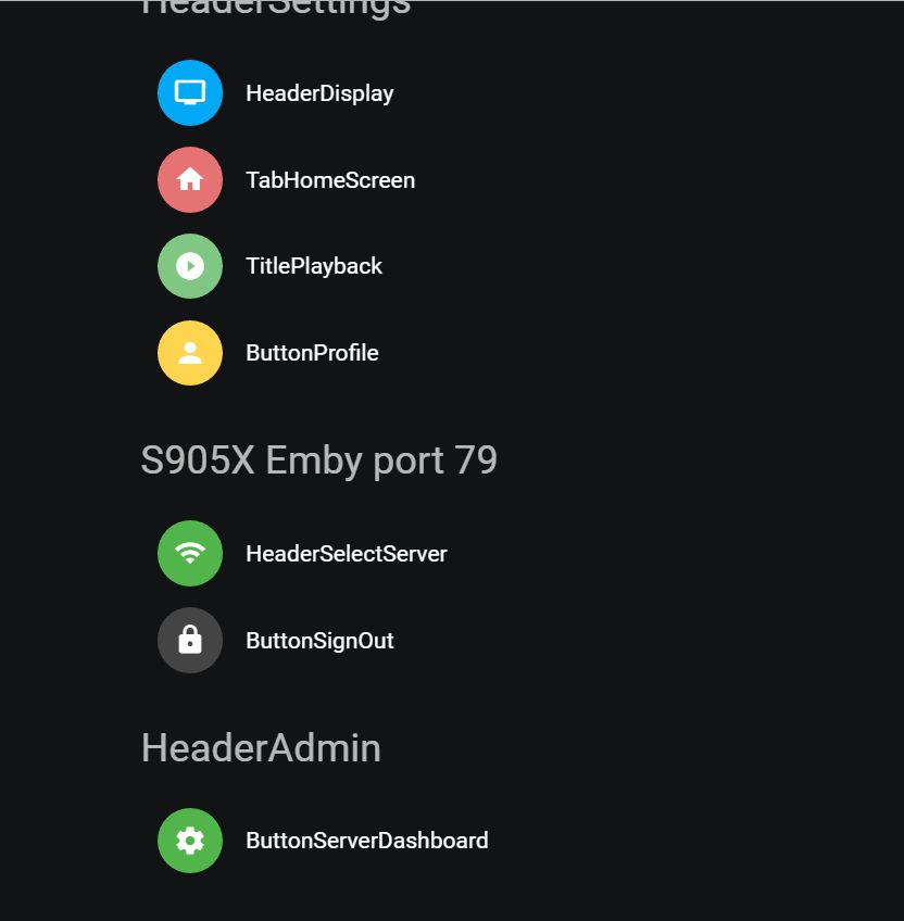

clarkss12 304 Posted January 23, 2017 Posted January 23, 2017 For some reason today, all my headings using the Emby link on my browser show weird names. It is the same on my Windows 7 and Window 10 computers. I am running the Emby server on 3 different devices, and it is the same on each server device. So the problem is something on your end. see the pics.

clarkss12 304 Posted January 23, 2017 Author Posted January 23, 2017 If you look at the heading "ButtonMore", I think that is something in your code that is causing that description. It wasn't like that yesterday or any day prior......... thanks.
