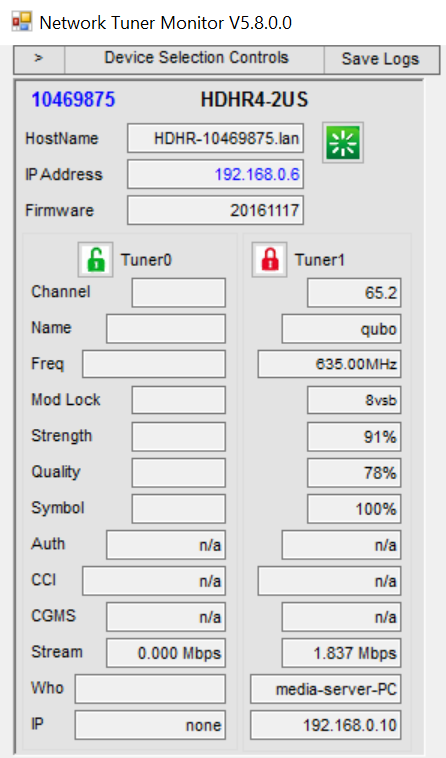

It is 7:43 PM and a recording on channel 65.2 that ended at 6:30 PM is still tuned and shows as an active recording.  The file is 288 MB in size, is not increasing, and does not show a time length using Mediainfo.
I think this sort of thing has happened before, but I am trying to include as much information as possible to assist in debugging.  Server and transcode logs are attached.
