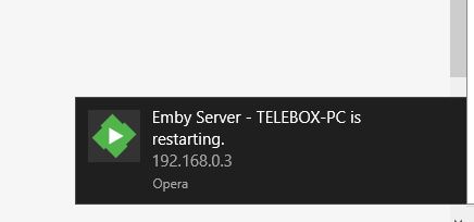

crocodillis 0 Posted January 19, 2017 Posted January 19, 2017 (edited) Hi having problems with server continuously restarting on its own all was good when I went to bed last night. This morning I go to log in and sever keeps restarting every 10 to 15 seconds I un installed the server and all residual files then I had problems trying to download again after 8 or nine tries I finally got it downloaded and reinstalled and am still having the same problem the server does not stay on long enough for me to look at the configuration and log files via the browser interface latest log and screenshots attached Update I uninstalled restart plugin and it has fixed the issue latest server log.txt Edited January 19, 2017 by crocodillis
Luke 43461 Posted January 19, 2017 Posted January 19, 2017 Try removing the ServerRestart plugin in case it's causing it.
ebr 16959 Posted January 19, 2017 Posted January 19, 2017 Update I uninstalled restart plugin and it has fixed the issue So, was this due to a configuration issue - like you had it scheduled every minute or something or had something gone haywire on its own?
Solution Luke 43461 Posted January 19, 2017 Solution Posted January 19, 2017 @@ebr, here is why 2017-01-19 08:34:13.5436 Info TaskManager: StartupTrigger fired for task: Scheduled Server Restart He setup a trigger to run the server restart on server startup. 1
crocodillis 0 Posted January 19, 2017 Author Posted January 19, 2017 Yep silly me as Luke said trigger to run the server restart on server startup which made it real hard to uninstall the plugin
