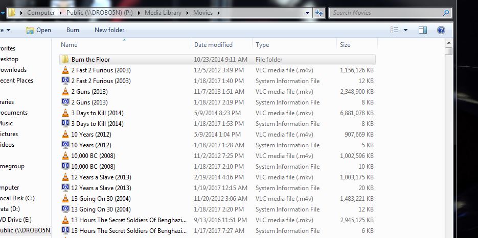

Luke 42197 Posted January 19, 2017 Posted January 19, 2017 @@Accomidus, if you're saying the video was never visible period, then I don't think we need to look at the logs. Instead, I would like to look at the folder structure and how you set it up in Emby. Would it be possible to take some screenshots of that? Thanks !

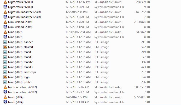

Accomidus 1 Posted January 19, 2017 Author Posted January 19, 2017 @@Accomidus, if you're saying the video was never visible period, then I don't think we need to look at the logs. Instead, I would like to look at the folder structure and how you set it up in Emby. Would it be possible to take some screenshots of that? Thanks ! Below is the SS of the top of my movies directory...all movies (past 2000, 1999 and below are in another directory for ease of searching) in the same directory. Mix of m4v and mkv (when I encoded them I forget to click mkv in handbrake (/blush)). 9 (2009) was right there before the 10000 movie (which does show up). Here is how the file looks now (and is showing up...the ONLY thing changed was from the number 9 to the word Nine). It can't look it up in TMDB but at least it sees it for me to edit it.

Koleckai Silvestri 1154 Posted January 19, 2017 Posted January 19, 2017 Yes it is possible. But if it did, it didnt show up in the library under a search for the term 9 or nine. Also (the reason I noticed it) there was no system information file created for it like all the other movies. There is a nine (2009).nfo file in your screenshot. It is the file with the computer and the exclamation mark since .nfo is also a type of Windows system file. So it was identified as something. The contents of the file should be XML and therefore text. Open the file in notepad and see what it has for the title.
Accomidus 1 Posted January 19, 2017 Author Posted January 19, 2017 (edited) There is a nine (2009).nfo file in your screenshot. It is the file with the computer and the exclamation mark since .nfo is also a type of Windows system file. So it was identified as something. The contents of the file should be XML and therefore text. Open the file in notepad and see what it has for the title. That didn't appear until I renamed the file to "nine (2009).m4v". When it was "9 (2009).m4v" it had no NFO file...that is how I knew it probably wasn't in the database. Edited January 19, 2017 by Accomidus
