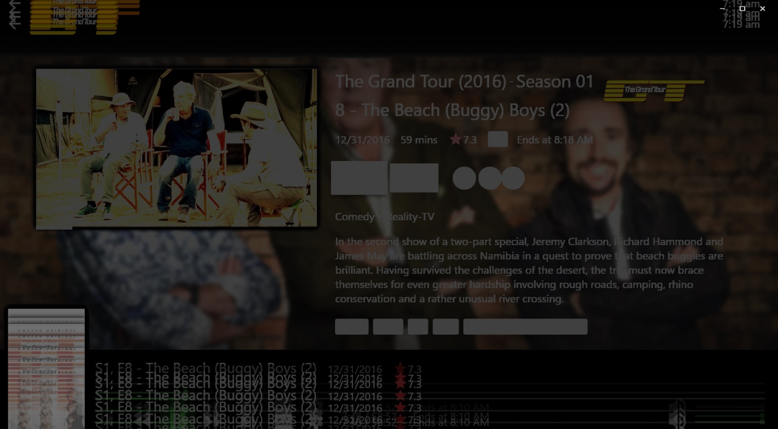

diaz1510 154 Posted January 16, 2017 Posted January 16, 2017 (edited) I'm on 2.5.36 Playing any media will start, the audio begins and the navigation bar behaves normally, but the video won't play, the detail page of the media file just stays on screen but dimmed. When the navigation bar times out and is supposed to become hidden, it just goes into some weird ghost image: ET is not usable for me at this point.Tried rebooting PC but it doesn't fix it. Any ideas on how I can fix this? Wondering if it's related to this issue: https://emby.media/community/index.php?/topic/42694-et-looses-any-way-to-exit-or-shutdown/ Edited January 16, 2017 by diaz1510
Gronnie 8 Posted January 16, 2017 Posted January 16, 2017 (edited) I am having this exact same problem as well. Tried restarting computer, restarting server, reinstalling Emby Theater, all with no effect. Playing through Web app and Chrome still works fine, so it seems to be only Emby Theater having issue with playback. I can hear the video starting to play in the background, but the Emby Theater interface stays up and not the video player. Edited January 16, 2017 by Gronnie
jpnassau 0 Posted January 16, 2017 Posted January 16, 2017 Encountering the same issue. There are no errors in the log so I can only assume there is a problem with this version. Would be nice if there was an easy way to revert back to the previous version when this happens.
Schimi 26 Posted January 16, 2017 Posted January 16, 2017 same here... deleted system folder and renamed system.old to system
Rumbaar 13 Posted January 16, 2017 Posted January 16, 2017 Same issue too, I tried on two movies and it went like this.

Luke 42243 Posted January 16, 2017 Posted January 16, 2017 Try grabbing 2.5.37 from the website. thanks.

diaz1510 154 Posted January 17, 2017 Author Posted January 17, 2017 2.5.37 fixed the issue...thanks @@Luke

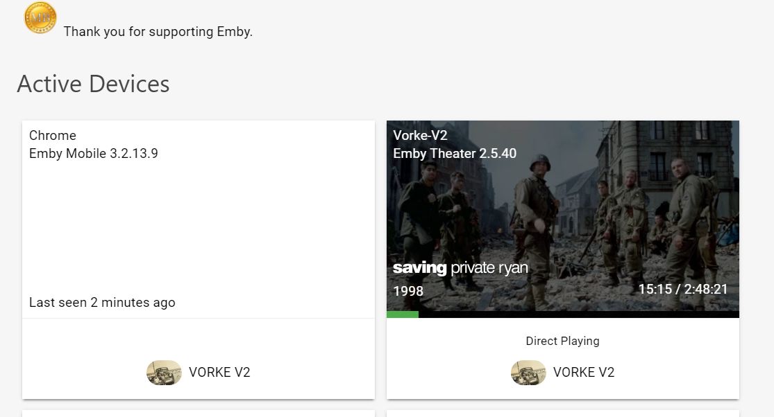

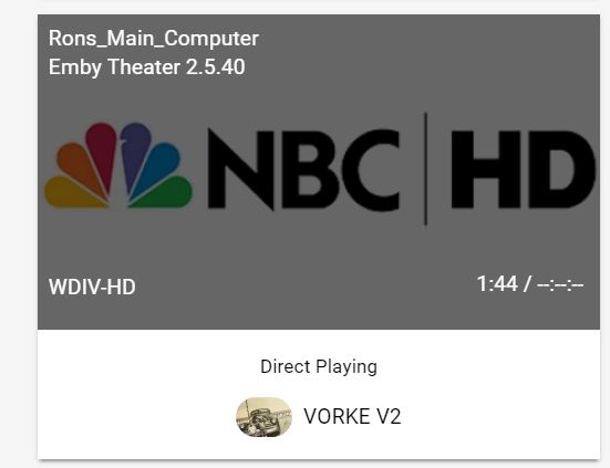

clarkss12 304 Posted May 1, 2017 Posted May 1, 2017 Tested your newest Emby Theater using my Vorke V2 (Windows 10) as my Emby server. Played my BlueRay rip of "Saving PVT Ryan" on my Samsung 4K TV, and Denon AVR, with my Vorke V2 as my Emby client/ server. Played very well using "Direct Playing". My AVR was showing Mulit In, instead of "DTS-HD Master Audio", but it played very well. At the same time, I was playing a live HD TV stream on my Windows 10 Desktop computer, again, it played very well with (Direct Playing).
