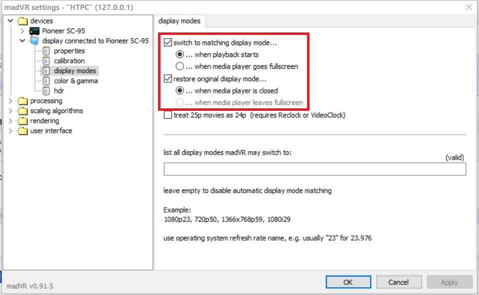

pclausen 44 Posted February 22, 2017 Posted February 22, 2017 I'm having this same issue. After playing a BRD title, my desktop refresh rate has been changed from 60hz to 23hz. If I then attempt to play a 60hz TV episode, ET will hang and I have to do a ctrl-alt-delete, kill ET, then go to NVIDIA control panel and change the refresh rate back to 60hz. Then start ET again to watch my TV episode. I have a GTX 1070 and have the madVR settings pretty much maxed out. I'm rendering to a 4k display. I have ET set to NOT change monitor refresh rate to match video. I do this within the madVR settings, which I understand to be best practice. There are also times when madVR leaves the desktop refresh rate at 59Hz. This typically required a reboot of the whole HTPC to recover. If I disable madVR altogether, these issues all go away, but I much prefer the picture quality with it enabled. Here are my display mode settings: Any ideas?
Guest asrequested Posted February 22, 2017 Posted February 22, 2017 (edited) It's actually better to set your GPU refresh rate to 59Hz. 60Hz is fine, but 59Hz is closer to the natural rate of a computer display. This may also have something to do with your TV. If madVR is reverting back to 59Hz, try setting your GPU to that, maybe there's a conflict? Also, is there a particular rate that causes this? Edited February 22, 2017 by Doofus
pclausen 44 Posted February 22, 2017 Posted February 22, 2017 My TV displays a rock solid 3840 x 2160 desktop at 23, 24, 59 or 60Hz. I'll try setting it to 59 Hz, but I suspect that will make playback of 60Hz material fail. Most of the time madVR is reverting back to 23Hz on my desktop (from the 60Hz default), upon exiting playback of 23.976Hz material. It should be reverting back to the original refresh rate of 60Hz I would think. Playback of any of my BRD titles, which are all 23.976Hz causes my desktop refresh rate to be reset to 23Hz. As long as I keep playing back movies within ET there are no issues. It is when I decide to watch a TV show after watching a movie this issue occurs and I have to exit ET, change the refresh back to 60Hz in the Nvidia control panel, then fire ET back up.
