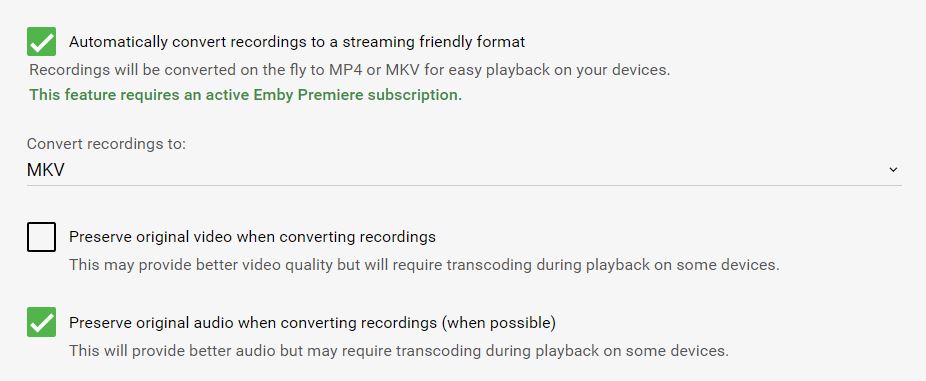

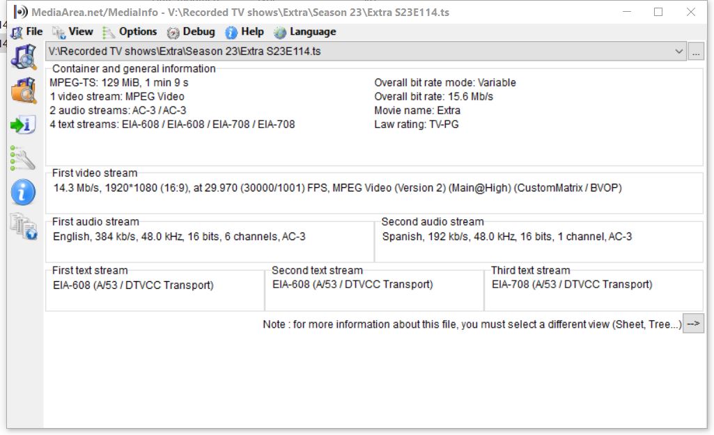

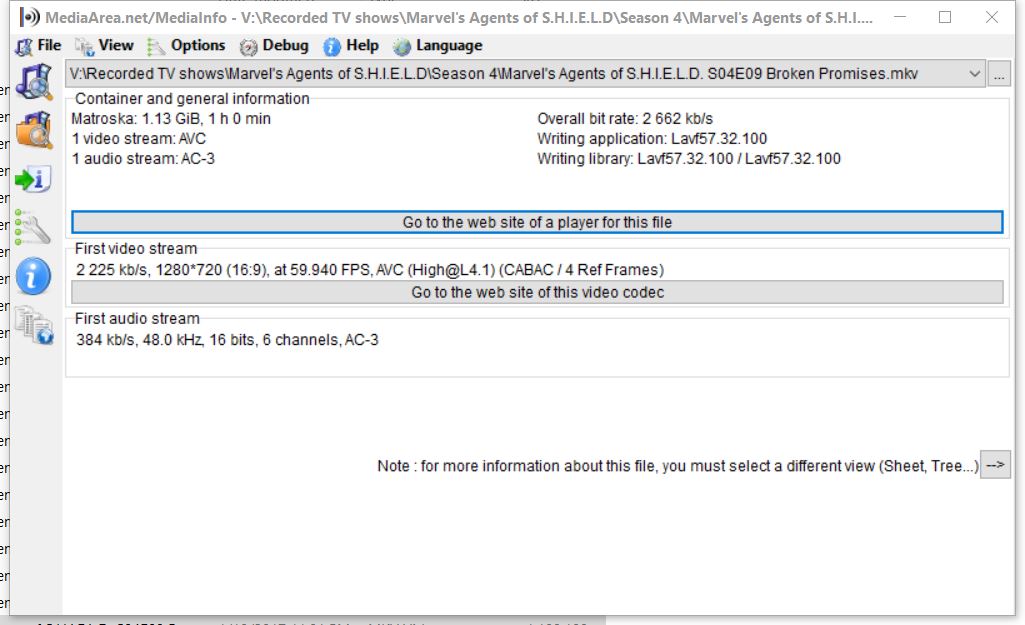

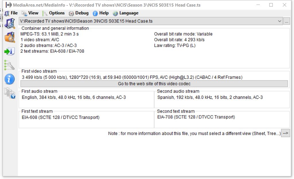

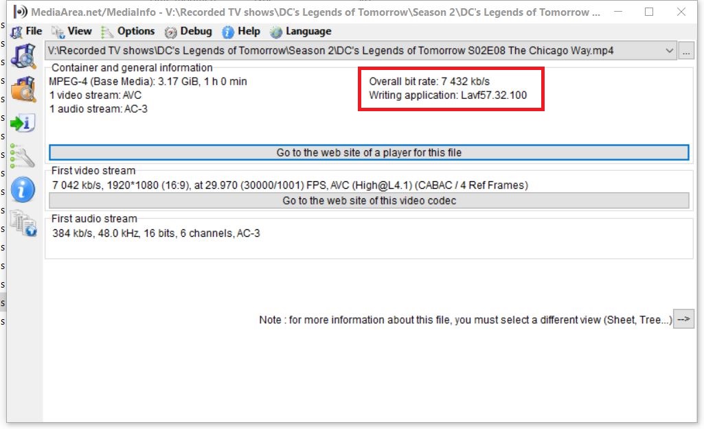

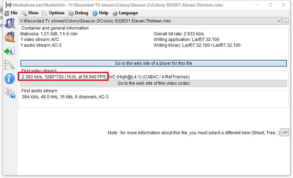

Guest asrequested Posted January 15, 2017 Posted January 15, 2017 No but what is the issue with 25mbps? I bet it is probably a higher bitrate than the source feed. That is a nice bandwidth. Here's a question. To test, I just recorded a little of two different shows (uncompressed) to look at the bitrates. One show was already broadcast in h.264 and the other was Mpeg2. The bitrates are significantly different. Would it be worth adding an option to not compress streams that already are compressed? Maybe analyze the stream and only compress Mpeg2?
Guest asrequested Posted January 15, 2017 Posted January 15, 2017 (edited) Granted that the smaller of the two is only 720p, but they are also at two different frame rates. Mpeg2 at half the frame rate still has a much larger bitrate. Maybe just remux them to the container that is selected? Edited January 15, 2017 by Doofus

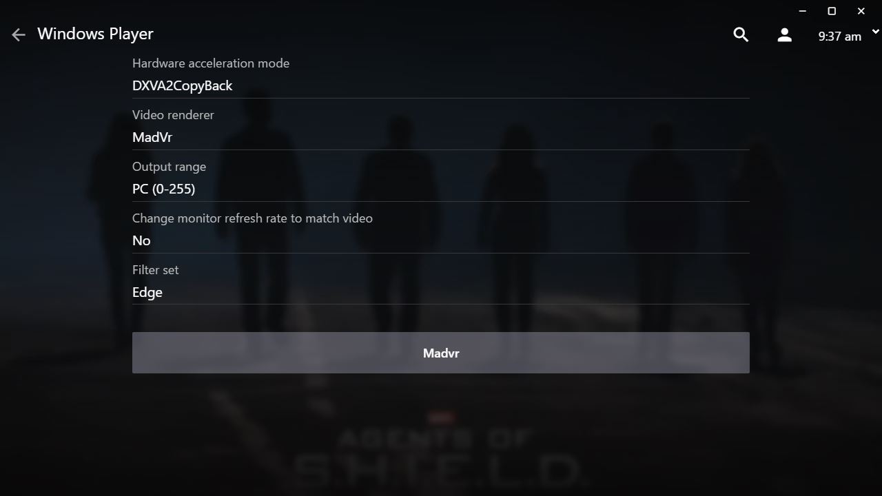

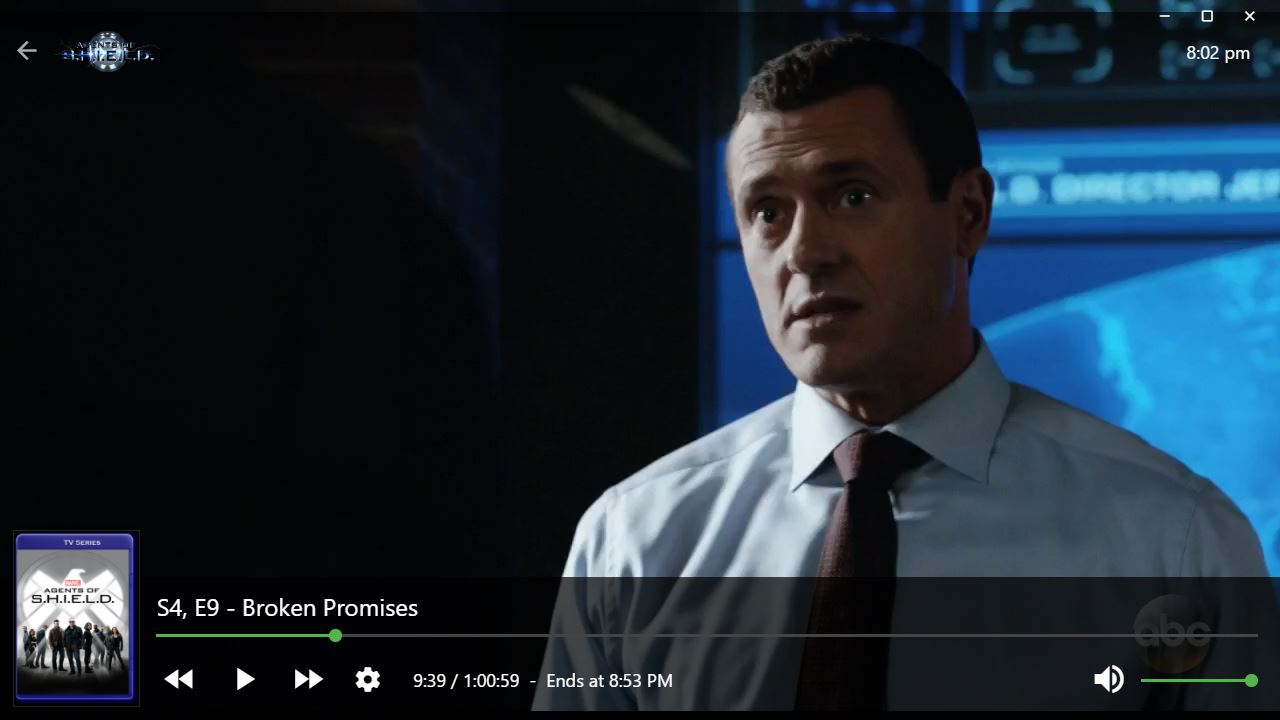

Guest asrequested Posted January 15, 2017 Posted January 15, 2017 (edited) Heh, read the thread Great, thanks! What settings are you talking about? Your TV, GPU or filter settings for playback. You may have them set too bright and too sharp. This recording, was made with these recording settings My playback experience is very good, indicating that the compression is also very good. Oh just an arbitrary number. Something higher than 3mbps for 720p / 5mbps for 1080p (I assume it deinterlaces 1080i on transcode, maybe not). 10mbps would be fine tbh. Looking at the bitrate used in my recording, we can see that it is a little lower than 3Mb/s, and playback results in great picture quality, no blocking in the black areas, or anywhere. I use Theater for windows desktop with madVR for my filter, as it yields better results. Can you please provide more information on what your tv source is, what you are using for playback, what filter you are using, what your filter settings are, what GPU you are using and any other pertinent information? I may be able to help you resolve your issue. Edited January 15, 2017 by Doofus

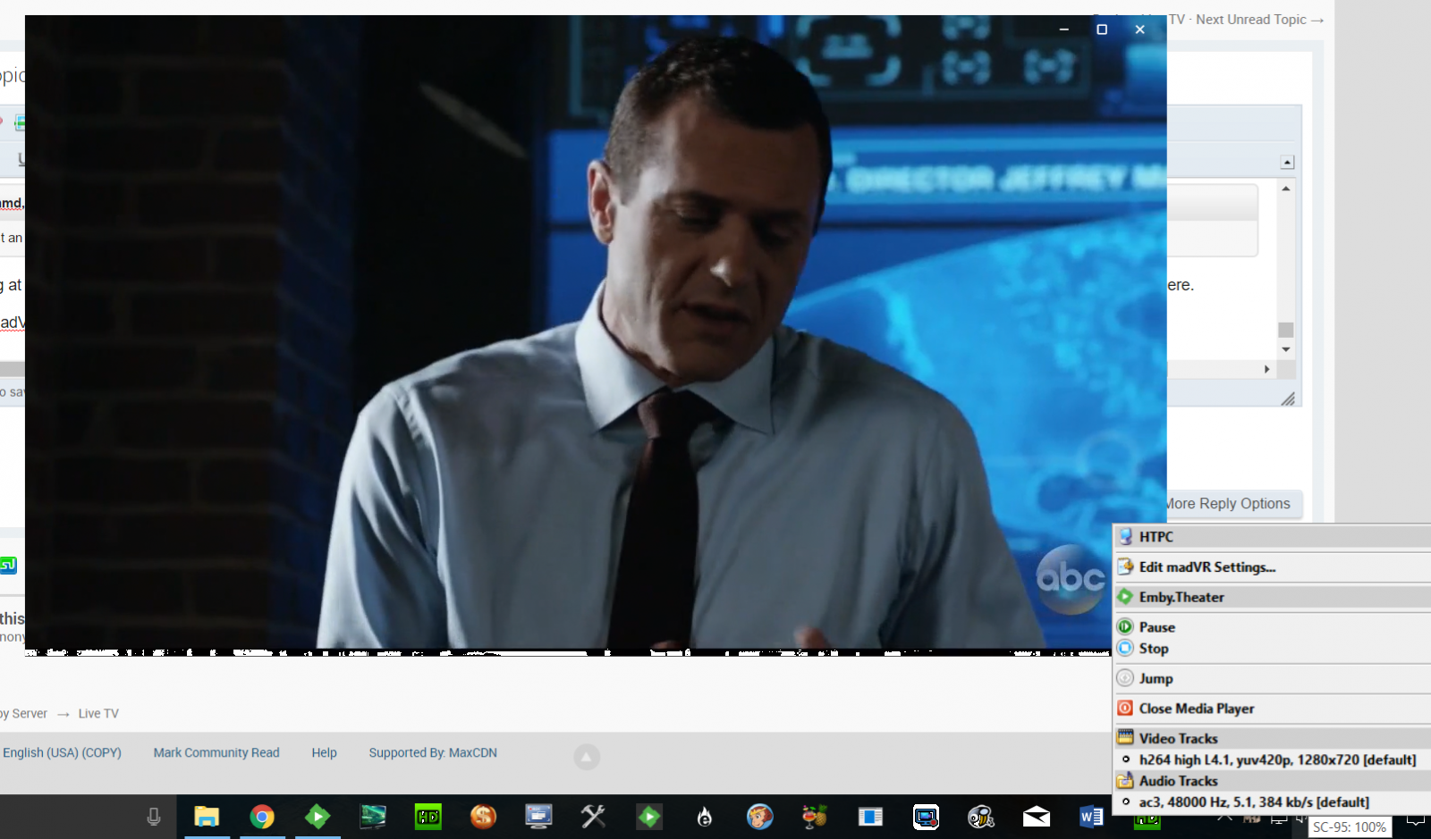

lifespeed 42 Posted January 16, 2017 Posted January 16, 2017 Doofus, dumb question but how do you access that menu in the lower left of your screenshot with MadVR, play, stop and other functions?
Guest asrequested Posted January 17, 2017 Posted January 17, 2017 Doofus, dumb question but how do you access that menu in the lower left of your screenshot with MadVR, play, stop and other functions? If you are using madVR as your filter and you window ET, madVR should be in your system tray. Just click on it and it should pop up.
lifespeed 42 Posted January 17, 2017 Posted January 17, 2017 If you are using madVR as your filter and you window ET, madVR should be in your system tray. Just click on it and it should pop up. Not for me, Windows 10 64-bit.
Guest asrequested Posted January 17, 2017 Posted January 17, 2017 Not for me, Windows 10 64-bit. What does that mean? I'm using Windows 10 64 bit, too
lifespeed 42 Posted January 17, 2017 Posted January 17, 2017 What does that mean? I'm using Windows 10 64 bit, too I don't have madvr icon in the system tray.

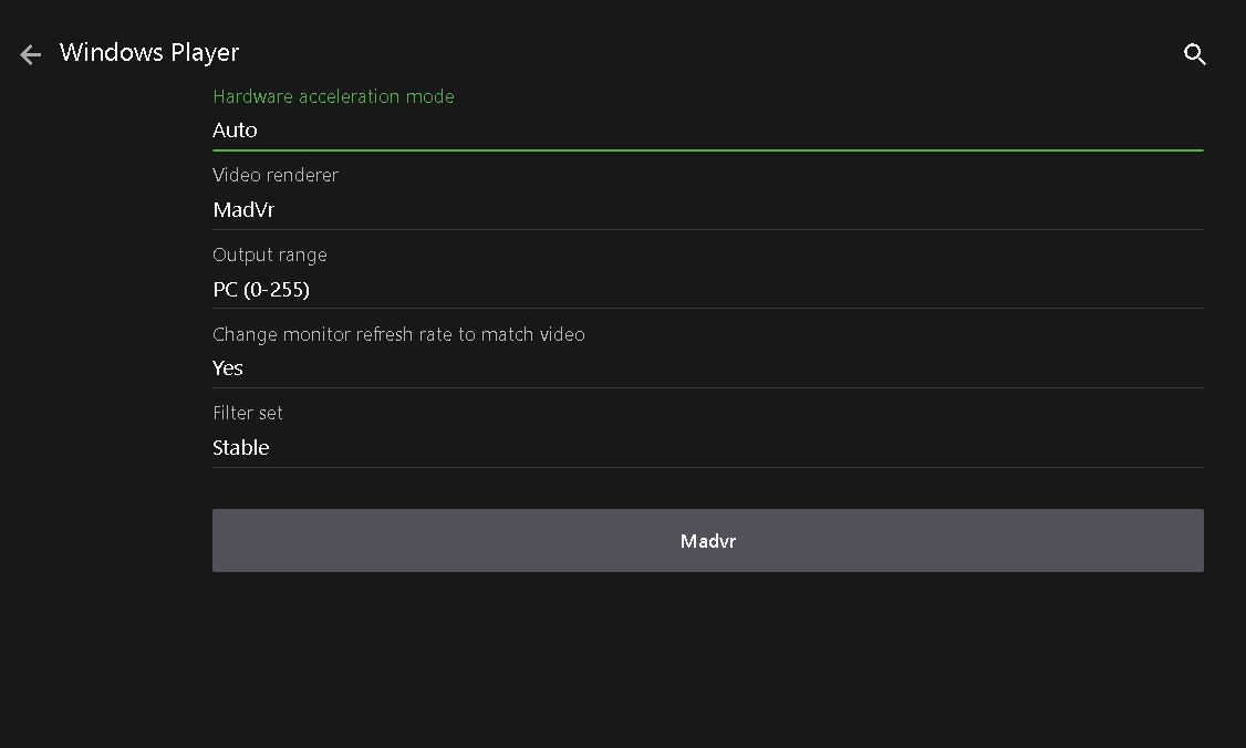

Guest asrequested Posted January 17, 2017 Posted January 17, 2017 Then you must not have MadVR enabled. When playing a video, the icon should be there. How do you have your video settings configured?
lifespeed 42 Posted January 17, 2017 Posted January 17, 2017 Then you must not have MadVR enabled. When playing a video, the icon should be there. How do you have your video settings configured?
Guest asrequested Posted January 17, 2017 Posted January 17, 2017 OK, good. So when playing a video and you click on the tray (to expand it) the madvr icon isn't present?
lifespeed 42 Posted January 17, 2017 Posted January 17, 2017 OK, good. So when playing a video and you click on the tray (to expand it) the madvr icon isn't present? Correct. But MadVR clearly is working as shown by the difference in viewing broadcast TV at 1080i, the jaggies are horrible without it.
