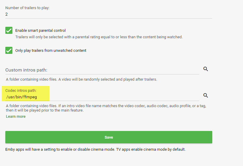

techworld 3 Posted January 14, 2017 Author Posted January 14, 2017 (edited) Hi, I installed Emby manually in OMV. ffmpeg is located at: /usr/bin/ffmpeg /usr/share/ffmpeg /usr/share/man/man1/ffmpeg.1.gz ls -la /usr/bin/ffmpeg -rwxr-xr-x 1 root root 268616 Dec 23 11:27 /usr/bin/ffmpeg Do I need to symlink emby's ffmpeg folder to /usr/bin/ffmpeg? :/var/lib/emby-server$ ls -la total 68 drwxr-xr-x 15 emby emby 4096 Jan 1 19:53 . drwxr-xr-x 54 root root 4096 Jan 1 12:20 .. drwxr-xr-x 6 emby emby 4096 Jan 14 11:24 cache drwxr-xr-x 4 emby emby 4096 Jan 14 15:55 config drwxr-xr-x 3 emby emby 4096 Nov 19 16:18 .config drwxr-xr-x 7 emby emby 4096 Jan 14 16:00 data drwxr-xr-x 3 emby emby 4096 Nov 19 16:13 ffmpeg drwxrwxr-x 2 emby emby 4096 Jan 1 19:53 fonts drwxr-xr-x 2 emby emby 4096 Dec 28 17:33 localization drwxr-xr-x 2 emby emby 4096 Jan 14 16:00 logs drwxr-xr-x 6 emby emby 4096 Nov 24 17:00 metadata drwxr-xr-x 2 emby emby 4096 Nov 19 23:26 plugins drwxr-xr-x 3 emby emby 4096 Nov 19 16:14 root drwxr-xr-x 2 emby emby 4096 Jan 4 18:19 ssl drwxr-xr-x 2 emby emby 12288 Jan 14 11:14 transcoding-temp Edited January 14, 2017 by techworld
Happy2Play 9802 Posted January 14, 2017 Posted January 14, 2017 (edited) That is for Intros not FFMPEG you need to look a Trascoding (FFmpeg path:) not Playback-Cinema Mode. Edited January 14, 2017 by Happy2Play

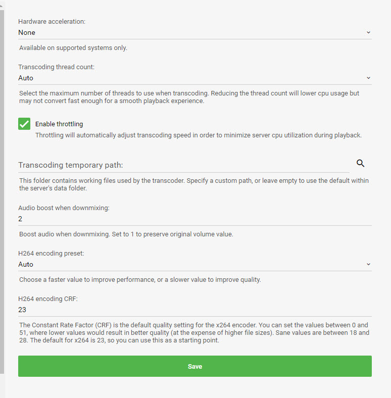

techworld 3 Posted January 14, 2017 Author Posted January 14, 2017 So I need to put /usr/bin/ffmpeg in Transcoding Temporary path?
Luke 42197 Posted January 14, 2017 Posted January 14, 2017 Why don't we help each other at the same time. Can you please read the help text under the input fields and explain why you thought you'd want to put the executable path to ffmpeg in that field?
Happy2Play 9802 Posted January 14, 2017 Posted January 14, 2017 I don't think your OS server version has this option if I remember correctly from other topics.
