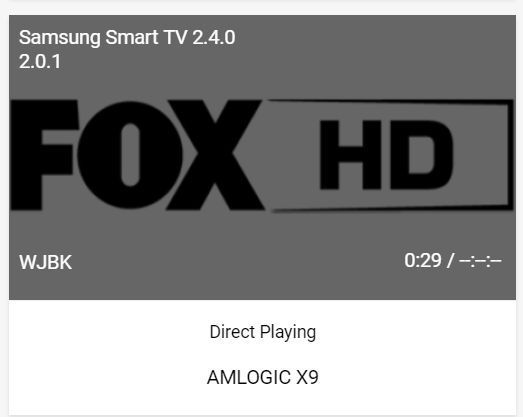

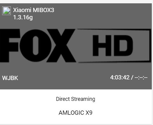

clarkss12 304 Posted January 13, 2017 Posted January 13, 2017 This is a very interesting conversation, got me to looking. Found that running the Live TV on my inexpensive Android cell phone (Qualcomm MSM8975AC Snapdragon 801) uses the "Direct Playing" and it is working perfectly. However, playing the same live TV on my Mi Box, it uses "Direct Streaming", and it buffers all the time. I am using my $40 Linux box for my Emby server, and everything is connected via gigabit Ethernet and Ethernet switches, except my cell phone that is connect to the 2.4GHZ network. I would think the opposite would apply, but guess not. Switched over to running the same live TV channel (720P) running the Emby app on my 2016 Samsung TV. It is playing using "Direct Playing", but is playing very well with no buffering. Ran another test, this time using my cell phone connected via 4g cell data. Had to use my Emby server running on my $100 Tronsmart Windows 10 microPC, because I have not set up my Linux box to use the 4g yet. Anyway, using the Emby app on my cell phone connected to my cellular 4g connection, my live stream (720P) again plays very well, and it is using (Direct Playing). One more piece of info concerning streaming over my cellular 4g connection, my internet connection is 75G up and 15G down.
Happy2Play 9811 Posted January 13, 2017 Posted January 13, 2017 Only your log will show why the MIBox is Direct Streaming. my internet connection is 75G up and 15G down We all wish.
