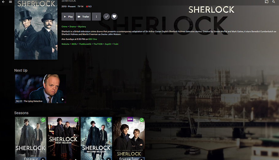

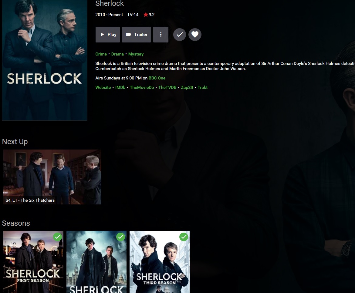

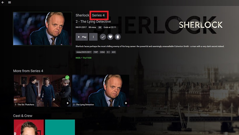

WhyNotPurple 0 Posted January 12, 2017 Posted January 12, 2017 (edited) EDIT: a fix for this issue: The solution is to 'refresh' the season by selecting it from the season's options (the three dotted button). This can probably also be done by 'refreshing' a whole show instead of just a single season.I have had this problem for some time now, hoping with each new update that it might be resolved. What happens is that whenever a new season of a series starts and I add episodes of that season to the folders monitored by Emby, those episodes show up in Emby as unwatched, but their season does not show up on the page of the series in Emby. For example, I recently added the two new episodes for the 4th season of Sherlock. I can only get to this page by clicking the unwatched episode from the "next up" section: But then when I go to the show overview page of Sherlock, it looks like this, without any poster for the fourth season: This is true for every show that has new episodes of a new season added. I run Emby Version 3.1.2.0 on Windows 10 x64 Pro. I use flattened folders (i.e. all episodes of a show in a single folder). I have attached the most recent log, which includes the log of a library scan. The only way I seem to be able to fix this is by removing the show from Emby, moving the files of that show to a folder that is not monitored, running the Emby Library Scan, moving the files back, and running the library scan again. Is there a way to fix this issue? Or a way for me to fix this for multiple shows at a time? Edited January 13, 2017 by WhyNotPurple

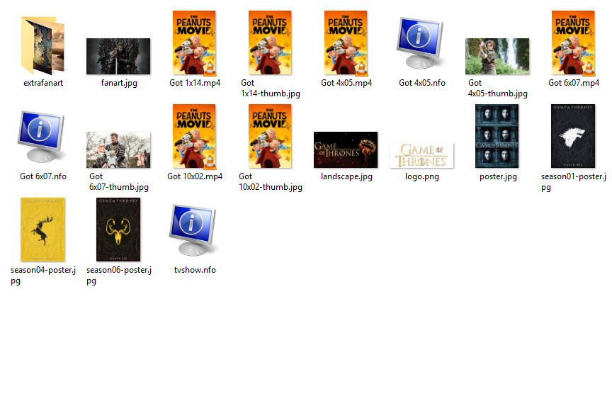

Luke 42197 Posted January 13, 2017 Posted January 13, 2017 I tested this and I'm not seeing any problems. Here's my sample series folder Initially I just started out with the season 1 and season 10 files. Then after the new library scan was completed, then i added the season 4 and season 6 files, one at a time. I even made sure the realtime monitor created everything so that a full library scan was not needed after adding the new episodes. Quick question. When was your Emby Server first installed?

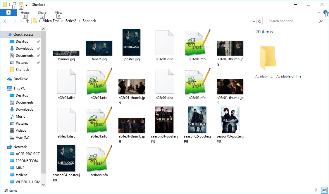

Happy2Play 9802 Posted January 13, 2017 Posted January 13, 2017 I replicated on my portable stable Added Sherlock with episodes s01e01, s02e01, s03e01 started server and Emby Identified everything then added S04e01 and no season displayed Haven't refreshed season yet.
Happy2Play 9802 Posted January 13, 2017 Posted January 13, 2017 Yesterday. To me this new season isn't getting metadata as this screenshot is missing release date metadata. That is the only difference comparing to Season 3.
Happy2Play 9802 Posted January 13, 2017 Posted January 13, 2017 Refreshing that season populates release date and season shows properly.
Happy2Play 9802 Posted January 14, 2017 Posted January 14, 2017 (edited) @@Luke One step forward and two steps back. New/current season added properly but previous seasons don't get images. Starting from scratch Add series with episode s01e01, s02e01, and s03e01 library scan No season images or episode images added episode s04e01 Version 3.1.6223.5529 dev Edited January 14, 2017 by Happy2Play
Luke 42197 Posted January 14, 2017 Posted January 14, 2017 hmm, i don't see that. i tested with dexter and it got all season images.
Happy2Play 9802 Posted January 14, 2017 Posted January 14, 2017 Hmm, something in that portable every though it was created today, but adding to installed dev and worked as expected only difference is it is on "Legacy" image saving.
