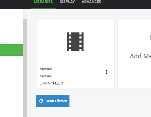

Tackyou 0 Posted January 11, 2017 Author Posted January 11, 2017 (edited) Well then I have a different problem. The portable version doesn't seem to work with network shares or more specifically Netdrive2. I had it working before with Emby installed via setup.exe Maybe it's not caused by the portable version but by an update made to the Emby Server, I read that there was a big update making scanning faster etc. However when I add a network location or local drive mounted via Netdrive2 now it doesn't scan it like the folder would be empty. I didn't use Emby in some time so maybe this problem was introduced with recent updates. Edited January 11, 2017 by Tackyou
Luke 42197 Posted January 11, 2017 Posted January 11, 2017 They will be the same in that regard. Please provide the Emby Server log. You can learn how to do that here: https://emby.media/community/index.php?/topic/739-how-to-report-a-problem/ Thanks.
Tackyou 0 Posted January 11, 2017 Author Posted January 11, 2017 I removed all libraries, enabled debug logging and restarted the server. Then added the movie library and pressed scan button. Log is attached, can't see any useful information in there. We can Teamviewer if you want so you can take a look at this odd problem yourself. server-63619765788.txt
