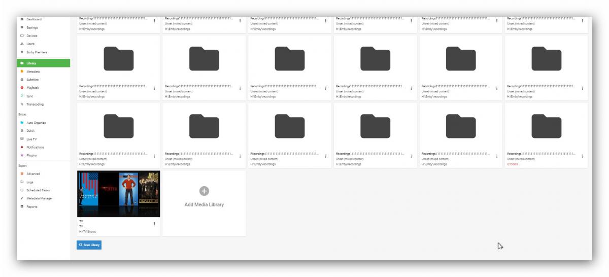

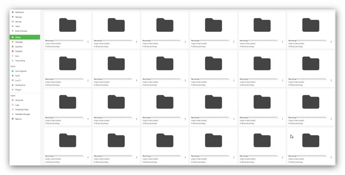

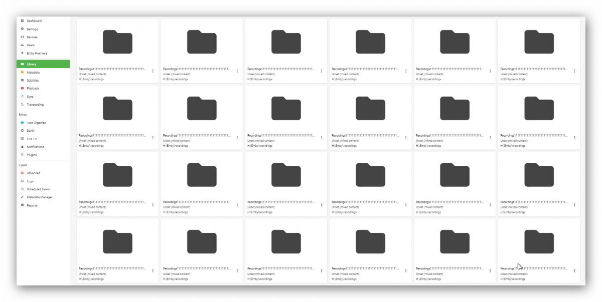

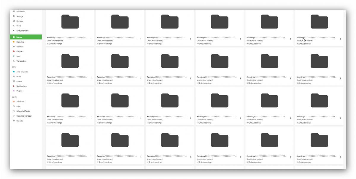

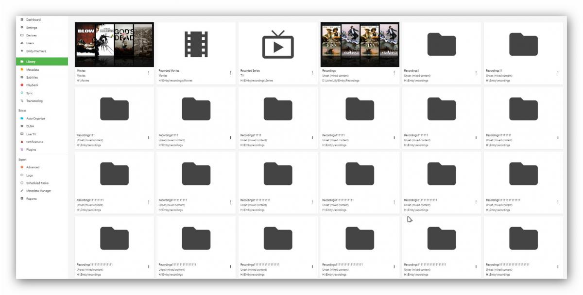

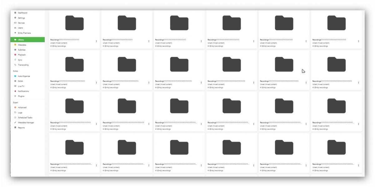

Luke 43461 Posted January 10, 2017 Posted January 10, 2017 @@freeindeed can you please capture a screenshot of your live tv settings, along with your library setup and post them both here? thanks !
freeindeed 0 Posted January 11, 2017 Author Posted January 11, 2017 Attached Library 1-7 and Live TV settings per request. Thank you.
