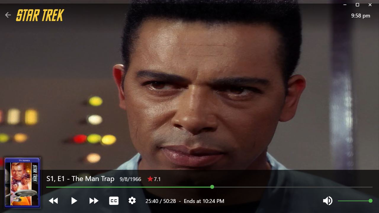

Ray 4 Posted January 8, 2017 Posted January 8, 2017 Before I go looking for the logs, is there a setting I'm missing in the upgrade? Since I only have a Harmony remote normally connected to the TV I'm hoping it's user error with a quick-fix rather than needing to gather a lot of detail. All of my 1:1.85 and 1:2.39 movies are stretched vertically, and all of my old 4:3 TV shows are stretched horizontally. Everything is forced to fill the screen at 16:9. Three days ago everything played well. Either yesterday or they day before, something changed. The TV wasn't used much before today, so I can't narrow down the time window any more accurately than that. It is just the Emby Theatre though. Playing in the web browser still plays normally. Playing on the iOS app also keeps proper aspect ratio still. If I could get VLC to work with the time tracking for Resume, I'd just switch. With a toddler in the house, resume on any device is the best feature in Emby for me. Windows 10 Pro x64 Emby Theatre 2.5.34

Ray 4 Posted January 8, 2017 Author Posted January 8, 2017 The only thing I changed is Hardware Acceleration from Intel Quick Sync (which was where it was and working fine for months) to None and Auto to see if it fixed it. Video Renderer has always been on Auto. Output Range is set as PC (0-255) Change monitor refresh rate to match video is set to No Filter set is Stable. Otherwise the Theatre app is pretty much just set using the defaults for all settings.
Guest asrequested Posted January 8, 2017 Posted January 8, 2017 (edited) It's EVR+ I was just testing this. On auto, it's stretched. On EVR, it's fine. On EVR+, it's streatched. Edited January 8, 2017 by Doofus 1
Luke 42243 Posted January 8, 2017 Posted January 8, 2017 Ok, thanks. The scaling fix that was made should only be applied to Evr and not Evr+. We'll get an update out to resolve that. Thanks. 1
mentasm 43 Posted January 8, 2017 Posted January 8, 2017 I think I was seeing the same thing. I switched from Auto to MadVR and the problem went away
Ray 4 Posted January 9, 2017 Author Posted January 9, 2017 I changed from Auto to MadVR and the video problem is gone. Thank you for the help on that. I was hoping for a quick fix so I didn't have to go buy batteries to be able to connect the keyboard again.
