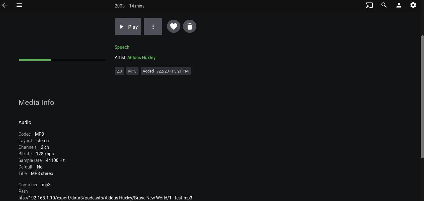

Luke 42245 Posted January 16, 2017 Posted January 16, 2017 I'm not able to reproduce this. Are you sure the detail screen shows the media info with the runtime? can you show a screenshot of that? thanks.
xarath 4 Posted January 20, 2017 Author Posted January 20, 2017 In versions 3.1.279.0 beta and 3.1.278.0 beta, I don't have the option to Resume from anymore...
