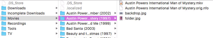

taylorbourne 19 Posted January 5, 2017 Author Posted January 5, 2017 Ok disabled the Real Time Monitoring and the Download Images in Advance options – currently in the process of a rescan. So far seems like the same thing is happening.. So for example this error: 2017-01-05 14:55:23.1545 Error ProviderManager: Error in metadata saver *** Error Report *** Version: 3.1.2.0 Command line: /Applications/Emby.Server.Mac.app/Contents/MonoBundle/Emby.Server.Mac.exe Operating system: Unix 15.4.0.0 64-Bit OS: True 64-Bit Process: False Mono: 4.6.2 (mono-4.6.0-branch/08fd525) Processor count: 2 Program data path: /Users/Taylor/.config/emby-server Application directory: /Applications/Emby.Server.Mac.app/Contents/MonoBundle System.UnauthorizedAccessException: Access to the path "/Users/Taylor/Media/Movies/Austin Powers International Man of Mystery (1997)/Austin Powers International Man of Mystery.nfo" is denied. at System.IO.FileStream..ctor (System.String path, System.IO.FileMode mode, System.IO.FileAccess access, System.IO.FileShare share, System.Int32 bufferSize, System.Boolean anonymous, System.IO.FileOptions options) [0x0025f] in <8f2c484307284b51944a1a13a14c0266>:0 at System.IO.FileStream..ctor (System.String path, System.IO.FileMode mode, System.IO.FileAccess access, System.IO.FileShare share, System.Int32 bufferSize) [0x00000] in <8f2c484307284b51944a1a13a14c0266>:0 at (wrapper remoting-invoke-with-check) System.IO.FileStream:.ctor (string,System.IO.FileMode,System.IO.FileAccess,System.IO.FileShare,int) at Emby.Common.Implementations.IO.ManagedFileSystem.GetFileStream (System.String path, MediaBrowser.Model.IO.FileOpenMode mode, MediaBrowser.Model.IO.FileAccessMode access, MediaBrowser.Model.IO.FileShareMode share, System.Boolean isAsync) [0x00045] in <bef7798f4baf4a2cbd193bda78100cb9>:0 at MediaBrowser.XbmcMetadata.Savers.BaseNfoSaver.SaveToFile (System.IO.Stream stream, System.String path) [0x00063] in <333117a7114649b9b7c503e982597308>:0 at MediaBrowser.XbmcMetadata.Savers.BaseNfoSaver.Save (MediaBrowser.Controller.Entities.IHasMetadata item, System.Threading.CancellationToken cancellationToken) [0x00026] in <333117a7114649b9b7c503e982597308>:0 at MediaBrowser.Providers.Manager.ProviderManager+<SaveMetadata>c__async3.MoveNext () [0x001ff] in <4524d7985e294e9696ebc4a30f5a4c54>:0 System.UnauthorizedAccessException at System.IO.FileStream..ctor (System.String path, System.IO.FileMode mode, System.IO.FileAccess access, System.IO.FileShare share, System.Int32 bufferSize, System.Boolean anonymous, System.IO.FileOptions options) [0x0025f] in <8f2c484307284b51944a1a13a14c0266>:0 at System.IO.FileStream..ctor (System.String path, System.IO.FileMode mode, System.IO.FileAccess access, System.IO.FileShare share, System.Int32 bufferSize) [0x00000] in <8f2c484307284b51944a1a13a14c0266>:0 at (wrapper remoting-invoke-with-check) System.IO.FileStream:.ctor (string,System.IO.FileMode,System.IO.FileAccess,System.IO.FileShare,int) at Emby.Common.Implementations.IO.ManagedFileSystem.GetFileStream (System.String path, MediaBrowser.Model.IO.FileOpenMode mode, MediaBrowser.Model.IO.FileAccessMode access, MediaBrowser.Model.IO.FileShareMode share, System.Boolean isAsync) [0x00045] in <bef7798f4baf4a2cbd193bda78100cb9>:0 at MediaBrowser.XbmcMetadata.Savers.BaseNfoSaver.SaveToFile (System.IO.Stream stream, System.String path) [0x00063] in <333117a7114649b9b7c503e982597308>:0 at MediaBrowser.XbmcMetadata.Savers.BaseNfoSaver.Save (MediaBrowser.Controller.Entities.IHasMetadata item, System.Threading.CancellationToken cancellationToken) [0x00026] in <333117a7114649b9b7c503e982597308>:0 at MediaBrowser.Providers.Manager.ProviderManager+<SaveMetadata>c__async3.MoveNext () [0x001ff] in <4524d7985e294e9696ebc4a30f5a4c54>:0 It's pointing to Austin Powers International Man of Mystery.nfo. Which if I go into that directory, doesn't even exist. It just seems strange to me that all of a sudden Emby is having trouble with permissions as nothing has changed.
Luke 42197 Posted January 6, 2017 Posted January 6, 2017 Yea i understand it doesn't exist. What it's trying to do is open up a stream to create and then write to the file.
taylorbourne 19 Posted January 6, 2017 Author Posted January 6, 2017 I see.. should I try batch changing permissions on my media folder? Any idea what they should be?
