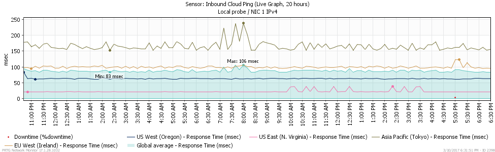

pir8radio 1313 Posted March 11, 2017 Posted March 11, 2017 (edited) I'm just chiming in because i have some data to show the difference, I couldn't find much of this info/graphs when I was first looking into these things, hope it helps. I would agree with the others, use cloudflare, they have a good system that may take different, shorter, or quicker paths than your direct internet connection would normally take.. Here is some data... These pings originate from different countries to my server, the first graph is ping times from the remote locations to my server in central US, the second graph is from the remote locations to my site running through cloudflare. Asia is the worst using a direct connection averaging 153-180ms, using cloudflare ping times average between 60-80ms. Invest in a .com, but if your ip address changes you may still require a DDNS, actually if you use cloudflare you can download an updater that will auto update your cloudflare IP so Cloudflare acts as your ddns host as well, but you still need a .something NO CLOUDFLARE: CLOUDFLARE: Edited March 11, 2017 by pir8radio 1
